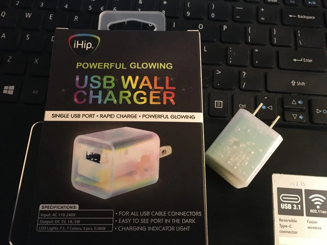

I just ordered some (4) of these to plug into an LED 110v USB charger. The charger has LED lights and I'll plug the little USB light into it.....just hope it's enough to kill the ASS. I'm pretty sure you need to use the 110 outlet to affect the ASS, not the USB slots

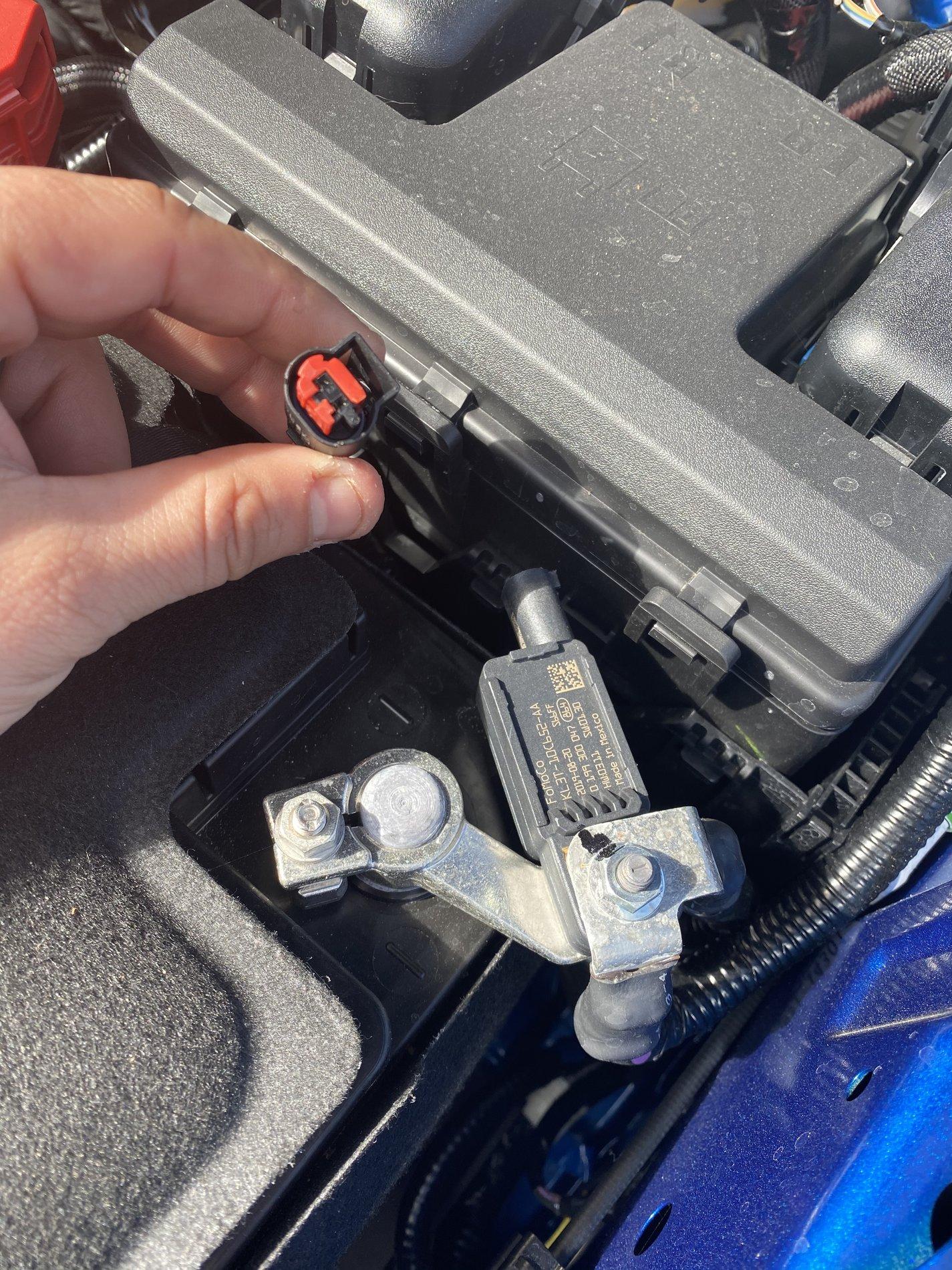

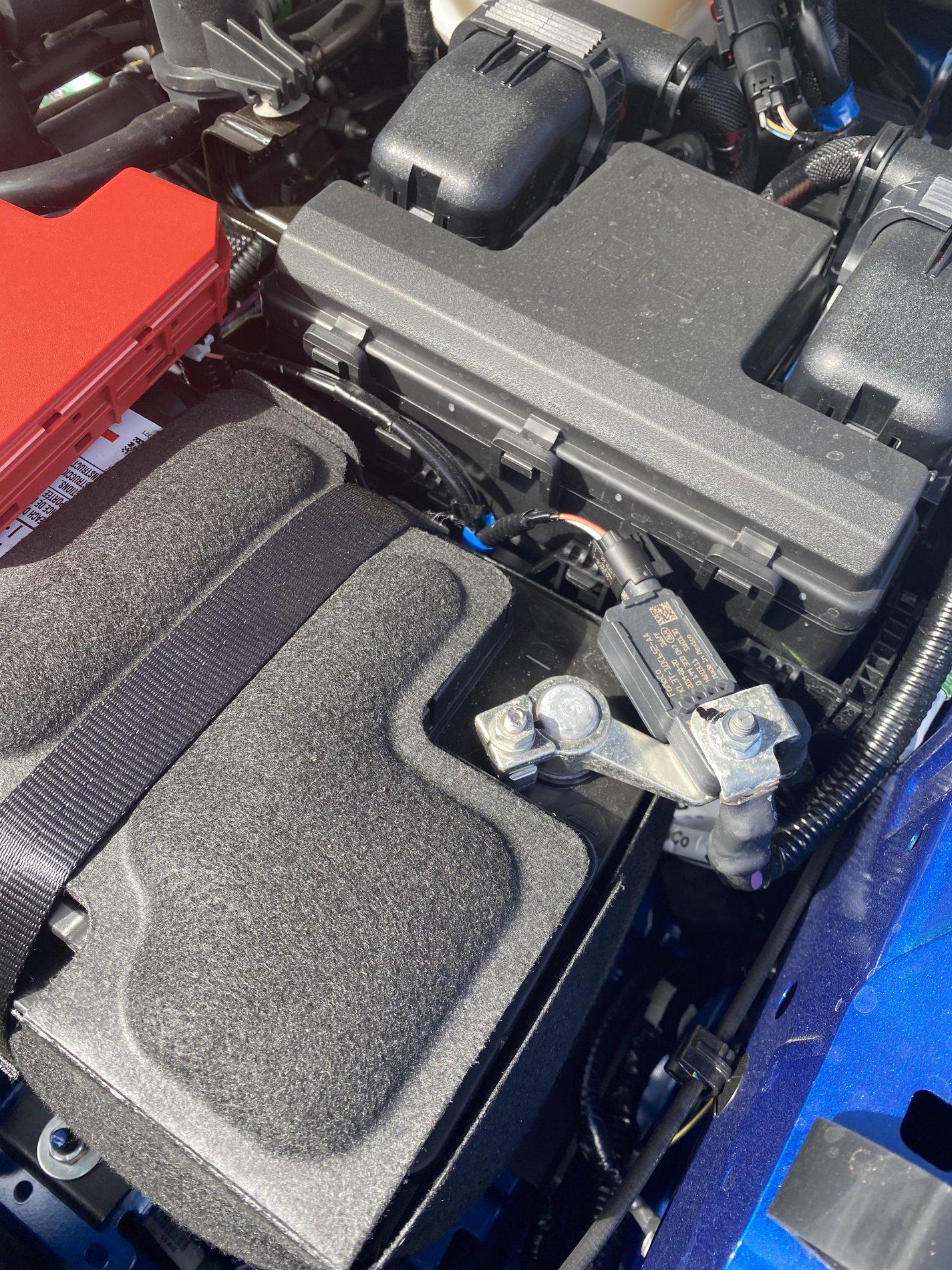

You can disable it by unplugging the dongle plugged into the battery will not throw a CEL

I tried a USB charger with a single LED and it wasn't enough.
Had a fairly dim LED nightlight laying around that seems to be doing the trick. I covered the surface with electrical tape and left a very small area open so I can see it's on.

Wait, if we unplug that, it'll disable ASS? What else does that plug do?
Disables Battery Management system meaning your alternator will basically function like an old school system engaged full time keeping voltage up. This is how it was explained to me by one of our techs. I mean it is up to you to do it. I ran my F150 like this for a year before I got a SCT Tuner.

I did this on Friday and it works like a charm !!!
