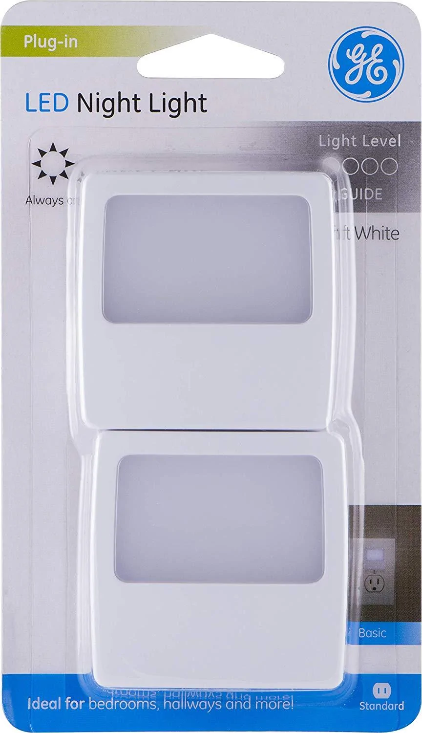

If you have an AC plug in the back (my 21 XLT does not).. a night light is an option. Especially if you are afraid of the dark.

The night light plugged in the back seat outlet is an awfully simple solution.
