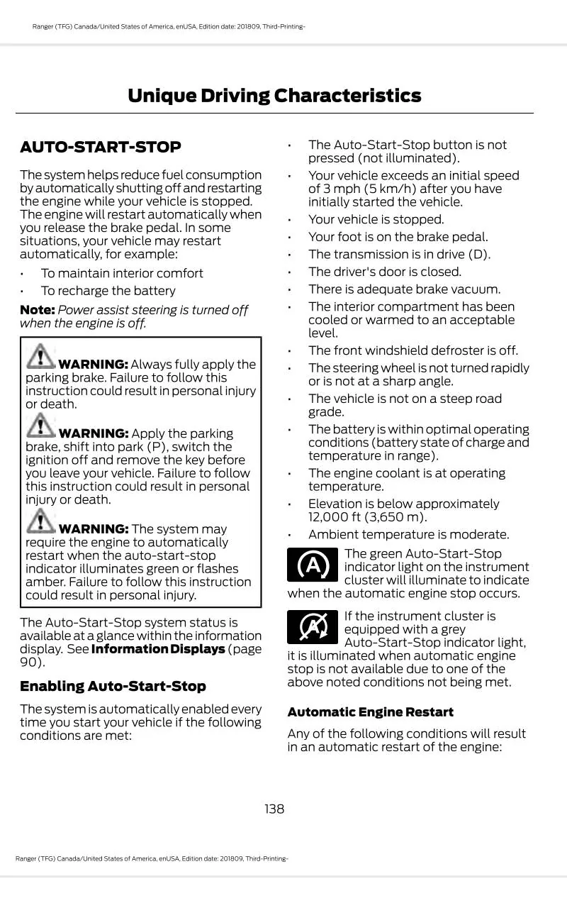

Well ... the mystery is solved.
Apparently, about a week ago I turned the defroster on ... :blush: ... I think it is the only time I have taken the climate control system out of auto. We normally are in the 15-25% humidity range.The day I turned the defroster on it was rain really hard for about four hours ....AB Normal for around here. Anyway, I had a PT appointment with the VA, so I did the run to the truck thing. The windshield was fogged pretty good, so I found the button and turned on the defrost. I guess I assumed it would go back to auto. (I mean really, I'm a big enough boy to be able to "lock" the defroster on, but apparently not sharp enough to decide if
I want start/stop activated?????)
Sorry, rant over, we now return to our regularly scheduled programing.
So I did some testing, the stop start now works like it should. Darnit.
So, I am now knee deep in the "getting to know" Forscan and the OBD lint thing. I have successfully gotten ForScan loaded on my older Windows 10 "confussor" and gotten the drivers for the link thing loaded. I now just need to figure out to modify things on the truck. All I really want is to turn off the Start Stop thing and the Double honk thing.
