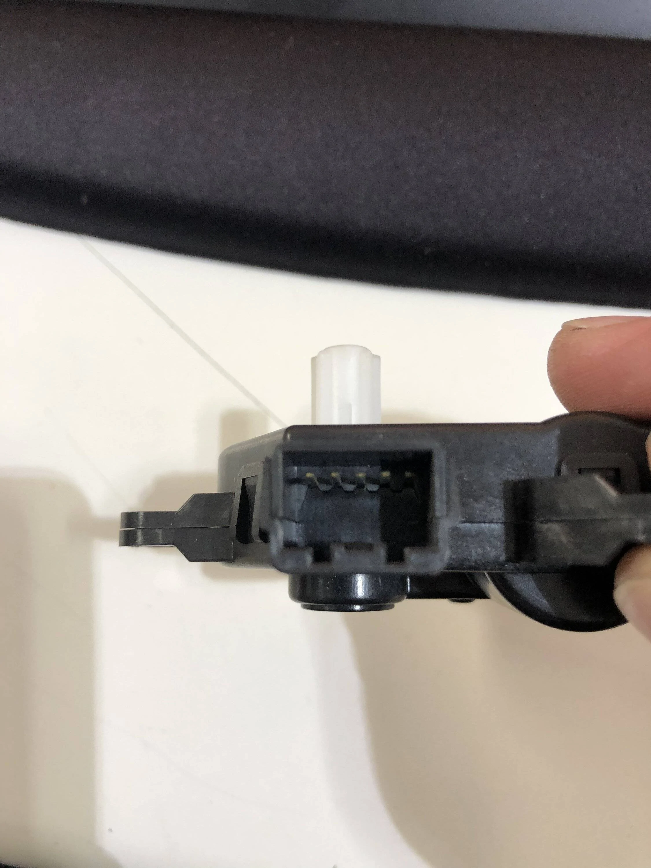

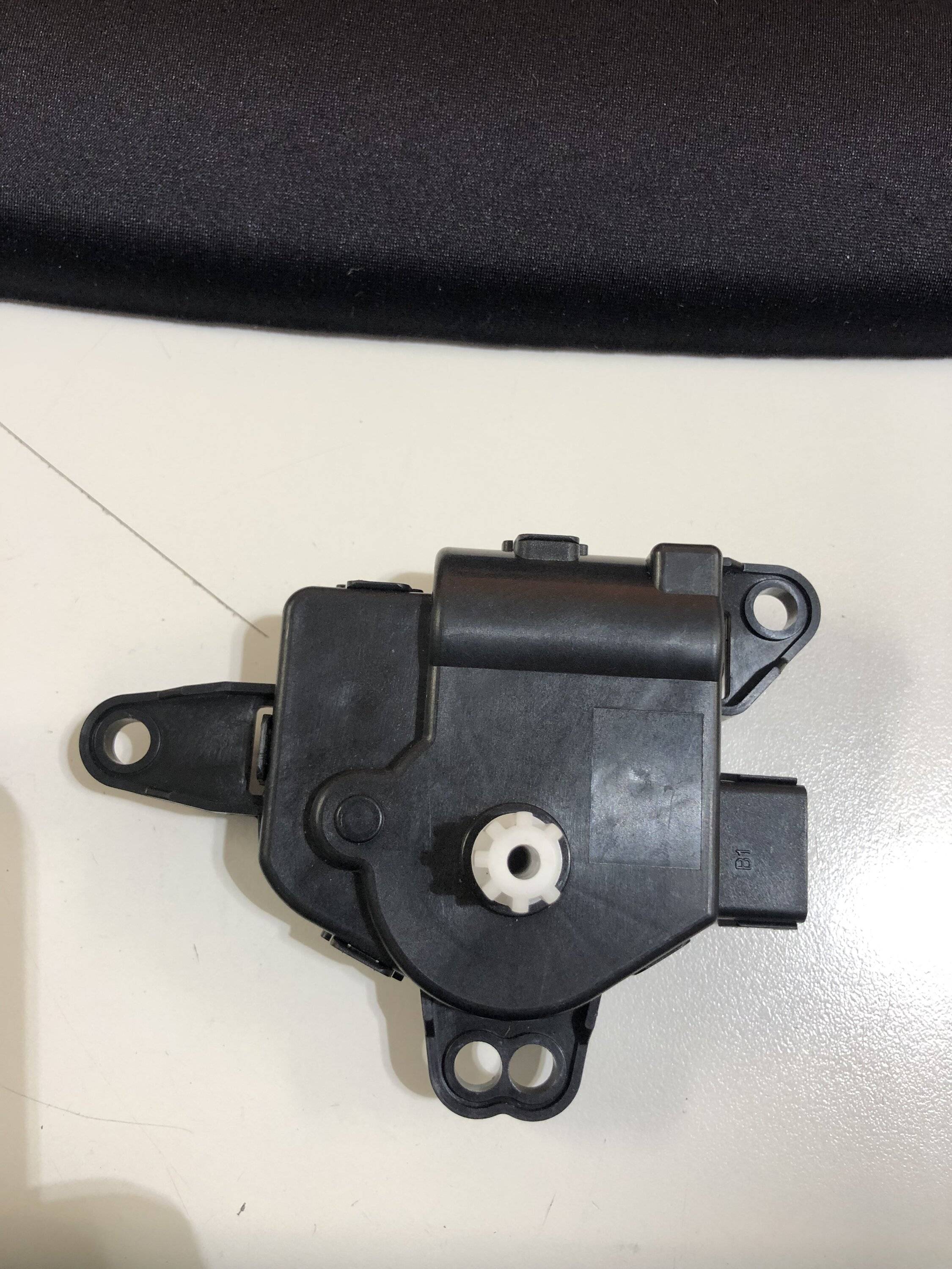

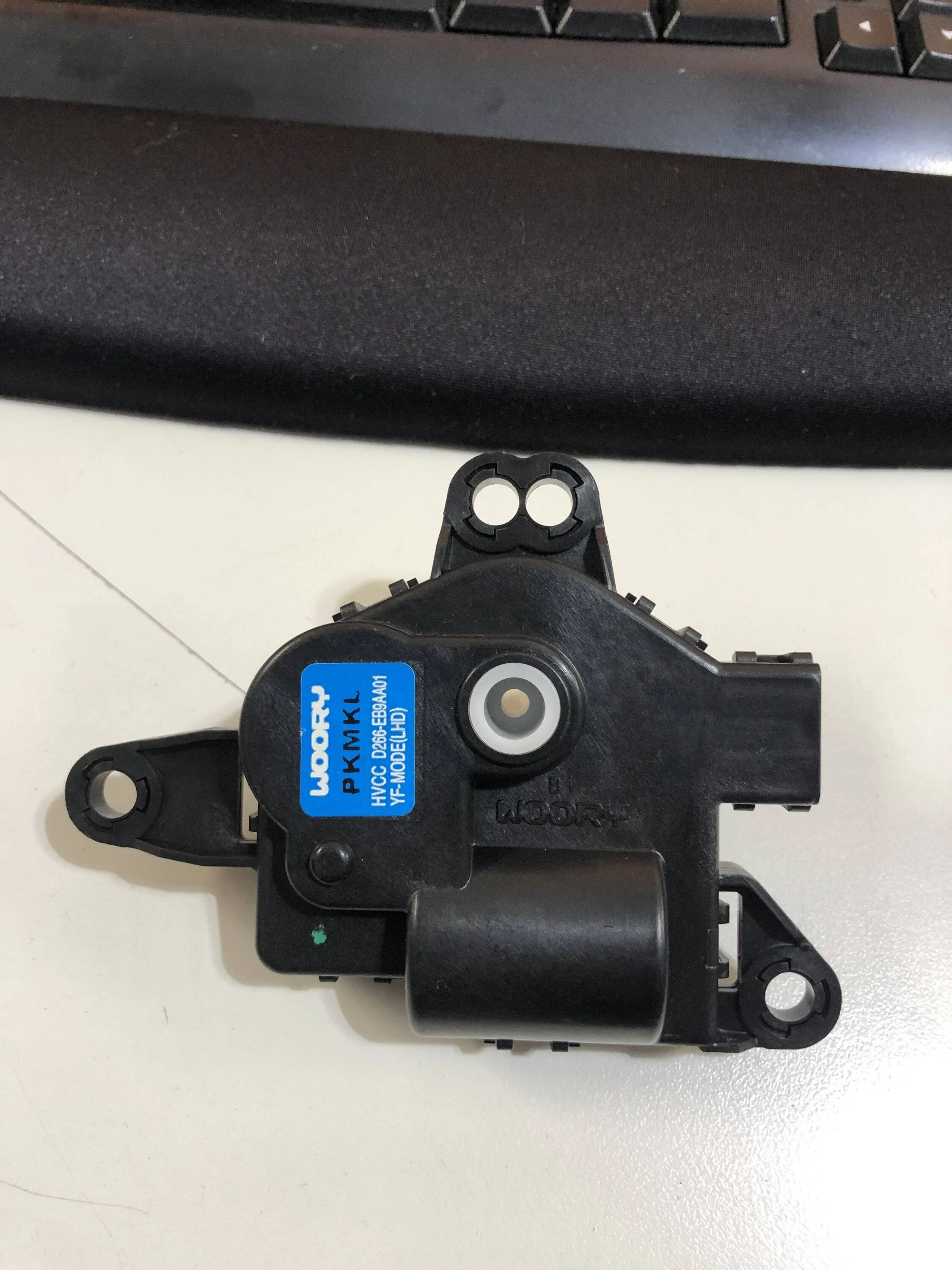

I ended up finding this one at my work, before I buy it can anyone confirm this is the proper actuator, it looks very similar to the one in the YouTube video. Both are "Mode" actuators, @dmeyer302
CO2Ranger
Apr 27, 2020
34
1,097
2,104
My understanding after reading the thread here is that they swap out the whole assembly because there's something warped or a defect in the design that causes the door to catch. Swapping out just the actuator might lead you right back to where you are today.

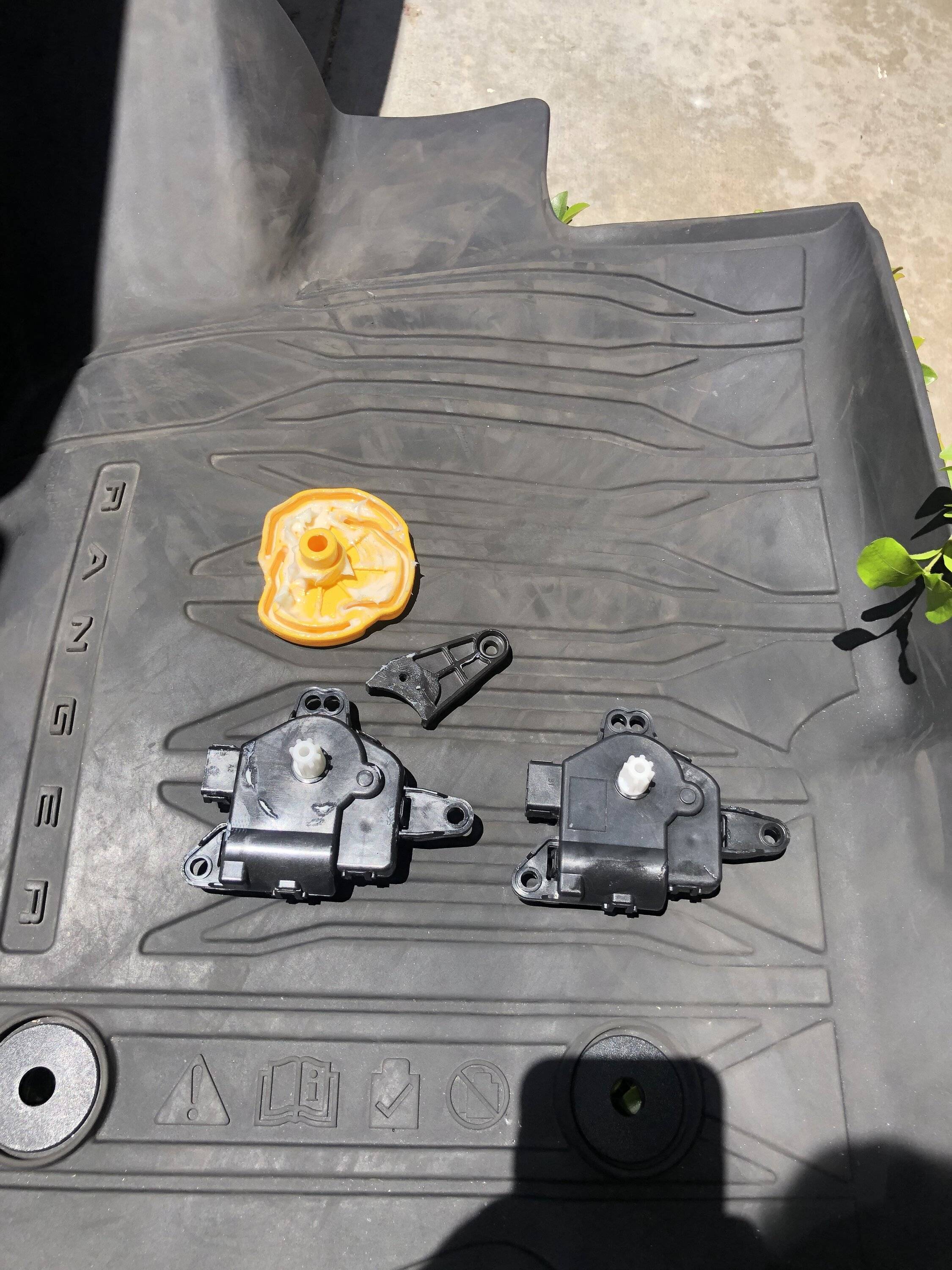

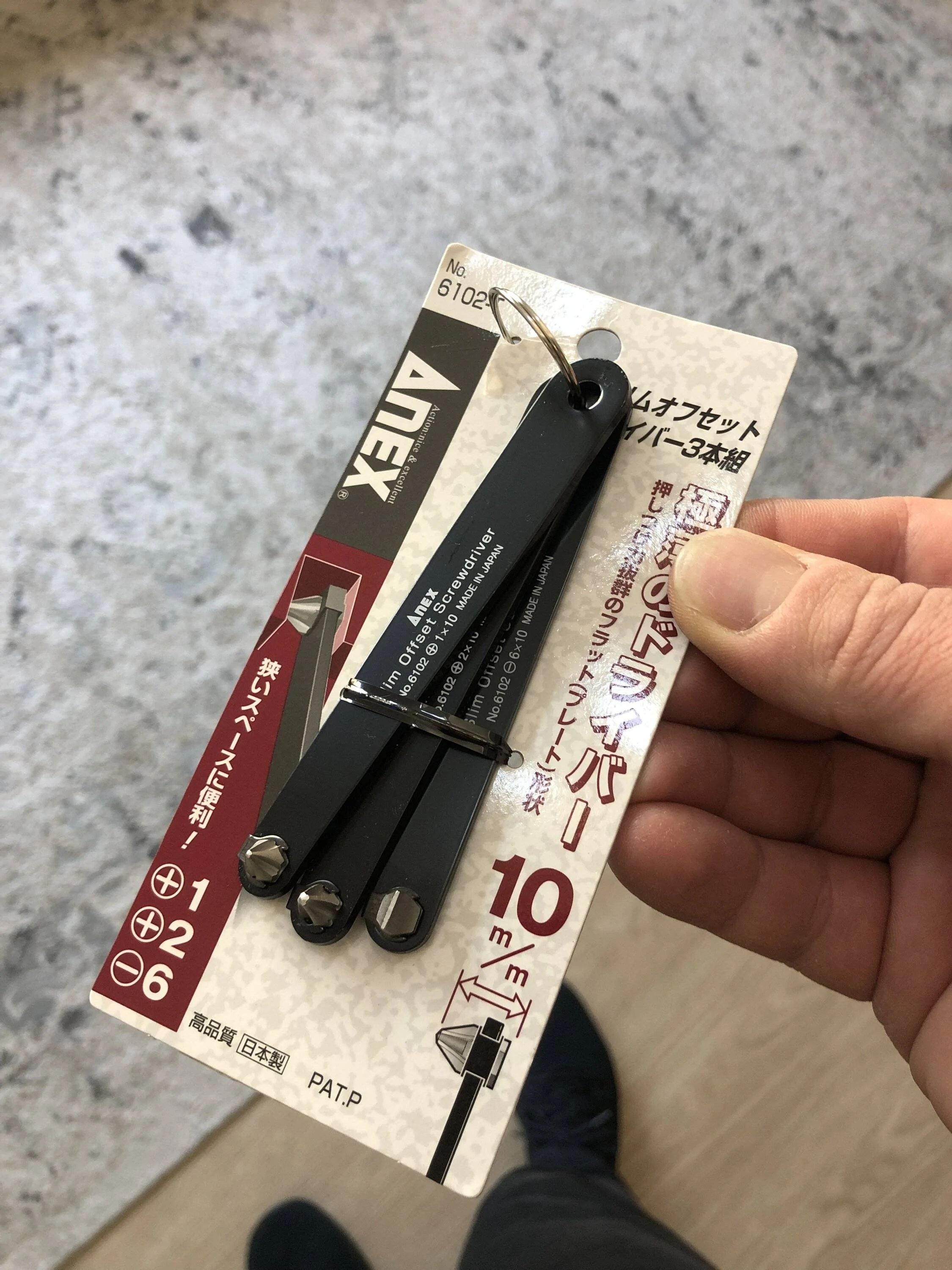

Little update for anyone with this noise that’s following. I went to Ford they said the noises are normal from the actuators and my Vin didn’t fall within the build date for a warranty hvac case.
I went and got the mode actuator I replaced it myself, the is noise gone! I didn’t need to drill the dash frame support like the YouTube video though. To remove that last screw I used a set of ultra low pro Japanese screwdrivers found on eBay. Saved the dash pull ? if the noise returns I’ll post again.
