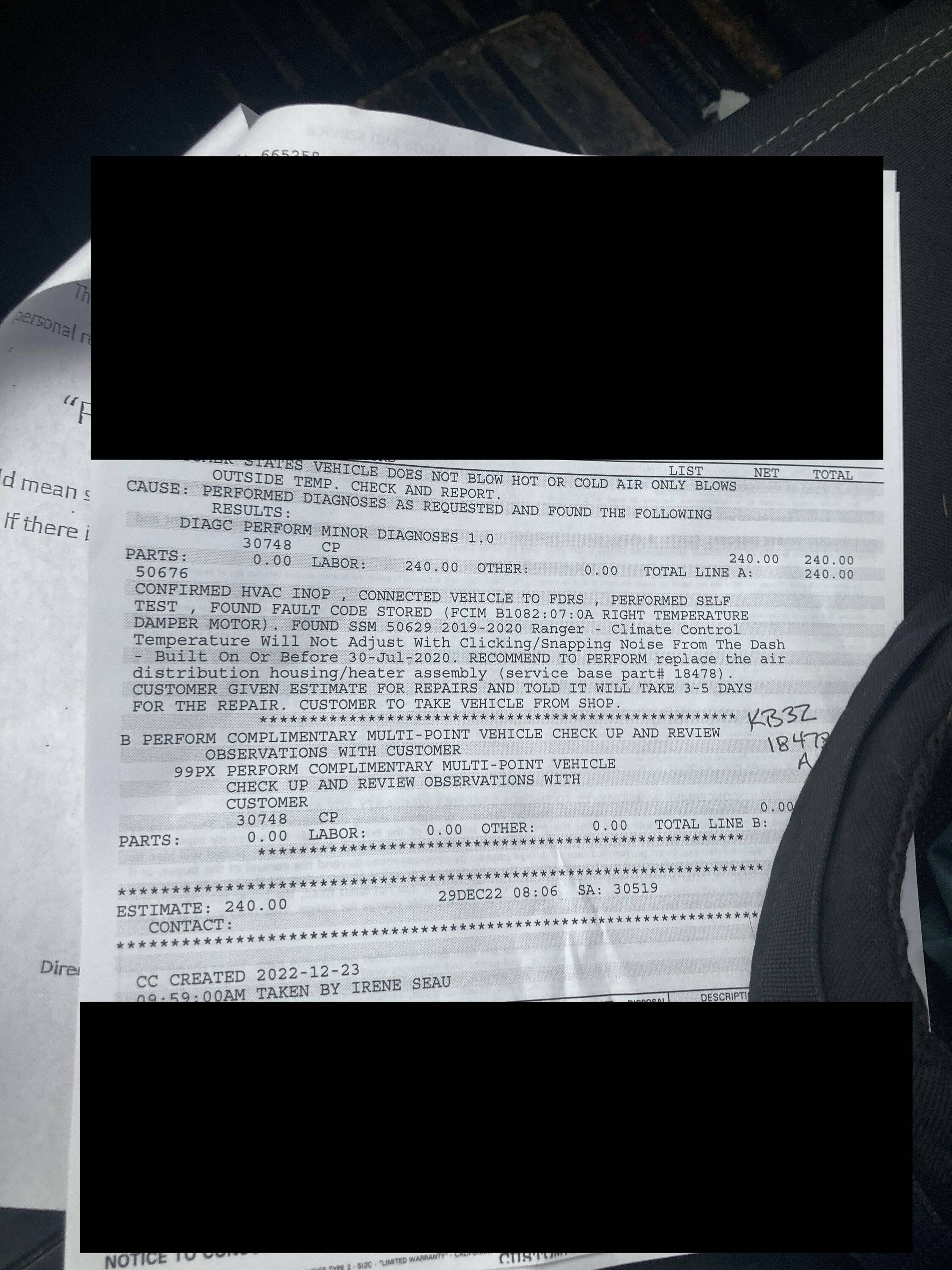

Sorry to hear about your scenario....but the information you were quoted for repair is correct....Parts are probably in the range of $600 to $700 (+ any applicable taxes) and the rest is labor probably 10 to 12 hours...a day and a half to 2 days
The entire dash, steering wheel, console does get removed to get access to the HVAC assembly.

Thanks for this. A few updates: I did indeed reach out to Ford directly (via their little chat widget on their website) and the person I spoke with indicated it may be covered under the 70k Emissions warranty for the state of California. Of course, my mechanic made no allusions to doing such a repair, so I'm left to reach back out and play a game of he said she said.
Also weirdly enough, the heat started working again out of nowhere and I was able to replicate the popping noise when I set the head to the lower (feet area) blower. It sounds primarily on the passenger side (which is what other people on this thread have reported). I know it will stop working again, but I am encouraged by some of the comments about not necessarily needing to replace the entire blower unit (Part# 18478). Hopefully more to come

I am jealous of the folks getting in and out of the shops so quickly. I scheduled my appointment at the beginning of November and I don't actually get to the service center until this week! I had to literally put on my sled gear just to drive to the stores and back during the -30F degree cold snap. I have a -15degree bag and three thick blankets laying in the back seat in case anything else decides to break down before the appointment.
I called the shop ahead of time to check if they even had the part beforehand, but haven't heard back. Unfortunately I didn't pay close enough attention to the TSB and misread the part number, but I would assume they wouldn't even take my word anyway. They probably want to feel the cold air, play with the knobs, and hear the clicking for themselves.
I was also going to finally use points and get the Ford-works-whatever-service while I was at it. But I had to cancel that portion of service because the Ford points literally expired last week.
Anyway, hopefully I can finish out the last half of winter with a working heater!
