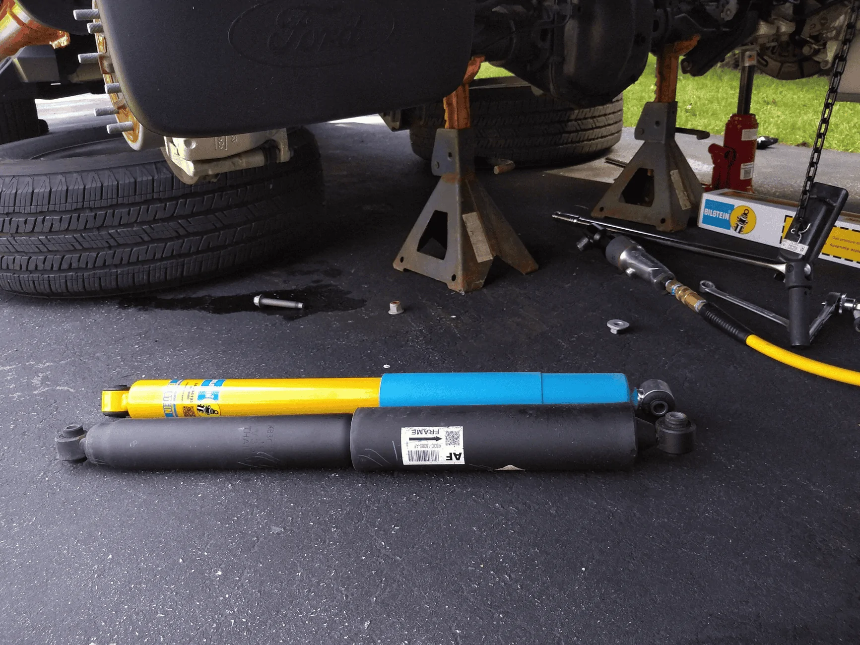

You can do something for under $200. BUT ... it also greatly depends on your needs.
For me, this mod made a noticeable difference: https://www.ranger5g.com/forum/threads/what-did-you-do-to-your-ranger-today.3511/post-601633

I used Eibachs, but more or less the same thing. But, for me, it was to tame some of the bouncy bouncy on the roads, which the rears did for me. I can still feel the front bounce a bit, but I can live with it.
But, I'm not sure what OP is looking to do. Remove some of the stiffness? In what way. I have a feeling it's not gonna be what he wants, but, I don't know what he wants :)
In the long run, it's a truck and it's probably still going to ride, more or less, like a truck no matter what is done.

The Eibach or Bilstein shocks on the rear solve a lot of the bouncing with the stock suspension. The stock shocks are weak an the truck keeps rocking after hitting a bump. The aftermarket shocks are better an control the motion better. Dollar for dollar the best upgrade I made to my ranger. The Livernois tune was the second.
Keep an eye out for some Ranger Tremor rear springs in the classifieds. They ride nicer an pop up now an then when someone upgrades for serious off road capability.

He 'said' it was a good upgrade because he has no idea of how the suspension in the truck is designed to work.
Do yourself a favor and steer away from the 'cheap' rubber bump stops, that is not how our suspension is designed to work. It is designed to work with a more compliant 'active' bumpstop, which those wheeler stops are not.
