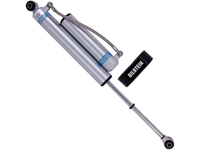

Guys, I put the Ford/Fox kit on, which vastly improved the street ride, but now I am wondering if I could make it even better by adding a pair of Bilstein shocks to the rear. Here is the shock I am looking at (from the American Trucks website). I would want to leave the foxes in the front but replace those in the back with these without significantly lifting the rear. Has anybody done this? Would it make a noticeable difference in the ride? Would it wreak havoc with vehicle dynamics, void my warranty, or something equally awful that I have not thought of yet?
Bilstein B8 5160 Series Rear Shock for 0 to 2-Inch Lift(19-21 Ranger)
