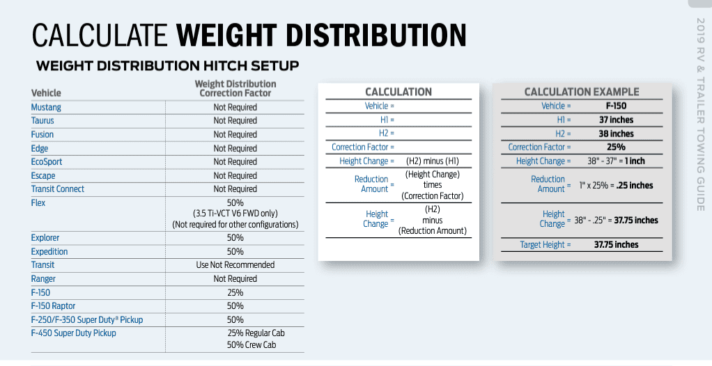

The only real place the frontal area affects is fuel mileage. The side area is what really affects handleing. Thats where winds and traffic affect you the most. As a side note, frontal area is the total area expose to a direct head wind. So, it just take the high of your trailer from the ground including ac and multiply by the width. Not even a Rpod falls under the 55 sqr ft number. Travel trailets are big bricks being pulled through the air. 60 to 65 seems to be the sweet spot between mileage and not getting run over or causing road rage on the freeway. Over that and you milage goes south exponentually. Weight doesn’t seem to make a big difference as long as you within the ratings.
DISCLAIMER ON PREVIOUS POST:
I never intended to say a WDH is required for the Ranger to pull it's full rated weight. The intent of my post was that when towing a TT it will make for a much more enjoyable and less stressful experience. Yes, the weight of the hitch does add to the tongue weight the truck sees and is addition to the 10-15 percent of trailer weight. But, it does allow distributing that weight on the truck for better handling, something air bags do not.
The OPs bad experience is obviously due to an improperly sized and setup hitch and possibly an improperly balanced trailer.

Ford describes it differently and identifies it as the vehicle and trailer.
What is so different about this than what I said? It also says the the chart shows the maximum TRAILER FRONTAL AREA,which is what the calculation I gave is.
Ford also states that a WD hitch is not required.
I am sure it can assist you in certain circumstances, but they say you can tow the max amount without needing one.
I never said a WDH was REQUIRED to tow the maximums. Only that in my opinion it will give you a better towing experience. You are always able to do what ever you want.

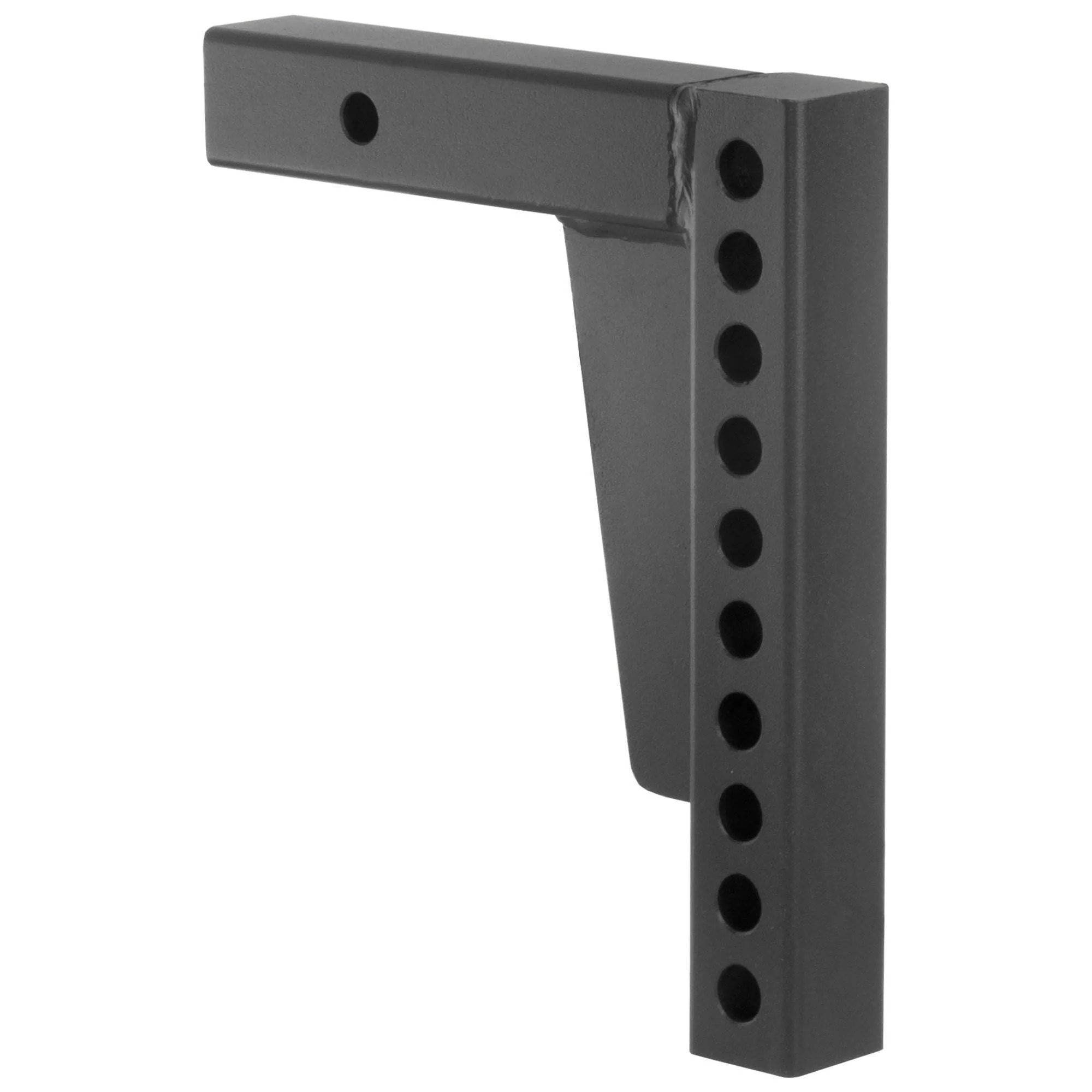

This is begining to make more sense. The dealer did not do you any favors with this hitch setup. One of the worst things you can do is tow with the trailer high in the front. You need a hitch bars with more drop. Not uncommon with Rangers high rear end. The trailer should be level or slightly nose low when towing. Yes you may need to remove washers to adjust the bar angles, but first you need to get the hitch hight correct. I still think you will be better off with the 6000 pound bars also, for your weights. Get the hitch manual and go through the setup procedure set by step. You should be able to get the bars on the step brackets easily by using the tongue jack to lift the back of the truck with the trailer coupled.
6,058
30,254
As Big Blue posted, your hitch sounds like it needs to come down. The hitch shank you got with your set up probably has 6 holes like the one pictured. Sounds like you need a longer one to drop the ball, maybe a 9 or 10 hole as pictured.
And like Blue, I still think the 8000 bars are too stiff.

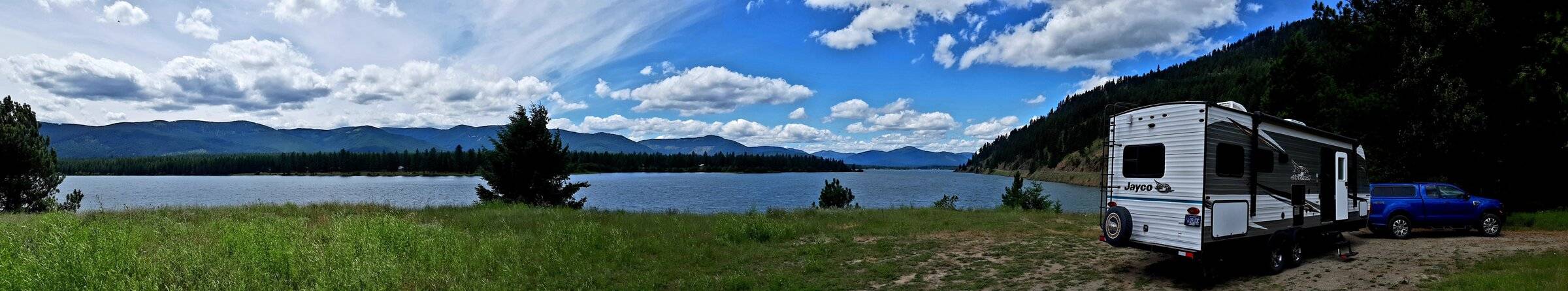

Every time a truck passed us, it saved like we were getting sucked into his lane, and the rear of the truck seemed to randomly dart around. It didn't bounce around, which was good.
That's just the nature of the beast with a travel trailer getting pushed by the air pressure from a big rig passing you. It's probably a bit worse with a single axle vs double axle trailer. It startled me too the first few times it happened. I am now in the habit of checking the rear-view mirror every so many seconds or so to prevent being surprised.
We have a '19 Lariat 4x4 towing a 24' Jayco around 6,500 loaded. Have the E2 with 8,000 bars. It's set up so everything is level. The only thing that scares me is getting passed by big vehicles while on curves going downhill.
