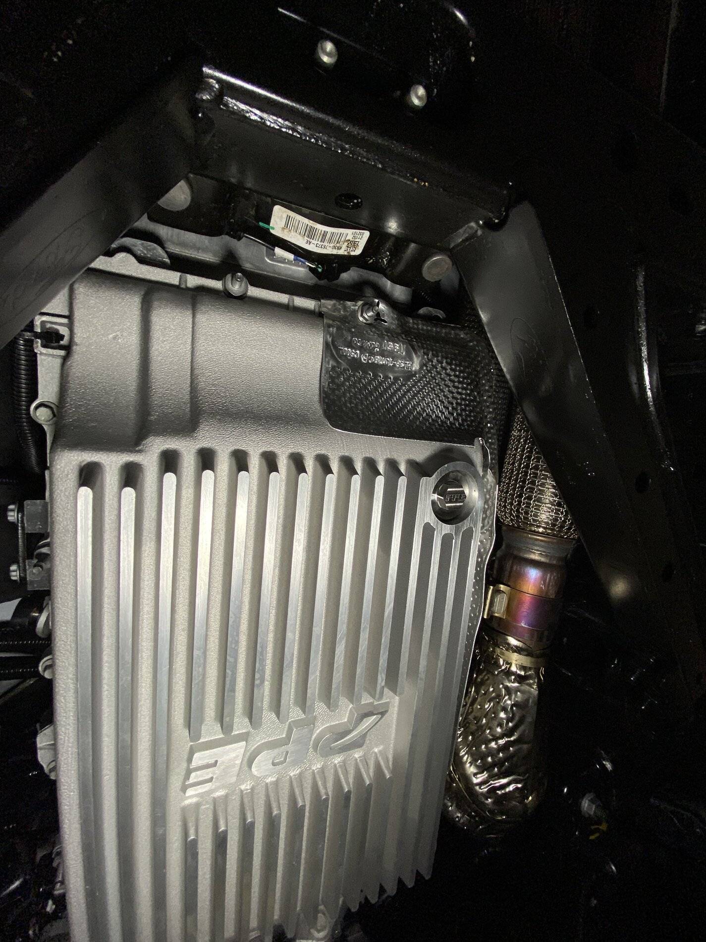

Yes, I did that about a month ago. I replaced the factory plastic pan with a PPE aluminum finned pan as well as replaced the transmission filter. I was surprised at how dirty it looked with only 2k moles on it. The pan has a plug in the side for a temp sensor so I added a trans temp gauge from Maxtow gauges. It’s nice to know the actual temp in real time. You are right about the temps it rarely reaches 170 degrees.

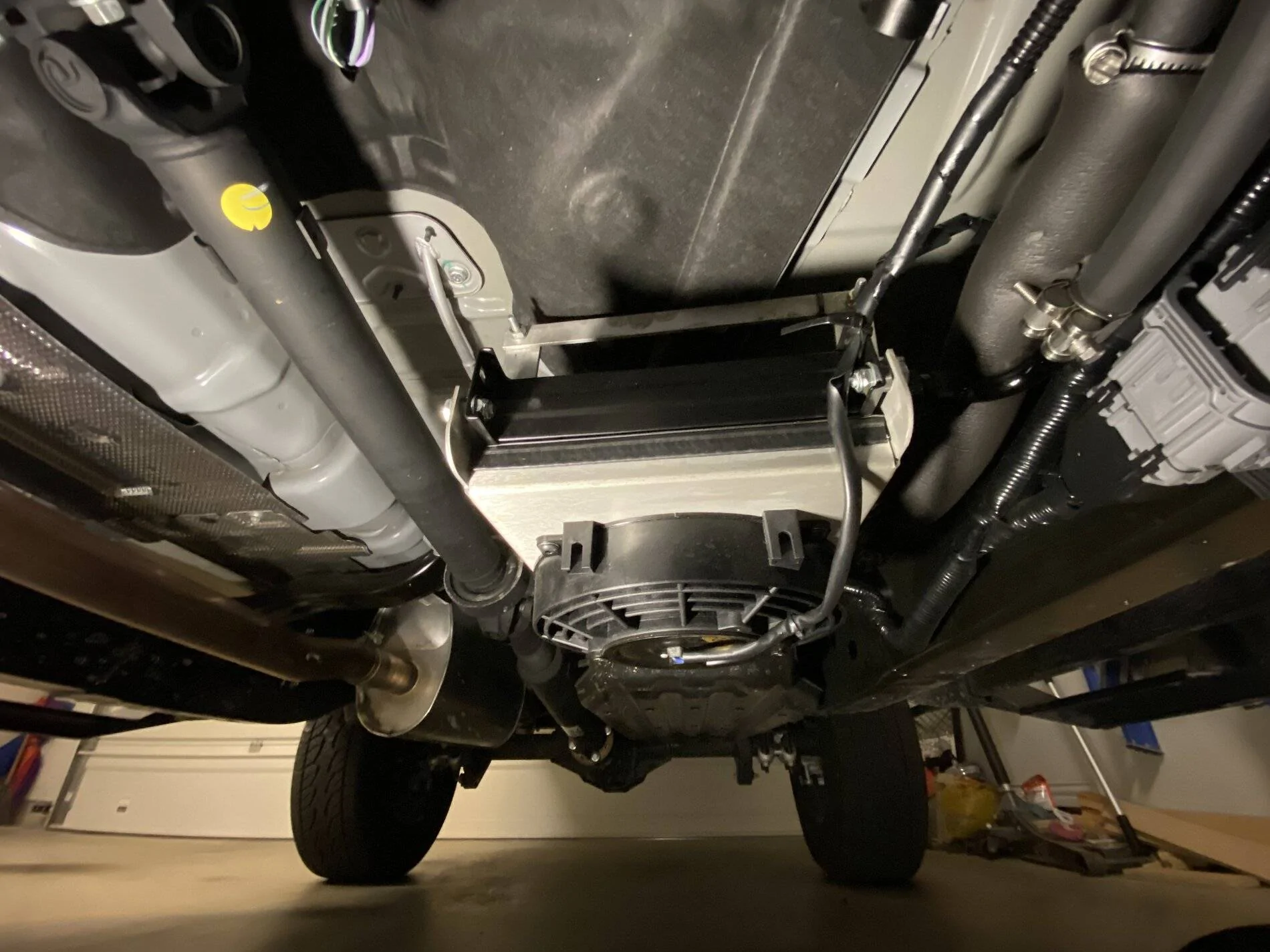

I have already installed the "Factory" accessory trailer brake controller and plan on towing a small RV camper next summer (under 6000 lbs.). But, before I tow anything I am going to upgrade the rear shocks, and add a set of Timbren SES rear bump stop spring helpers. Then finally the Hellwig rear sway bar kit just for some added stability. I have already upgraded the factory tiny box transmission cooler to a remote located Derale cooler with an inline thermostat and cooling fan.
You do realize the the "factory box" cooler is intended to help the transmission "heat" up. It uses engine coolant to do this.. The 10R80 is intended to run at 200-210 degrees. This is not your dad's automatic transmission.

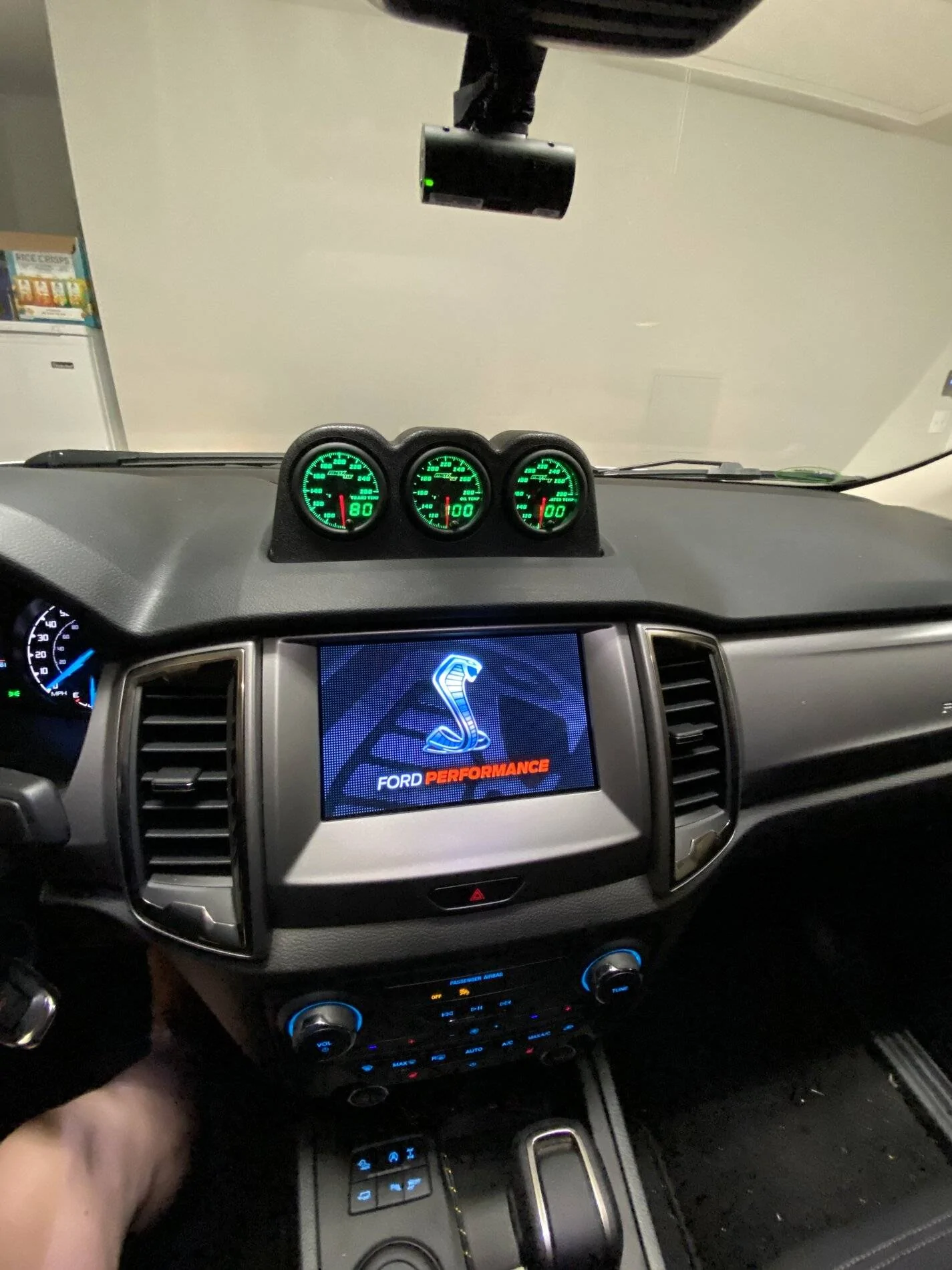

This is an awesome setup! Did you install and wire the gauges yourself? do you have any photos or possibly a resource you got the information on how to install it by chance? How muhc was the gauge cluster if you dont mind me asking? I want to something very similar. Looks great! i want to install a boost gauge as well as trans temp as well.

I fabricated the base and trimmed down the gauge pod side. They the gauge pod and gauges are from Maxtow made by Glowshift gauges. I have the trans temp, the oil temp, and coolant temp. The Maxtow series is mainly for Diesels so they didn't have a specific set. I had to purchase them individually. I think all three with the pod is under $300 with tax. I removed the tray that sits on the dash and fabricated a 3/4 thick plywood base and covered it with black felt. The Maxtow/ Glowshift company has some videos on Youtube. I should have taken more pictures but I had limited time off from work and threw it together one day. I tried to find something similar to what the Tremor Auxillary switch panel looked like but couldn't fin anything.

Yes I realize the optimal operating temp. I have an inline trans fluid thermostat that limits the flow until it reaches a specified temp. Do to my OCD, I wanted something that was a little overkill just in case I am towing through Houston TX and its 113 degrees with 85% humidty and bumper to bumper traffic. I also appreciated the 210 degree fluid temp when you have to add or check the fluid while its running when the dipstick is literally 3 to 4 inches from the Catalytic converter. I do appreciate the comment though. I am not an expert and take any opportunity to get a different viewpoint or learn something.

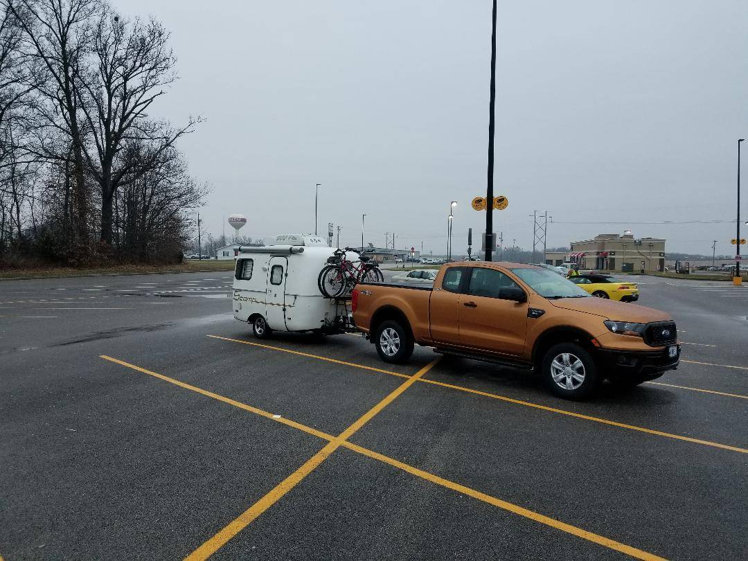

Just picked up my 2022 Intech Flyer Pursue. 1600lbs dry weight, tongue weigh about 200lbs
I drove from VT to KY to IL. the owing experience is horrible (stock equipment: only light bedding added). I'm towing with 2020 Ranger FX4 with tow package (7500lbs capacity) and every time I go over bumps or even slight undulations on highway it's bouncing so much that it feels like the car is misfiring (feels like a back and forth push-pull).
I've towed a Bantam T3-C (no shocks) for a year and that bounces all over the place, but I've never felt it in the truck (half the weight though). Hitch height is perfectly set, and I have a 2-inch WeighSafe ball hitch for the trailers 2-inch receiver.
Anyone got any ideas?
Thanks
Replace shocks in rear, maybe front also since the weight is shift/bouncing fore to aft. Start w/ rears. I have BDS lift Kit and BDS Rear shocks, less float / wallow. Folks like Fox and Bilstein for zero lift replacements. Rancho also makes upgrade shock RS55024.
