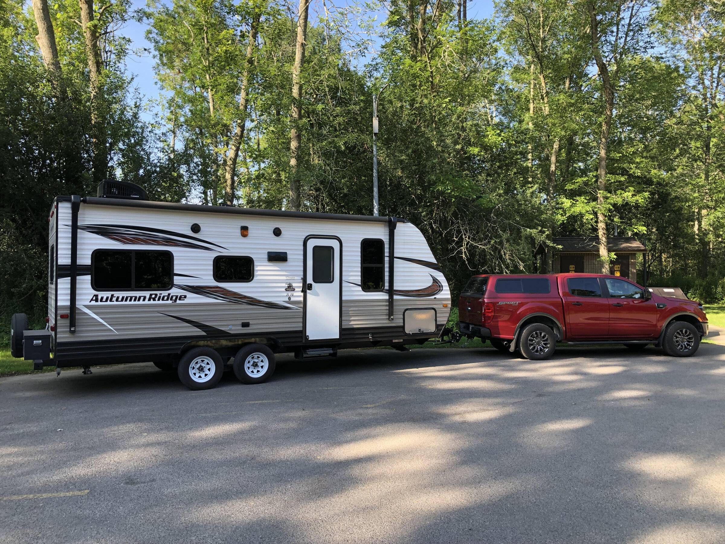

I have a 2020 Ranger XLT Sport and pull a 21 ft TT with tandem axles and loaded weight of 6000 lbs.
My first trip out I was all over the road due to a bad dealer set up. Re-set it myself per the Husky WDH instructions and it made a big difference. Get the instructions and follow them to do your set up. Watch trailer loading, keep 15% of trailer weight on the tongue. Run tires at marked air pressure and use a sway control. I did a 6000 km trip last summer with this set up and no issues.

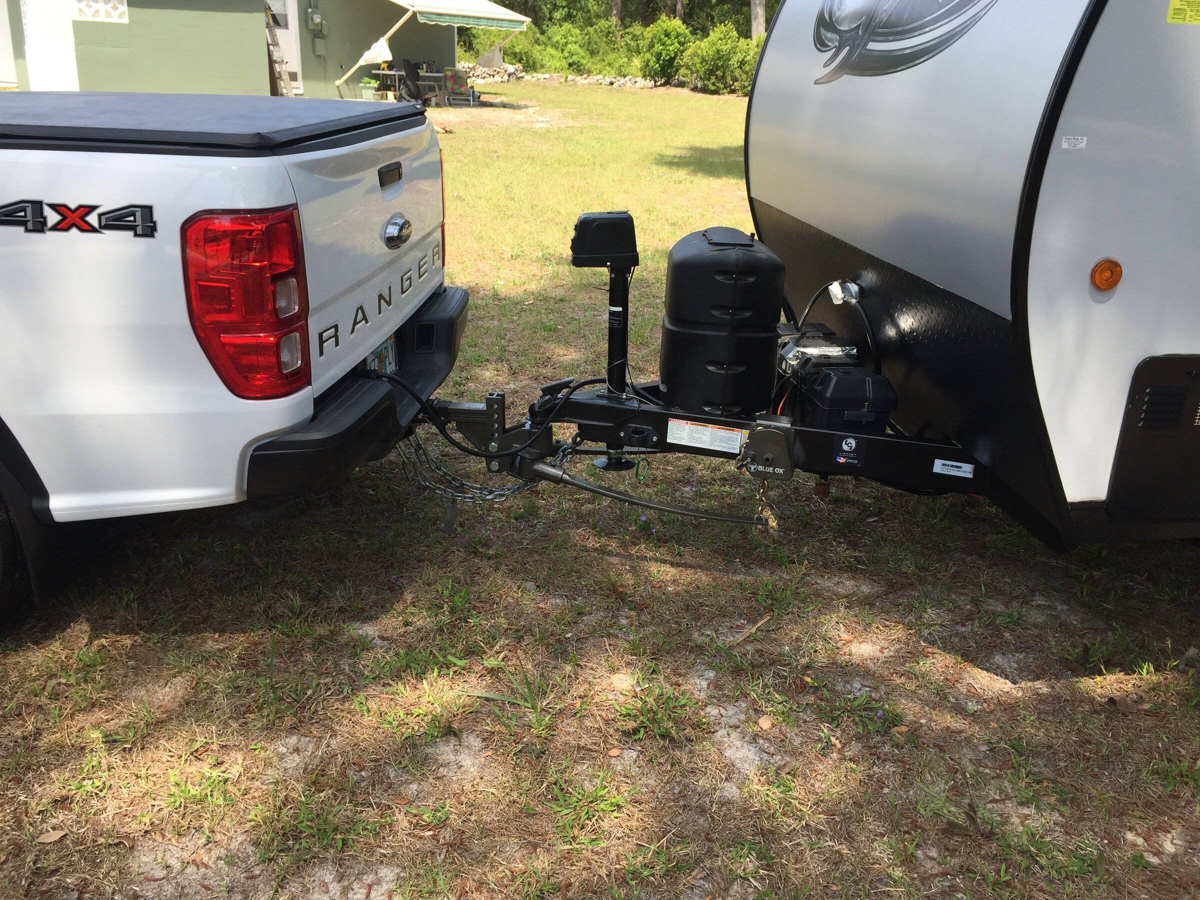

I bought a Wolf Pup 16HE Saturday. It weights 3500ish empty with 420 TW according to FOREST River.
The dealer installed a E2 WDH, with 8000 lb bars for some reason, and lowered the L brackets down all the way.
Left there and went straight to the campground. Every time a truck passed us, it saved like we were getting sucked into his lane, and the rear of the truck seemed to randomly dart around. It didn't bounce around, which was good.
I have a 2021 FX2, and I didn't pump the tires up any, I did when we left coming home. It helped some but not alot.
I am thinking that I need to look at the WDH adjustment to see if it's way off.
Or is this just how towing a single axle trailer with the Ranger will always be?

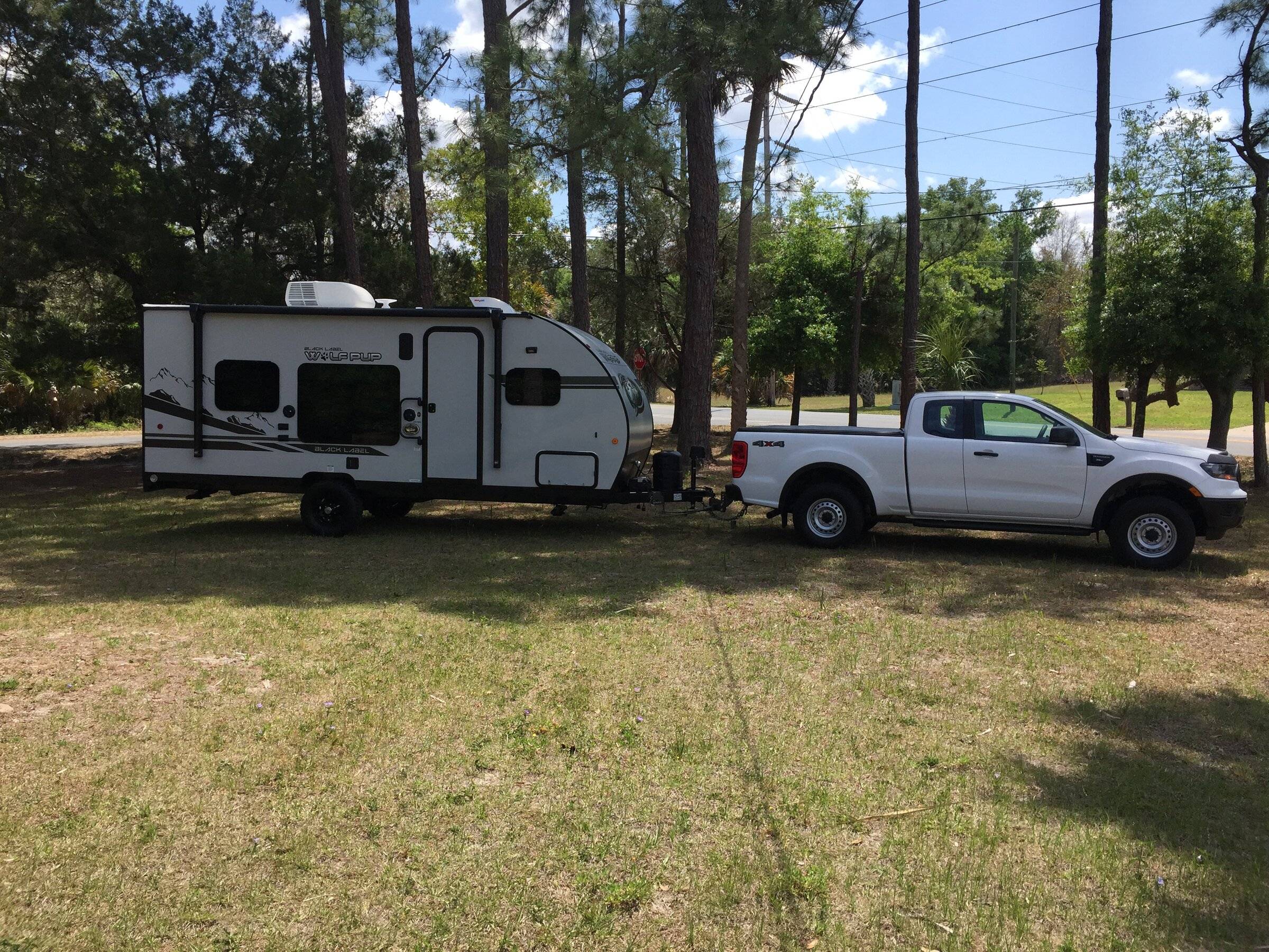

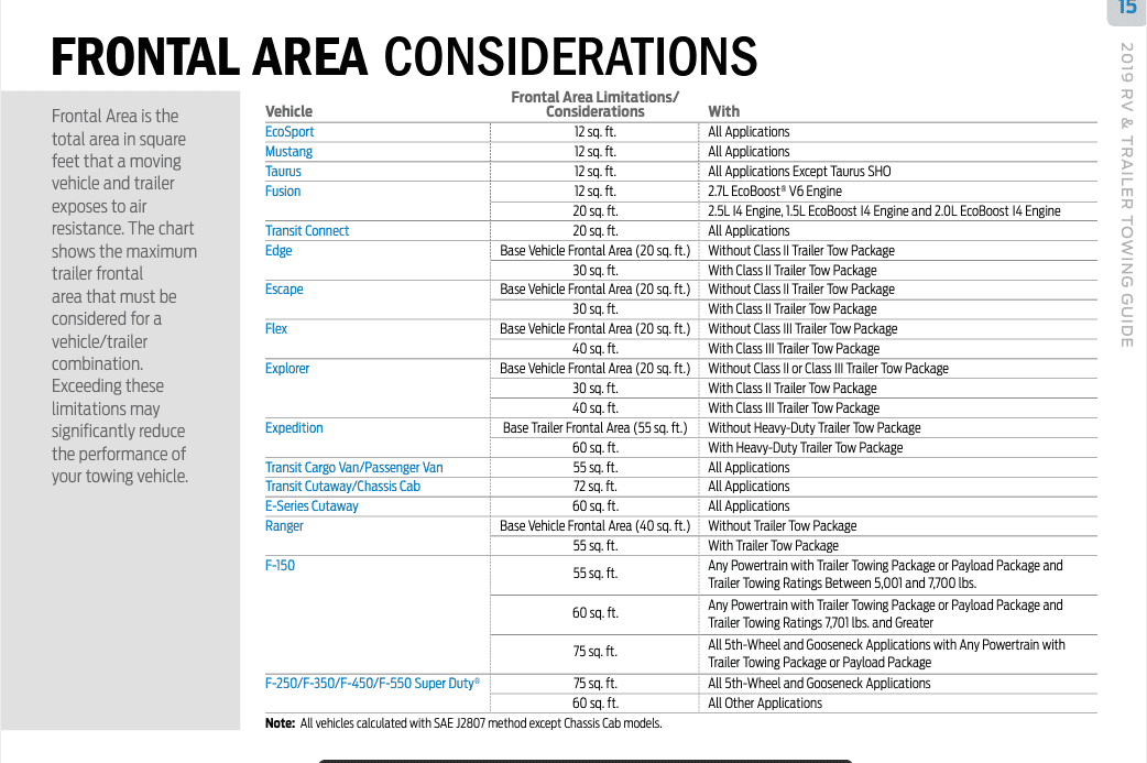

you obviously have a large frontal area, not sure where it lays on the recommended 55sqft
how much did your fuel mileage suffer pulling that giant block?
Everyone seems to be fixated on the magic "55 sq feet" frontal area, but in reality most travel trailers are between 7 ft on the smaller units to 8 feet wide on the larger units, and most will be between 7 and 8 feet or higher.
Pretty much any of the 20-30 foot units will be around 60-80 sq ft of area.
It just comes back to common sense towing, experience of the driver, and being a safe driver while towing.
Rig we are buying is easily 8 feet wide and almost 10 feet tall, so I've busted the "55".

I'm not expert by any means but it seems like your WDH isn't adjusted correctly. That and a single axle trailer will sway more then a double but it should be more stable than it is now. Steve @Grumpaw knows a lot more about these and will hopefully see this and give you more advice.
One thing to keep in mind is when you go to adjuest the E2 hitch, you need to buy all new nuts, and maybe bolts, EVERY TIME. Through the adjustment process I tried reusing one, once on a few mile test run. The nylon locknut siezed up and was a real bitch to get back off. Took a 5' breaker bar extention and about an hour for both nuts.
