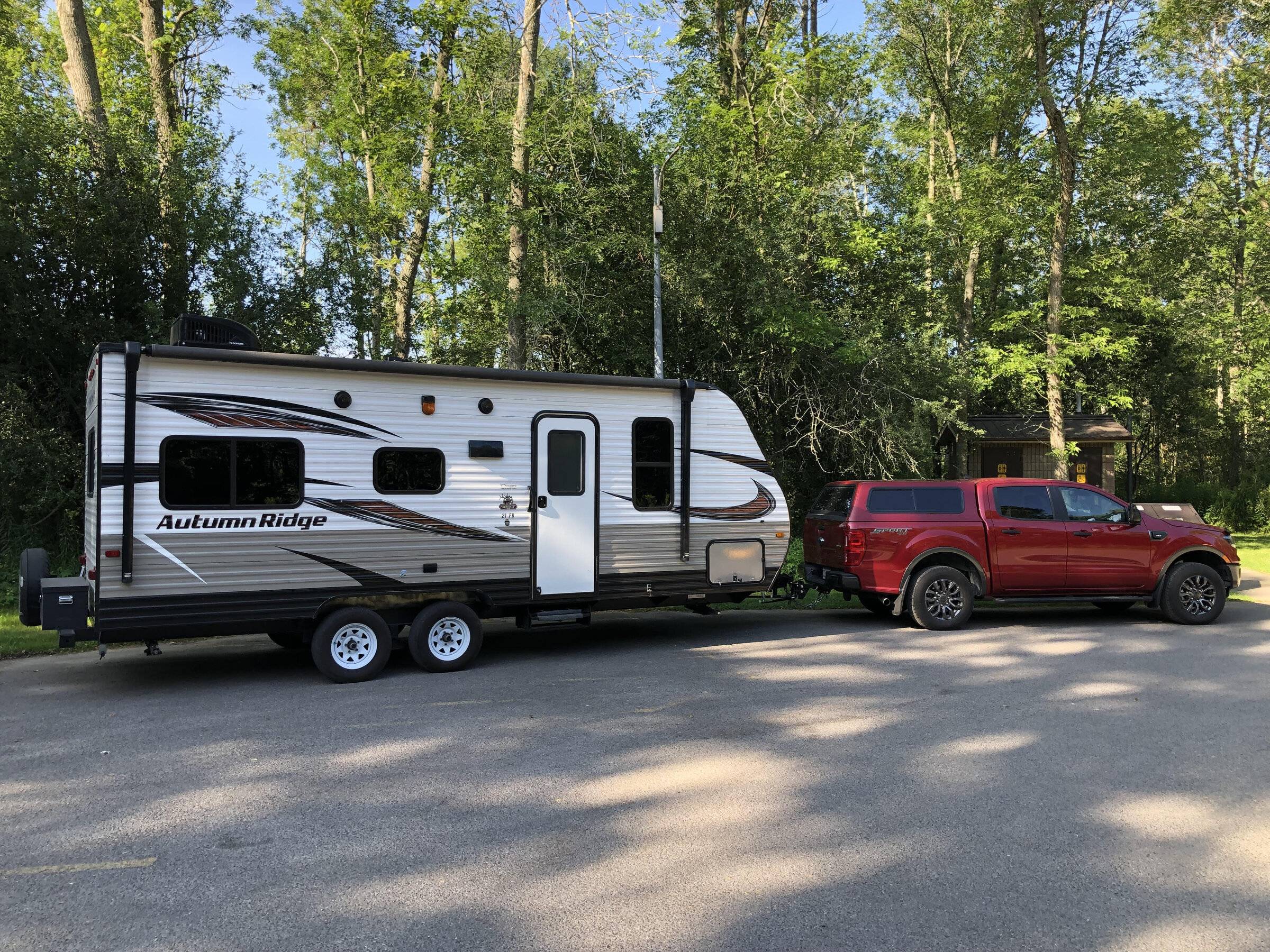

The 55 sq ft frontal area is not realistic with my trailer, or most trailers. That said, the Ranger can still pull it. Does it slow me down in a head wind - for sure it does. Days when it is really windy, I stick to secondary highways and that helps with the lower speeds. I do need to get to the campground but do not need to be the first one there. Ha Ha
I have over 30,000 miles on my Ranger and it has preformed well above expectations as a trailer tow vehicle. There is lots of information on this site. Do the
research and make sure your set up is safe and have fun towing.

I have a 2020 Ranger XLT Sport and pull a 21 ft TT with tandem axles and loaded weight of 6000 lbs.
My first trip out I was all over the road due to a bad dealer set up. Re-set it myself per the Husky WDH instructions and it made a big difference. Get the instructions and follow them to do your set up. Watch trailer loading, keep 15% of trailer weight on the tongue. Run tires at marked air pressure and use a sway control. I did a 6000 km trip last summer with this set up and no issues.

My weight may be a bit misleading. With 42 years in the trucking industry, loading a trailer correctly is sort of my thing. I do have my trailer loaded with all sorts of items but have them placed so the tongue weight is 10% of the total. The 15% would be the max on any trailer but most will run lighter.
My point is the Ranger while an amazing trailer puller, make sure you don't overload it. The other trailer I was looking at was a 23 ft Starcraft with one slide which weighed 1000 lbs more than my trailer. I am glad I did not buy this trailer as I feel it would have been to much for the truck.
