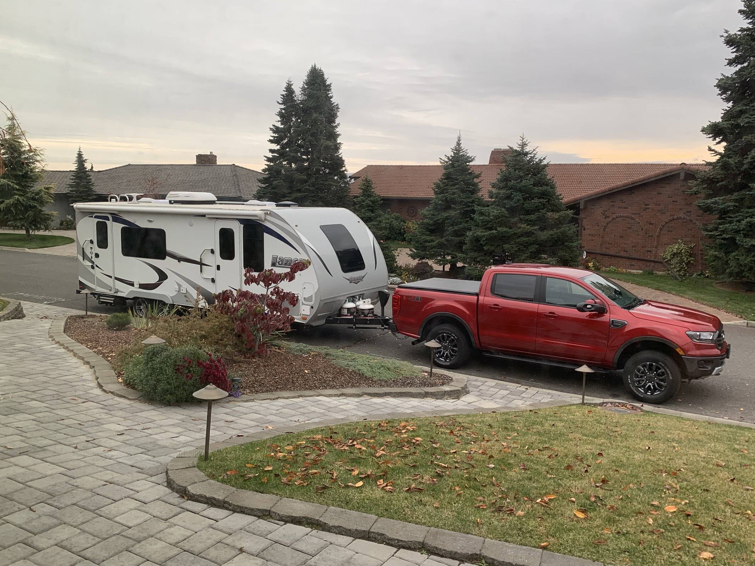

Amazing. And I was worried about towing my Lance 2285. It too performed like a champ up grades. But according to the numbers, I was near the weight limit .
