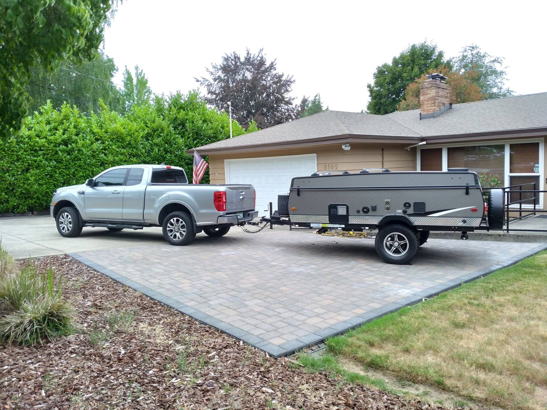

I tow this tent trailer and with my Bilstein shocks I don't even know it's back there. I have towed it on gravel and dirt roads, highway at 75mph good to go. I do put weight in the trailer since it's only 1200# to help out. I still really need to stop at a weight station and determine my whole GVW, GV trailer weight when loaded but so far with 6 trips in the books good to go. The bed is full of camping stuff.

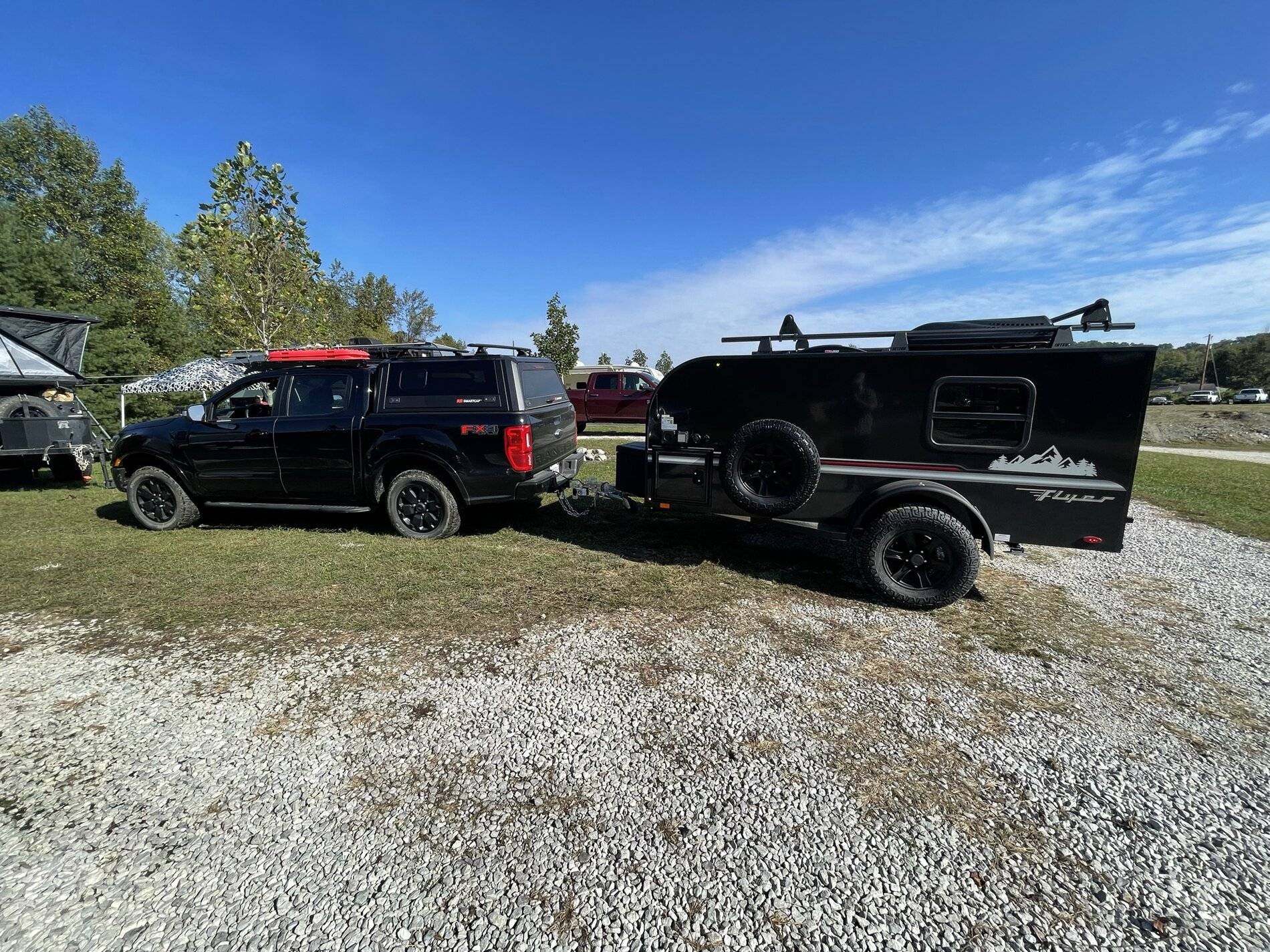

Just picked up my 2022 Intech Flyer Pursue. 1600lbs dry weight, tongue weigh about 200lbs
I drove from VT to KY to IL. the owing experience is horrible (stock equipment: only light bedding added). I'm towing with 2020 Ranger FX4 with tow package (7500lbs capacity) and every time I go over bumps or even slight undulations on highway it's bouncing so much that it feels like the car is misfiring (feels like a back and forth push-pull).
I've towed a Bantam T3-C (no shocks) for a year and that bounces all over the place, but I've never felt it in the truck (half the weight though). Hitch height is perfectly set, and I have a 2-inch WeighSafe ball hitch for the trailers 2-inch receiver.
Anyone got any ideas?
Thanks

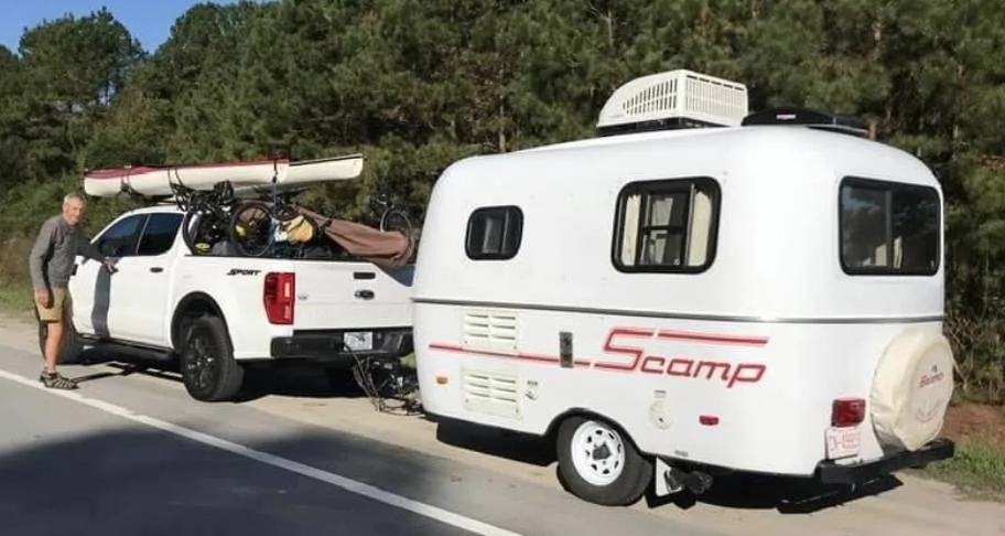

I just pulled this, loaded about 200 miles with no problem. I shouldn’t have, but at times I hit 80mph. I also have lots of gear under those battery assist trikes with 4 bundles of fire wood. This is a 2019 Ranger. Go figure.
