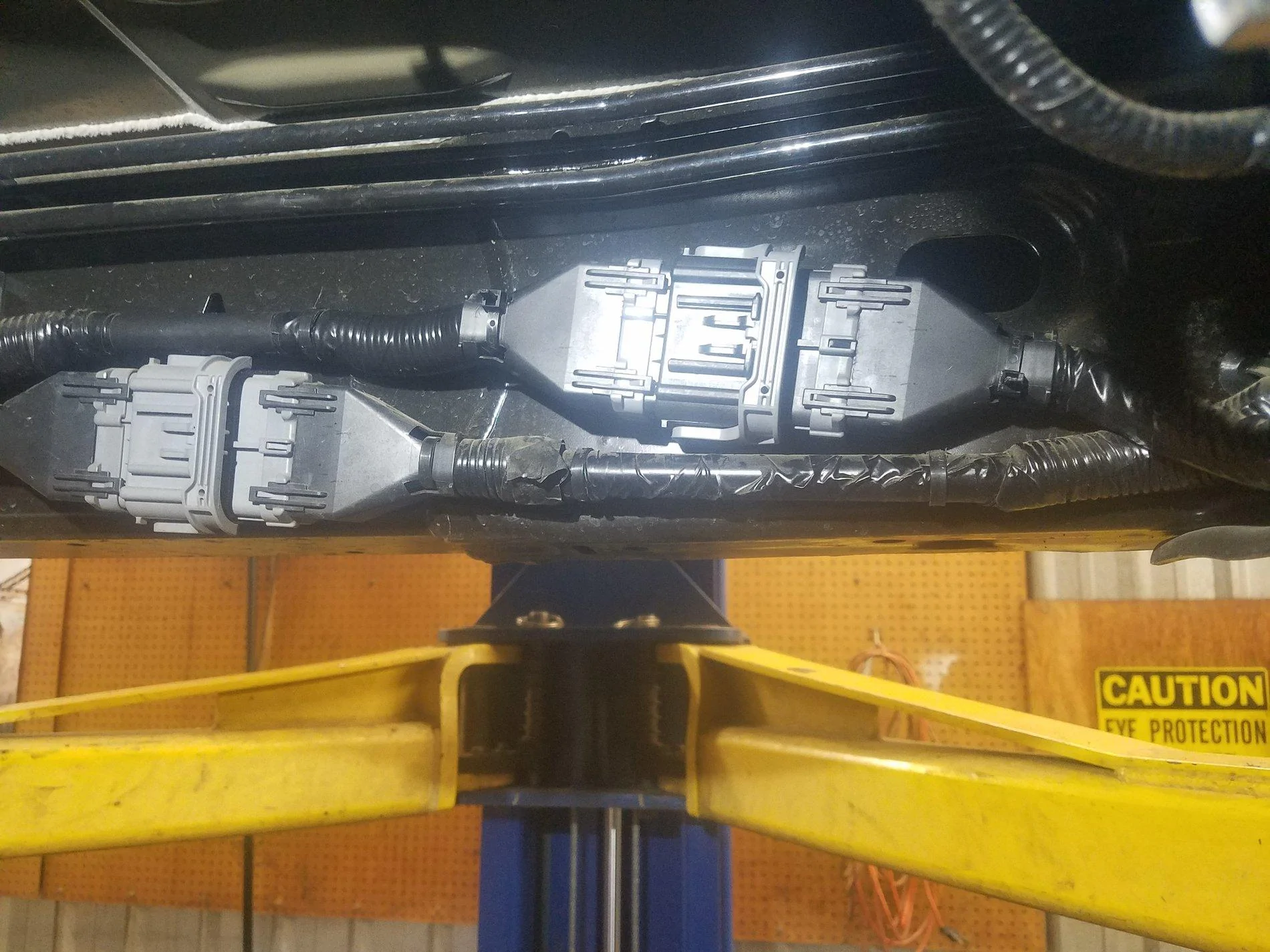

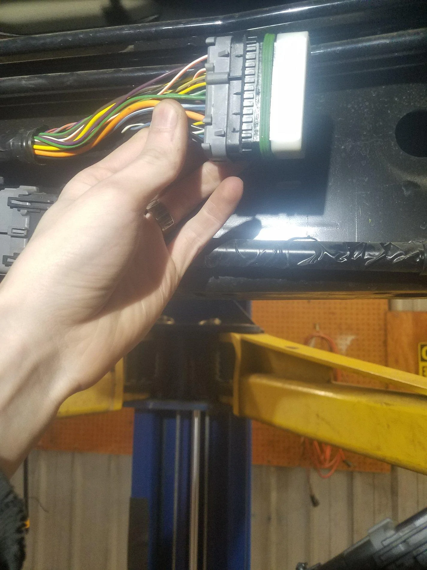

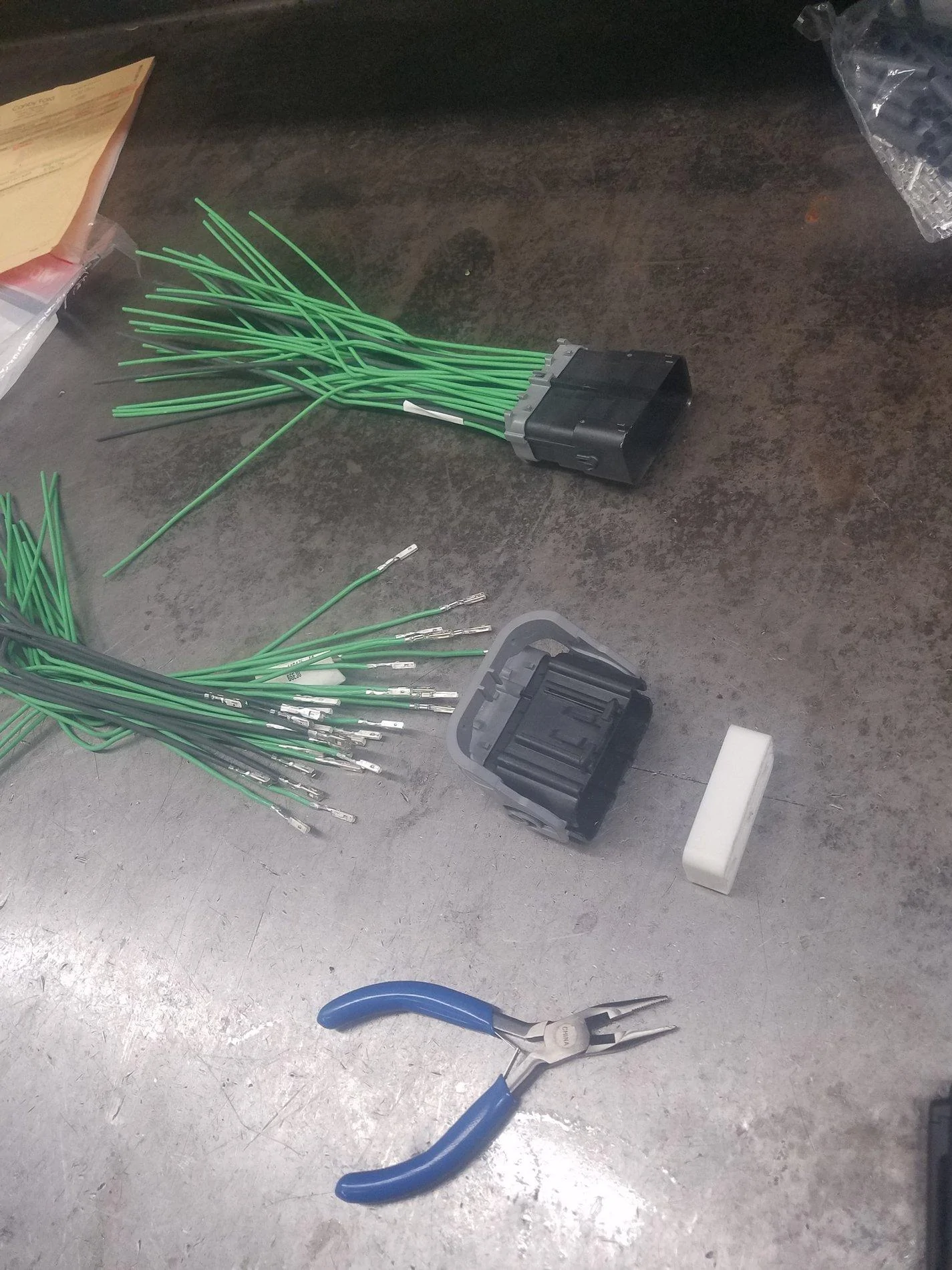

Here is the two replacement connectors. The male is on top, still assembled. The new female down below depinned.
Here is the broken female connector
Halfway through transfering pins.

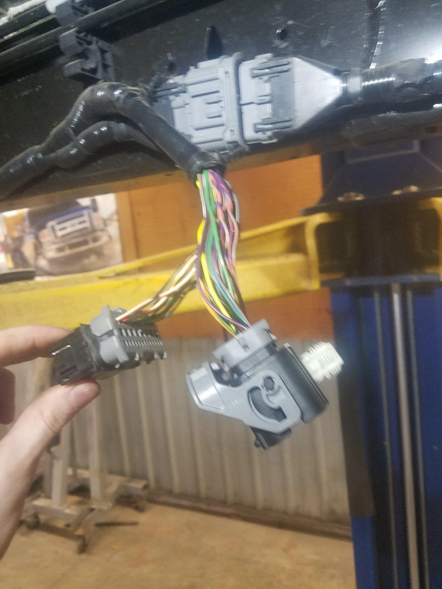

The first truck complete and reassembled.

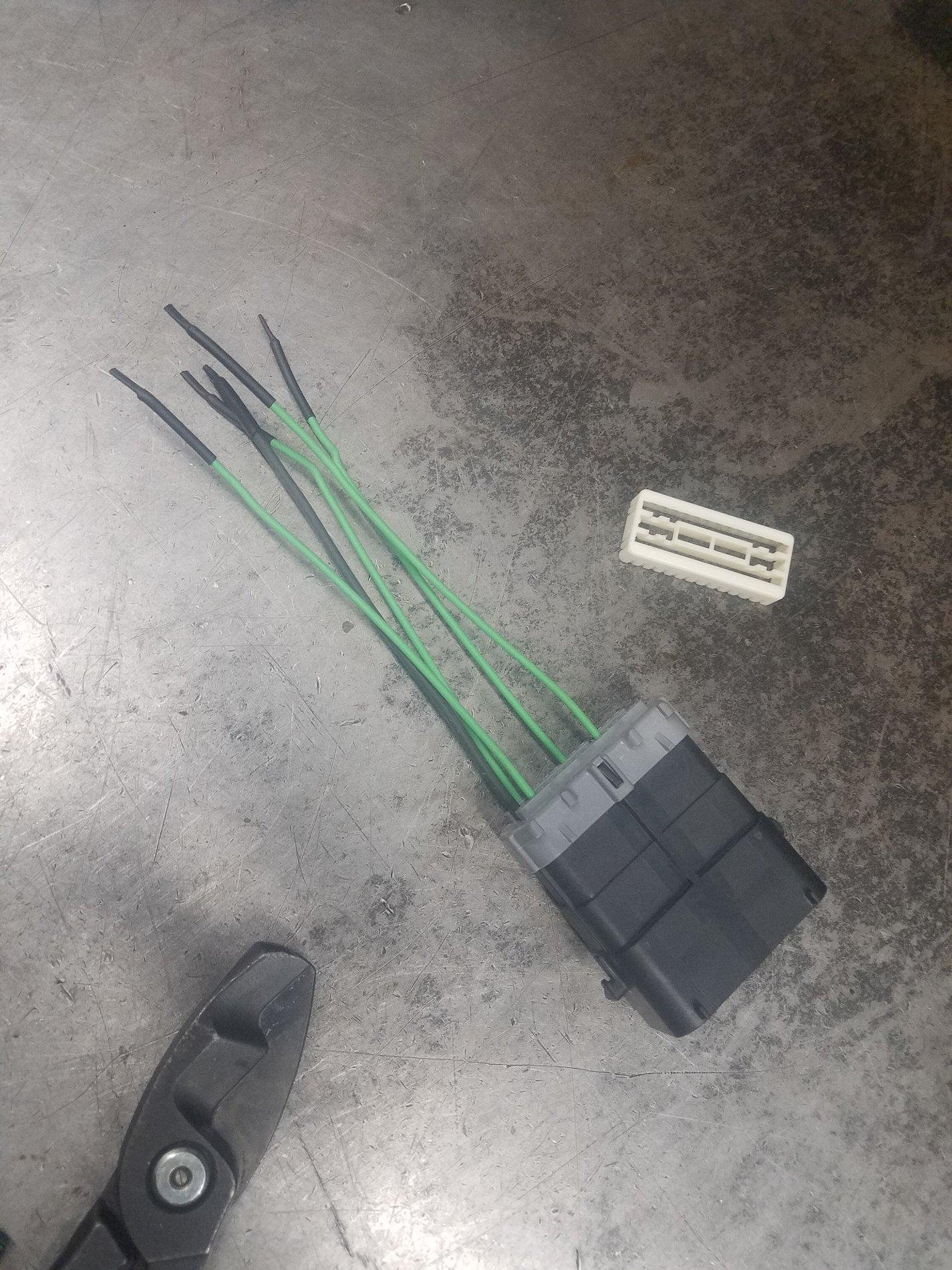

This is the male connector about to be installed on my truck. Not all cavities in the connector are used in this one so a few wires are trimmed and heat shrink over the ends.
Unfortunately I forgot to take pictures of this one while it was apart. The male pins are way harder to remove and install in the hard shells. After repinning a total of 64 tiny pins in somewhat fragile hardshells i was a bit frustrated.

Sorry for the two extra pictures at the end. I couldn't figure out how to fix it.
Nice work. It looks like you really take the time to complete the repair nicely so it looks and functions like it came from the factory. A guy like me (long time 12 volt installer) really appreciates this level of detail when it comes to wiring!
Thank you! I try to make every job look just as good or better than factory. Even when we get 20 year old vehicle in, I try to make it look like no one has ever touched it.
