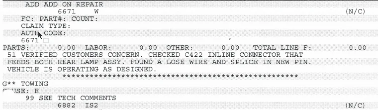

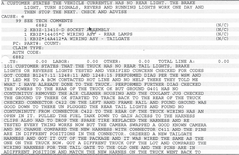

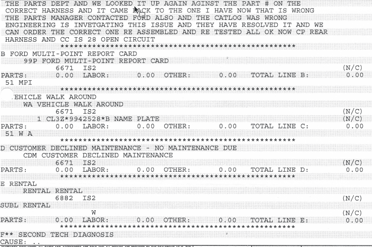

So after 2.5 weeks and working with Ford they traced the issue back to a pin in one of the large wiring harness connectors underneath the cab. They first pushed the connector pin back in...drove it and it came back out. They replaced the pin. Waiting on the full write up when the tech gets back in next week. At least i made it home from the dealership this time...

Nope that connection is the issue with mine. Wiggle it and they come on and flicker. I got the one side apart, seems like a female connector backed out but I can’t figure out how to access it.
