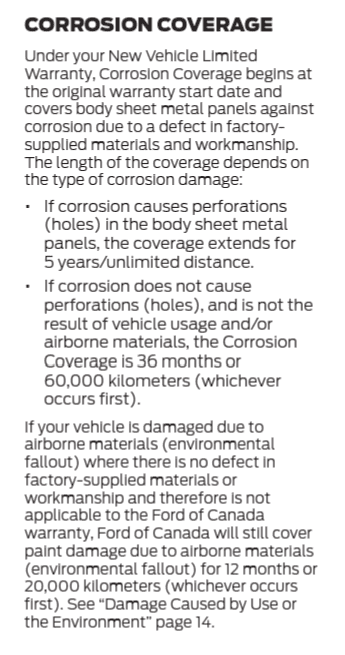

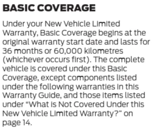

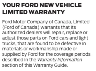

I know this is the Canadian warranty info, but this is the basic statement that should apply if you're still under the basic warranty
page 14 has no criteria that would involve your situation.

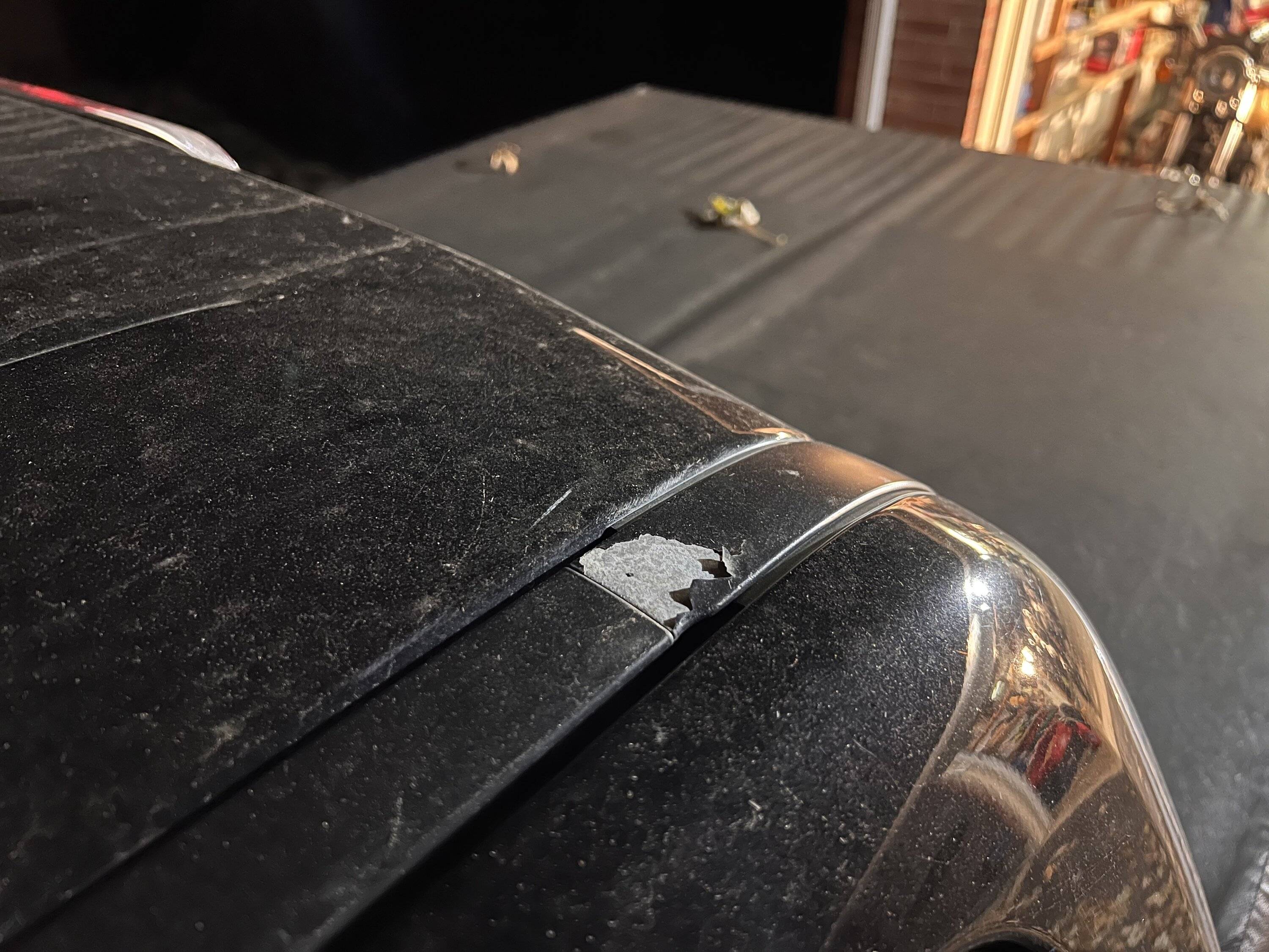

Well… I think you’d call it the roof trim… whatever the case, here’s a pic:
what are my solutions for correcting this? Run some sandpaper on it to clear the flaking, tape off the area, and then hit it with some rustoleum? It’s the roof so I’m not ultra concerned about the appearance. I just don’t want rust to set in. Open to suggestions!

You can see if the dealership you got it from will repaint it. Had a similar issue with the paint not adhering properly on a Mustang hood that was repainted as a warranty claim.

yeah I appreciate the thought, but I’ve had this Ranger for over 3 years and the warranty on it is smoked.

What you thought of is probably your best option if you are truly concerned. Or this is a great time to.get a roof rack that will cover it!!

I replaced that exact problem under warranty. They had to drop interior celling to get to the screws to remove the trim.

Holy crap…. I seriously thought mine was caused by like a rock or even bit of hail (I’m parked outside) so I never thought check the TSB/Issues section… hell , I didn’t even search for it as I thought I was a one off and this was just a paint maintenance. Sorry for the duplicative thread!
No way im paying Ford to drop my roof ceiling to get at screws and stuff. Rustoleum for now, and maybe a helpful roof rack down the line as @Frenchy suggested.
Much appreciated, folks!
