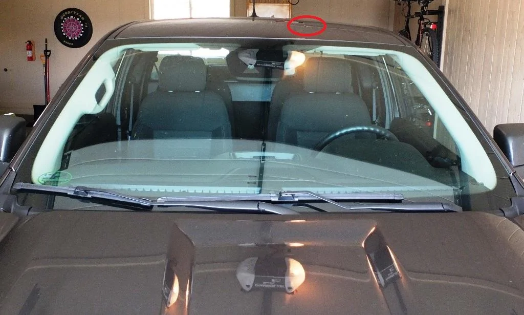

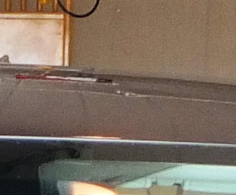

Was washing my Ranger today and noticed the plastic trim on the roof deteriorating and breaking off. Anyone have this problem? I've owned the 2019 for less than a year.
I wouldn’t call that “deteriorating”. You certainly have lost a piece of that trim, but that looks pretty specific to be something over time. Maybe that’s been there for a real long time and never noticed?
or are you indicating it’s flaking off when you washed it?
It's been missing for less than a month. I wash regularly and always wash the roof.

Get with a dealer, should be covered under warranty.
At least on my RWD, that trim is aluminum with what looks like a baked on finish.
Looks like on yous, the finish failed and separated from the rest of the piece.
My local dealer replaced all 6 brackets for the side steps on the wife's FX4 for very similar issues with the finish.

Hi Peter
Clearly a quality issue with the supplier of this part. Warranty should cover without any hassle. If not, file a formal complaint with Ford Customer Care and find another dealer.
The supplier has to demonstrate process capability and somehow in the manufacturing finish process something went wrong.
Sorry to see you have a cosmetic problem such this that should never have happened.

No pension....Took a pension buy out many years ago. Had the pension for about 10 years then Financial Advisor told me to take the buyout. So I guess Ford could block my new vehicle purchases on Z plan, but I doubt they would do this...no biggie if they did. The reason I advocate filing with Ford Customer Care is that if enough complaints come in to Ford, then it is likely to land on some Engineer's desk or with Supplier Quality Assurance and corrective action is put in place.

Mine started corroding and bubbling. Ford replaced in under warranty they had to drop headliner to get to the nuts that are holding it.

Yep. I have an appointment next week for the same thing. It's the rear corner piece on the driver's side. I'm also having them look at the lower front side window molding on both sides. They have faded badly and look splotchy. There is a thread somewhere here where people had them replaced. Apparently, Ford knows there has been a problem with them.
