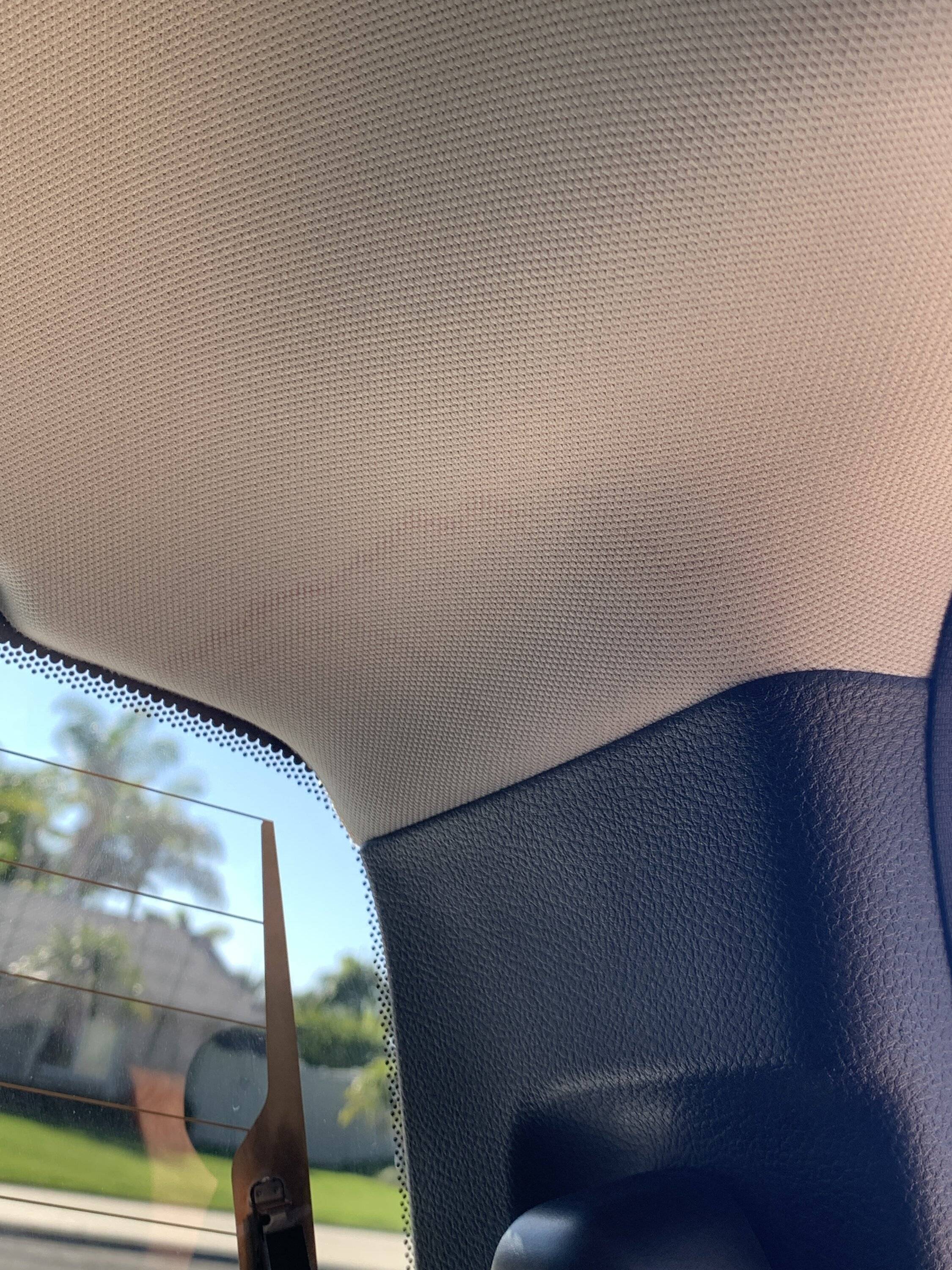

First of all, thank you Ranger Forum.
Damnit this is infuriating. I just noticed a stain on my headliner over the drivers side C-pillar. 2020 Ranger XLT Super Cab. It’s garaged, but sat out in the rain the last storm San Diego had. I searched the forum for similar issues and find out Ford knows about this. Now I have to trust the dealer will repair correctly and not happen again. My 2000 F-150 leaked at the rear slider, which was common, and I’m not happy having a new truck that rains inside when it’s raining outside!!
