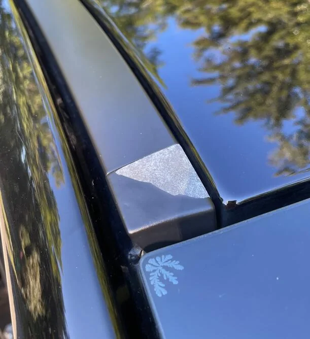

Roof trim deteriorated

Since I removed the entire trim and cut off a majority of it, I touched up that piece with some spray paint. Nothing else I could really do.

The plastic is brittle and metal under the trim is corroding. There's a few thread about this issue. It's an issue with the supplier early on.
9,667
46,239
Some folks had it covered by warranty, some did not. Apparently, it doesn’t fit Ford’s criteria for “perforation”, and they can easily point to car washes and the harsh cleaners they use, so most folks were/are out of luck.
You’ll have to drop the sides of the headliner to remove them - two bolts each, I believe. Then sand and paint with a rattle can. Or pay a body shop a pretty penny to do it for you.
You could always search a scrap yard for replacements that are still good.
Either way, a PITA.
There are threads - search away and good luck.

yeah this happened to me on my 2019. i wasn't gonna mess with the headliner. knowing my luck i'd screw something up and have a saggy headliner as a reward.
my solution was to stand on my truck's side steps, and put a lot of masking tape to the left and right of the rail there on the roof. then i sanded the bejesus out of the rail with some 800 grit sandpaper, then increased to like 2000 grit to smooth things out. gotta watch what you're doing and use your sandpaper wisely (sand by hand, no power tools) as the masking tape won't last long if hit by sandpaper. once done sanding i reapplied a bunch of the tape to cover off the body panel painted areas and then sprayed some matte black rustoleum on the rail. don't overdo it or it'll run on you. let it dry, then added another coat. pretty sure i did 3 coats of rustoleum spray paint.
it's been like a year since i did this and i actually was up looking at the roof of the truck this weekend. still looks great. rustoleum did awesome.
aside from the waiting for paint drying times i probably spent about 10 minutes doing this. it's the roof of a friggin truck, imo. no one ever looks up there. i'm not about to go to war with my dealer for warranty coverage over something i personally find to be so trivial.

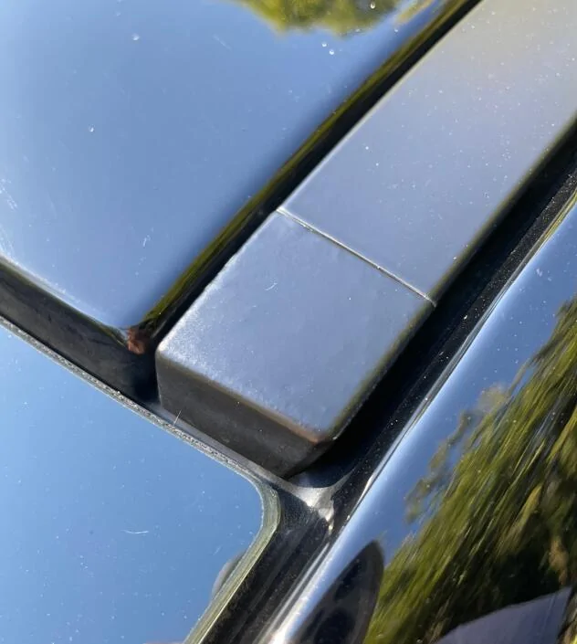

Look what I found today. First image is passenger side at the windshield. Second image is drivers side looking about ready to peel.
I might try the dealership before painting myself.
