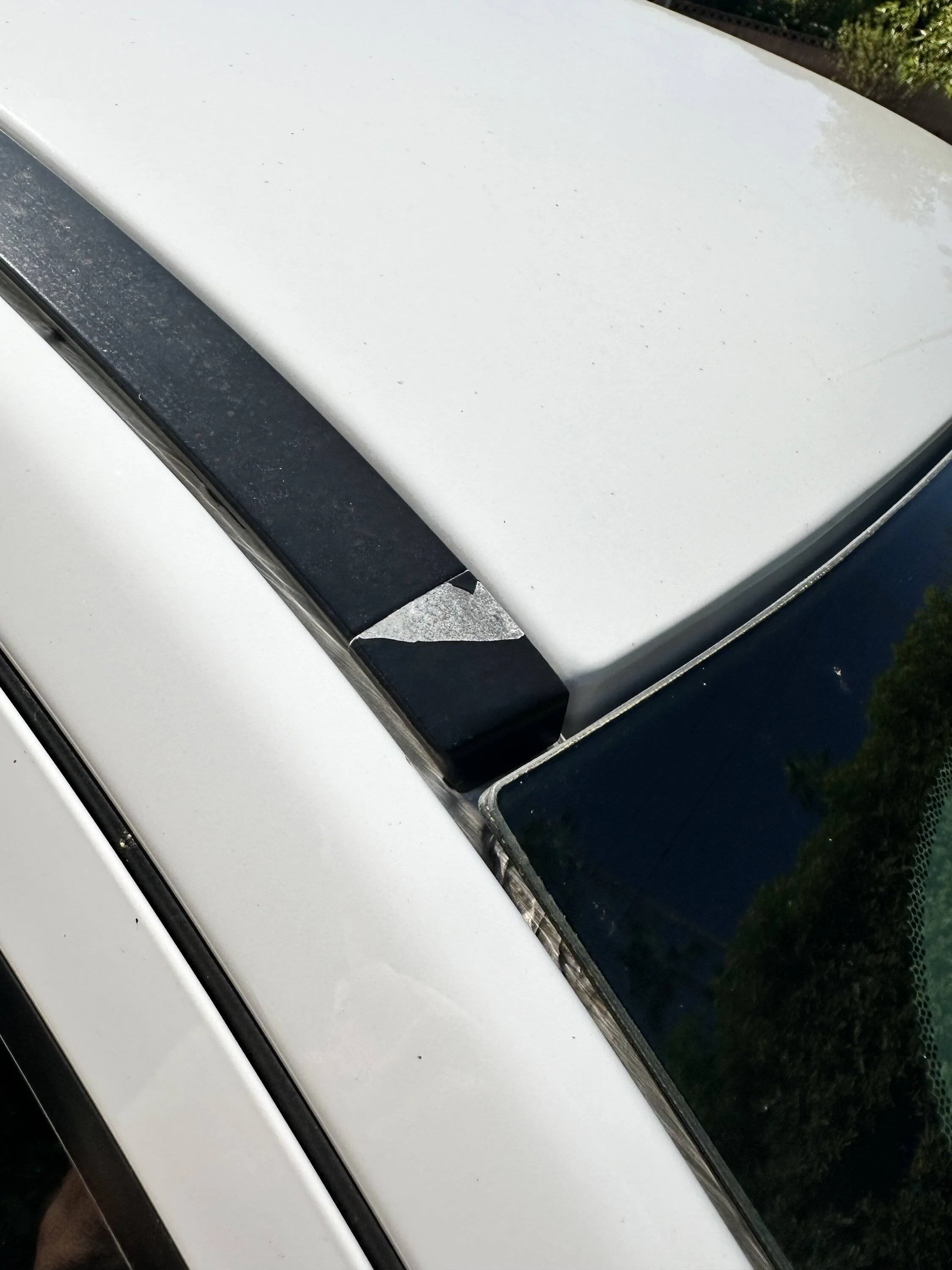

Roof trim deteriorated

To replace, the headliner has to come down. I had mine done under warranty.

Yes, lower the headliner down far enough to gain access.
The roof molding is attached with (2ea) nuts, 1 on each end of it.

I have the bubbling on the drivers side (2020 XLT) piece but it has not peeled yet. So, it probably will soon.
Might try to cover with a piece of vinyl wrap. You will need to get any lose paint off and sand smooth. I used the low gloss vinyl wrap on my Explorer window trim and it held up really well.

Anyone know what part this would be to replace? Might just go the sand down and paint route but yeah both my back sides of the rail did this on my 2019

Part Number varies for Super / Crew and Left / Right
Example:
Crewcab - Right
Roof Molding - Ford (KB3Z-2651700-A)
2019-2023 Ford Ranger - kb3z2651700a
  • MSRP:$465.00
  • Discount:$146.94 (31.6% off)
  • Sale Price:$318.00
You will find them on Ford Parts Listings under - Exterior Trim - Cab
All priced around 300.00

I'd spend two minutes at it with a Sharpie marker.
Out of all the replies in this thread, this man gets it.
I'm still trying to figure out what genius at Ford designed them this way. When I installed my roof rack on the ZR2 the gutters pop out with a trim tool. They are held in place by by special brackets that hook onto small nibs welded to the top of the roof. The strip itself is industry standard with the rubber covering a long strip of metal.

Meanwhile Sandpaper, masking tape, primer, and paint $20-$30.

This ridiculous price is one thing, but who's to say it won't blister & peel too!?

Wow, my 2019 XLT has it both on the driver and passenger side.
Neighbour suggested a wrap would be the best fix. My issue is the touch up paint is gloss and this has more of a mat finish.
It look likes it might be aluminum (have not tested with a magnet yet). If so it won't rust. My problem is my office is on the second floor so I see it every time I look out the window....
