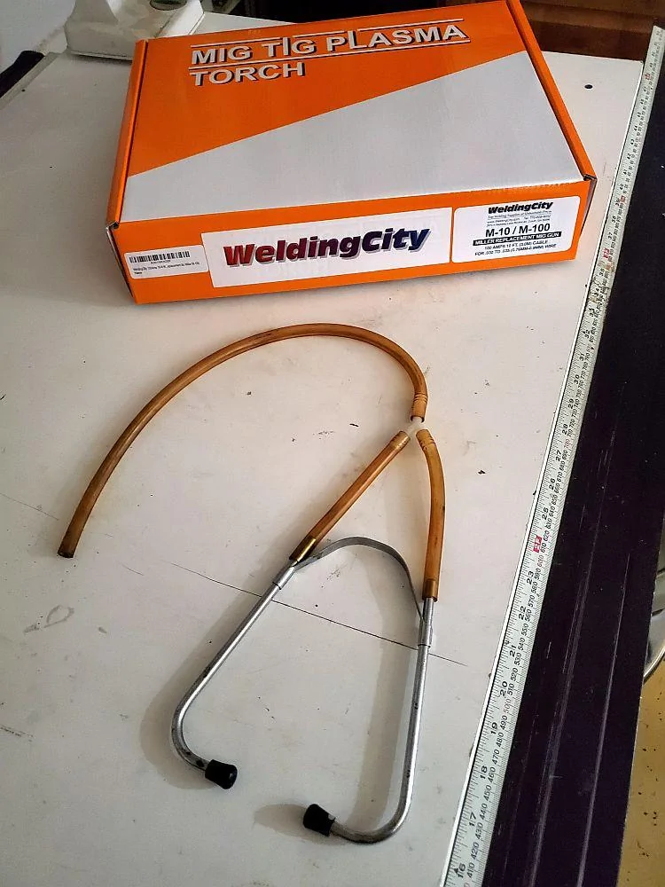

Thanks, Phil. I have read your posts about using the stethoscope and as a matter of fact, I purchased one from Amazon. The darned thing had such a strong spring to hold the ear pieces in my ears that it actually was painful to use. I sent it back for a refund. Looks like I better go purchase a new one. Thanks again for your help. By the way, I tried to work the window seal down as you suggested and I guess I am not strong enough. I couldn't get it to move.
