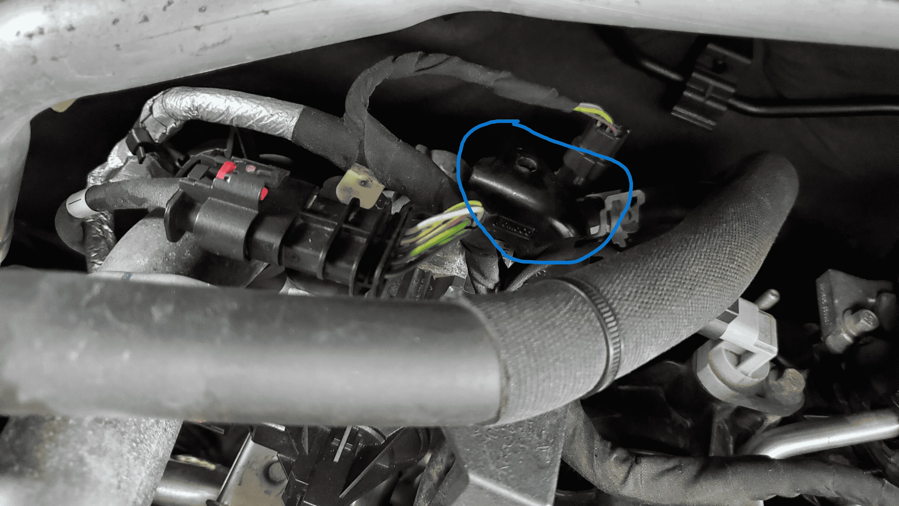

I can't find the spot where you put the clip nut to mount the dipstick tube. I have searched twice. Anybody in the Cleveland / Akron area install one of these? I'll come to you to show me where it is.

Its just a black piece of metal with a hole in it at the back passenger side of the engine.

You should have this bracket. I have trying to determine the purpose of this unused bracket, but we are glad Ford gave it to us for this extra modification. It was clearly installed to mount something.
Could it possibly be Ford thought about giving us an easier way to check the Tranny Fluid but scratched the idea for cost. - HMM

That's a pretty substantial metal bracket...heavy duty something...let's see who's first to figure out what it was for?

This is EXACTLY my thought when I first saw that bracket. Ford cheaped out.

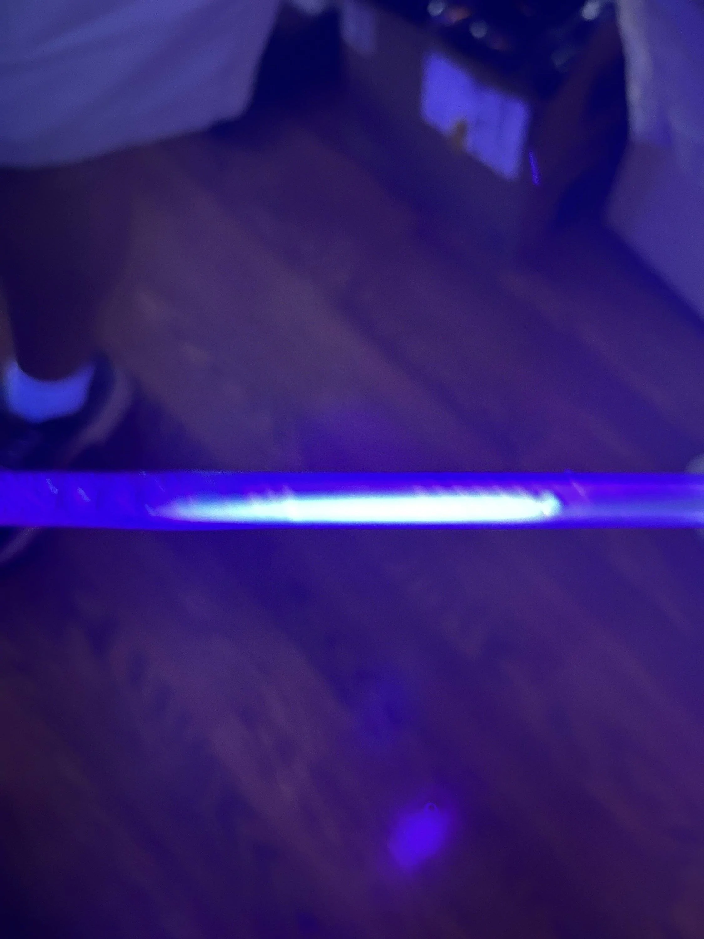

I just poured some black ink in with the oil, shows right up!! (warning, do NOT try this at home)
:LOL: :LOL: :LOL: Seriously, it is hard to see, does ULV glow under black light??
OK, I said that last as a joke, but I still have a hand UV light we used for finding blood stains, so for fun I tried it, and the dang ULV shows up well under UV!, who would have thought?
