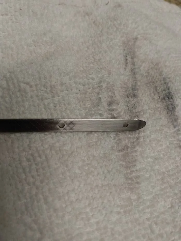

Steve got a picture of your scuff work.
Here...may be hard to see as 400 grit isn't very aggressive. But it took the "shiney" off, dulled it up a bit so red fluid is easier to see. Just scuffed up to the cross hatch area.
The bottom of the cross hatch area exactly matches the #4 on the reverse side.
The stick looks dark, but it's just in the shadow of the phone/camera.
