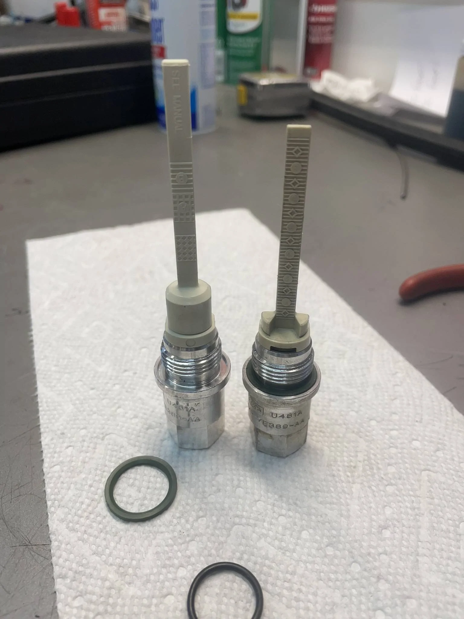

Ok part number for factory dip stick cap and plug is JL1Z-7A010-A 1X
If you look closely on the second photo you can see a green fiber washer used for sealing. It is undercut on the Aluminum cap so the edge of the cap hits the Transmission case and keeps from squeezing the washer past its max compression point to splitting.
I also ordered this part, it very different than the one in my Ranger, I would not model this dipstick without verifying it's same as the one in your truck.

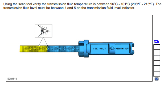

Interesting, started doing more digging and although the Ranger and F150 use the same transmission the dipsticks are different. For what ever reason the part number they list fitting in the Ranger is actually for the F150!
Ranger manual dipstick reading
F150 reading

And the one in the picture doesn't even match the graphic from the manual. Way to go Ford!
