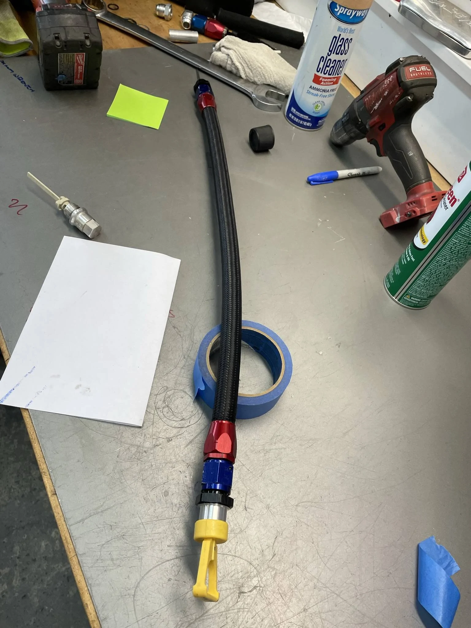

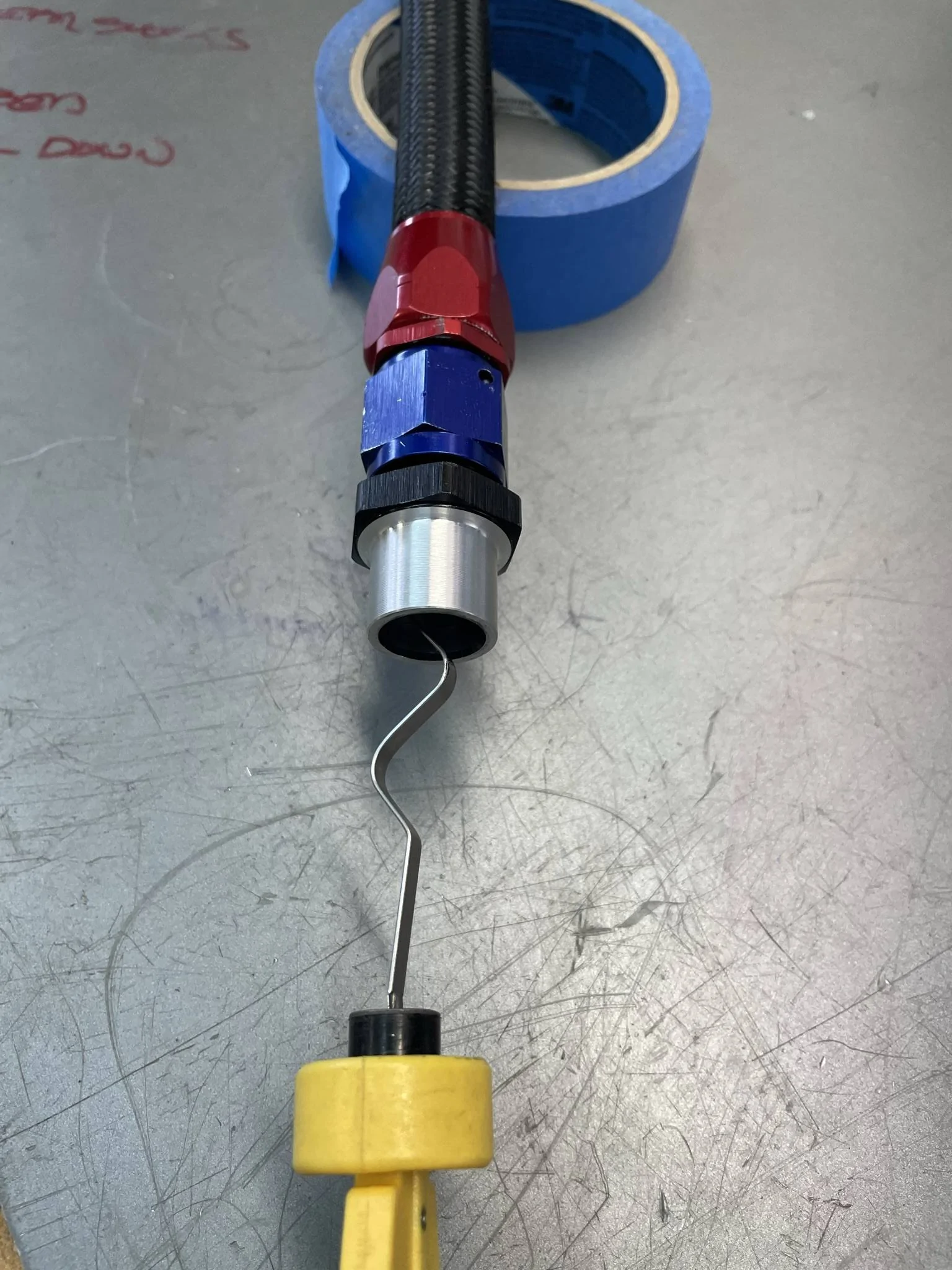

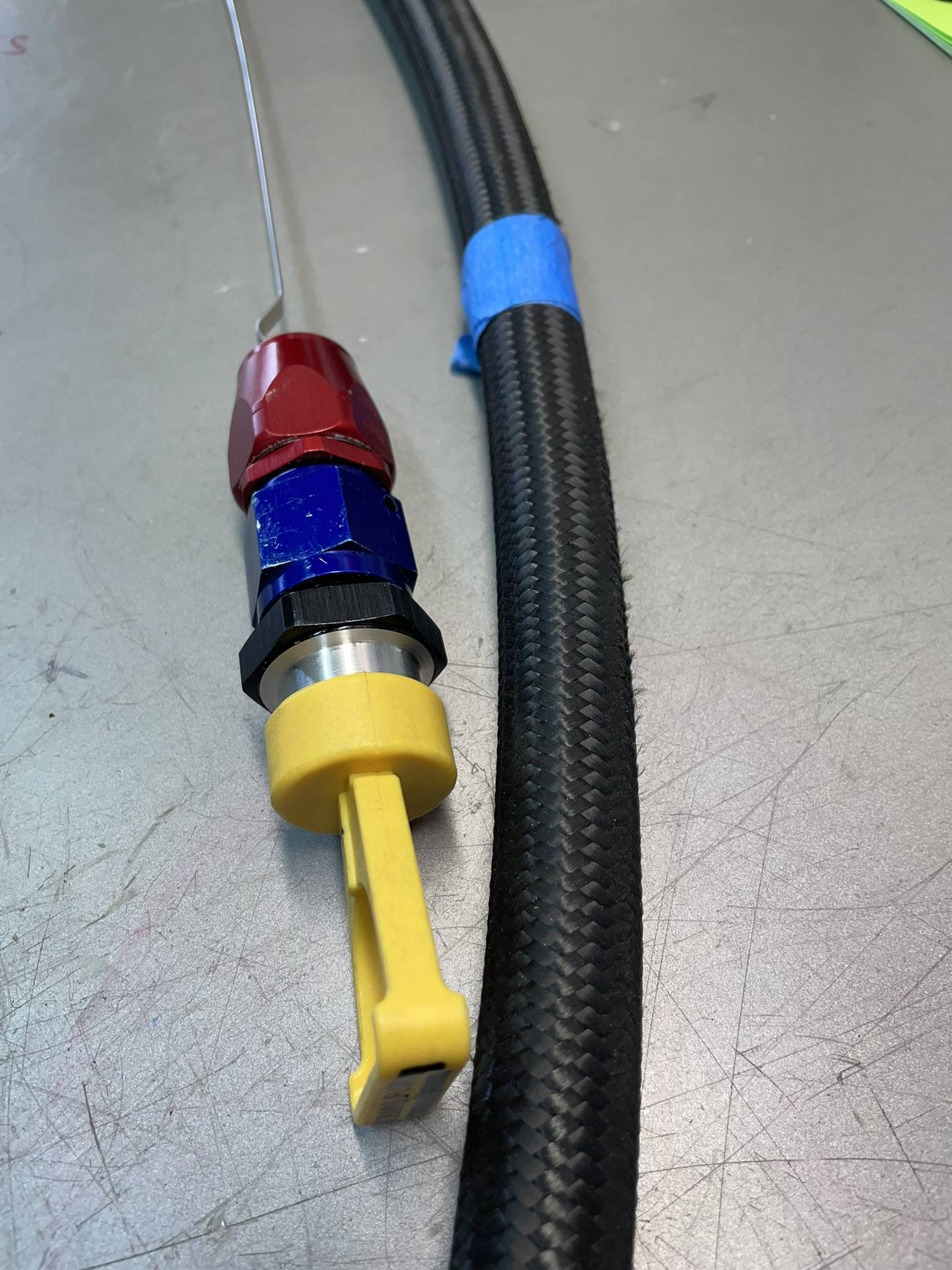

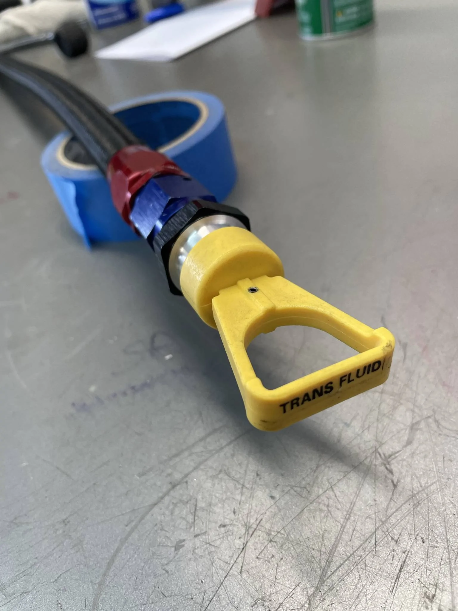

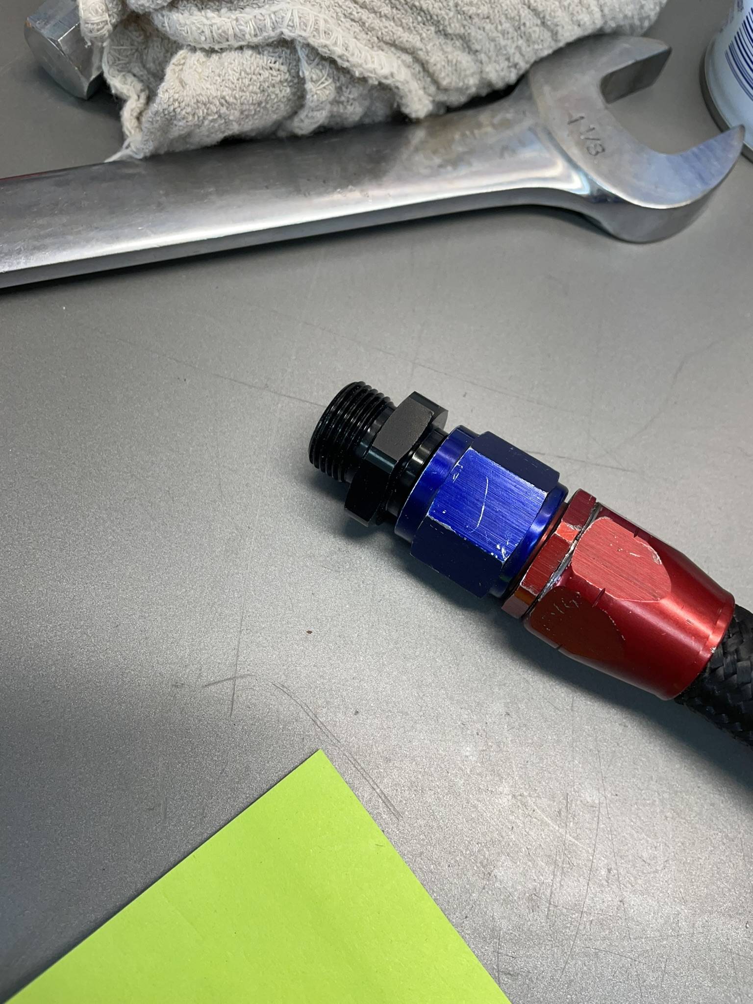

This started for me with the transmission acting up, I read on here about some trucks being delivered 3qts low, I checked mine, it was low, that whole crawling under the truck to check it, is simply stupid.
So for those who don't want to trust Ford or crawl around, there is the dipstick option.
B&M priced themselves so high, that guys like me would rather make one, if they are in demand, I may consider selling a few, maybe not.
The first thing is to make it, then fit it, then test it, if all is good, decide from there.

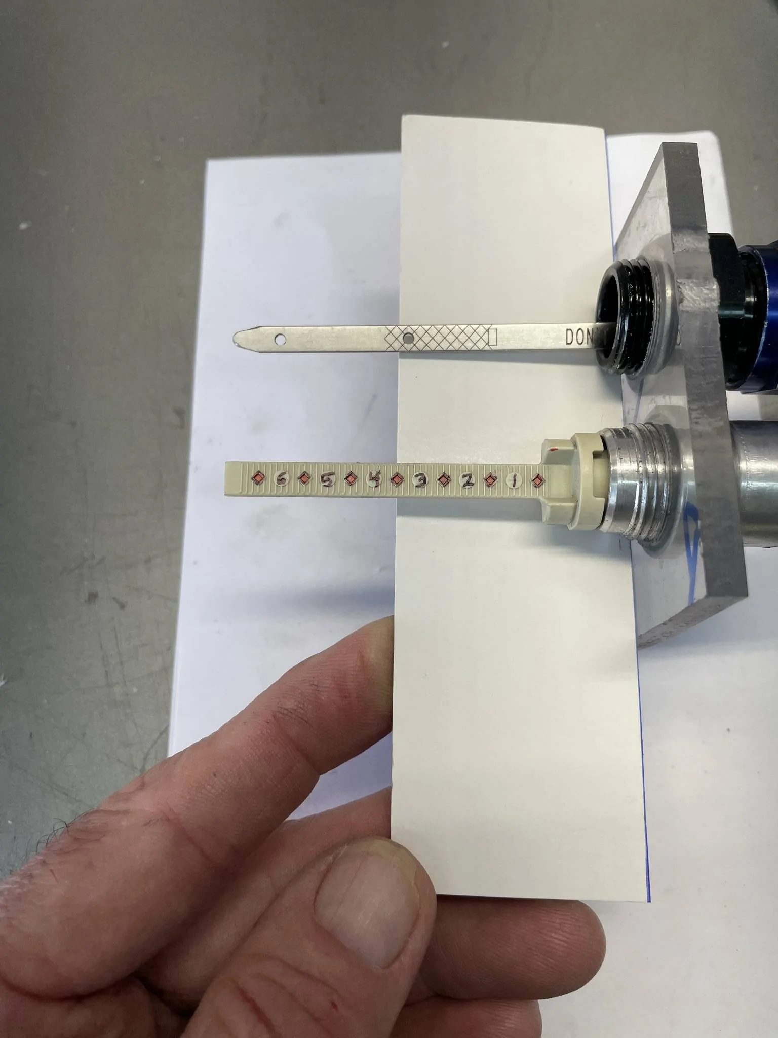

Do all the models of the 19-23 Ranger call out the same transmission fluid level hot?
Between 4-5 on the stick?
Both two wheel drive and four wheel drive?

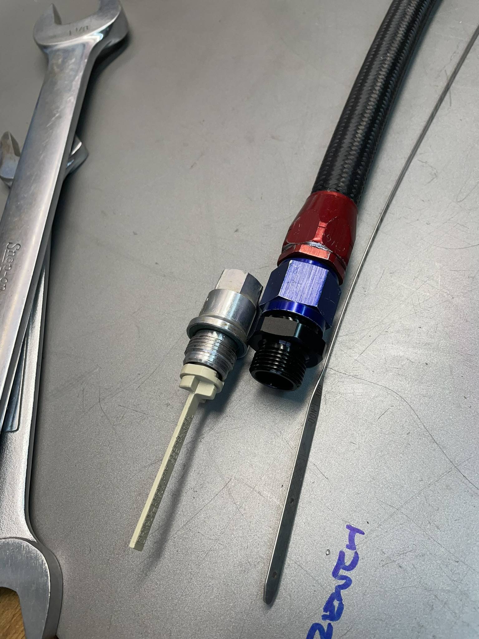

I pretty much have the cheaper stick figured out, with a real flat blade stick and a much bigger ID hose for filling.
If all Rangers call out for between 4-5 I may be able to make pre-marked sticks.
I still have a ways to go with making a proper mount, but it's getting there.
That's a great start Mike...if you get around to doing a limited run, please put me down for one...
9,198
28,381
NWO Robot Polisher
Well, I missed it by a 1/8th of a inch on length, I was trying to have the crosshatch start at the top of 4, as the stick says dont add in the crosshatch.
I will have to mark all the numbers if I go off and start making more of these.
I had to make a plate to get a accurate measurement.
So now I have to fab up a mount, what sucks the truck is at Ford getting it APIM module, I cant work on it.
That's lined up pretty good to me...
