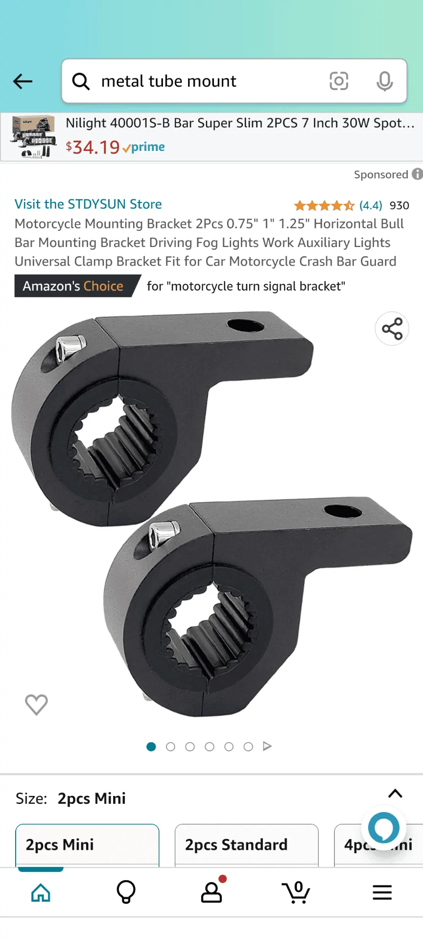

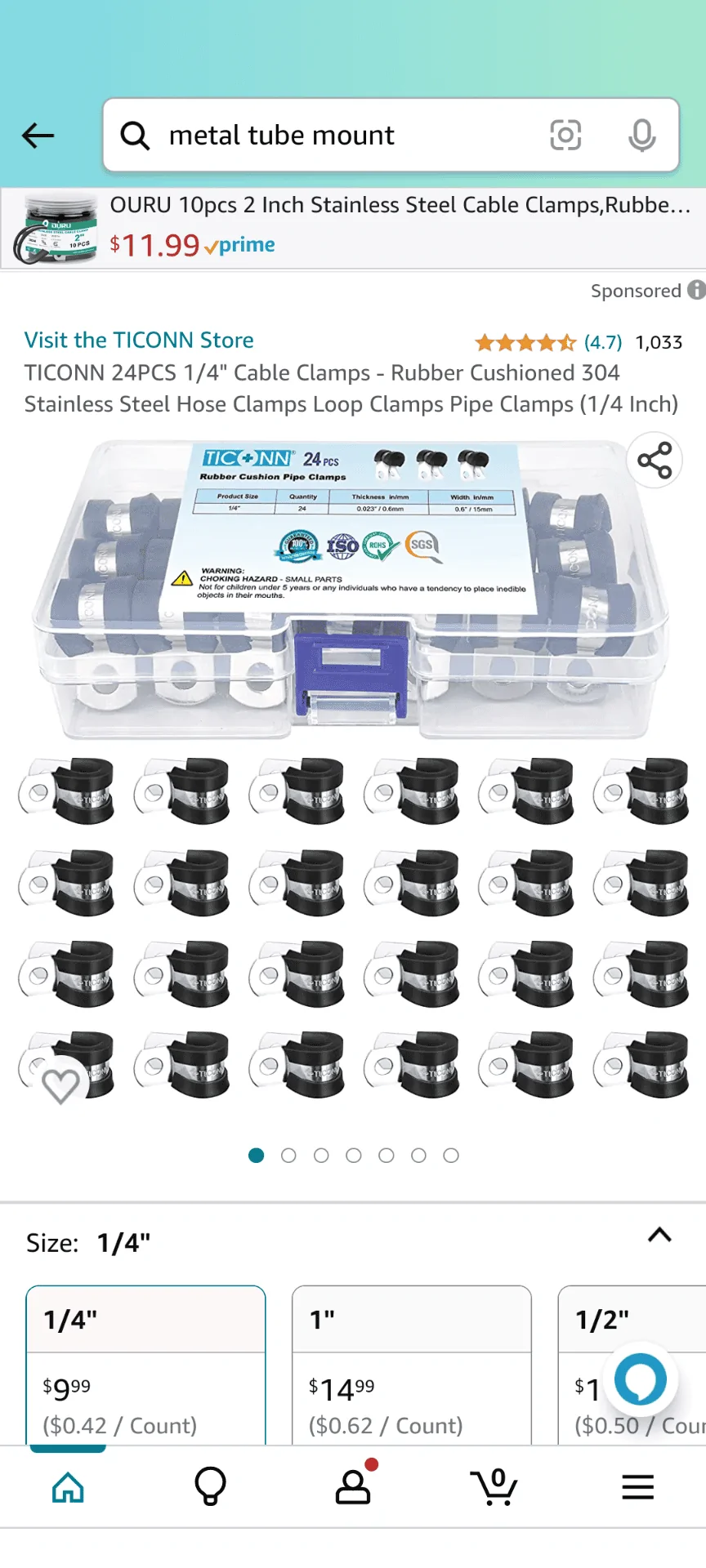

Amazon has a few options. There's a cheap way, and a nice way to mount things up. Could just look for a screw to mount it with or use a self tapping screw.
