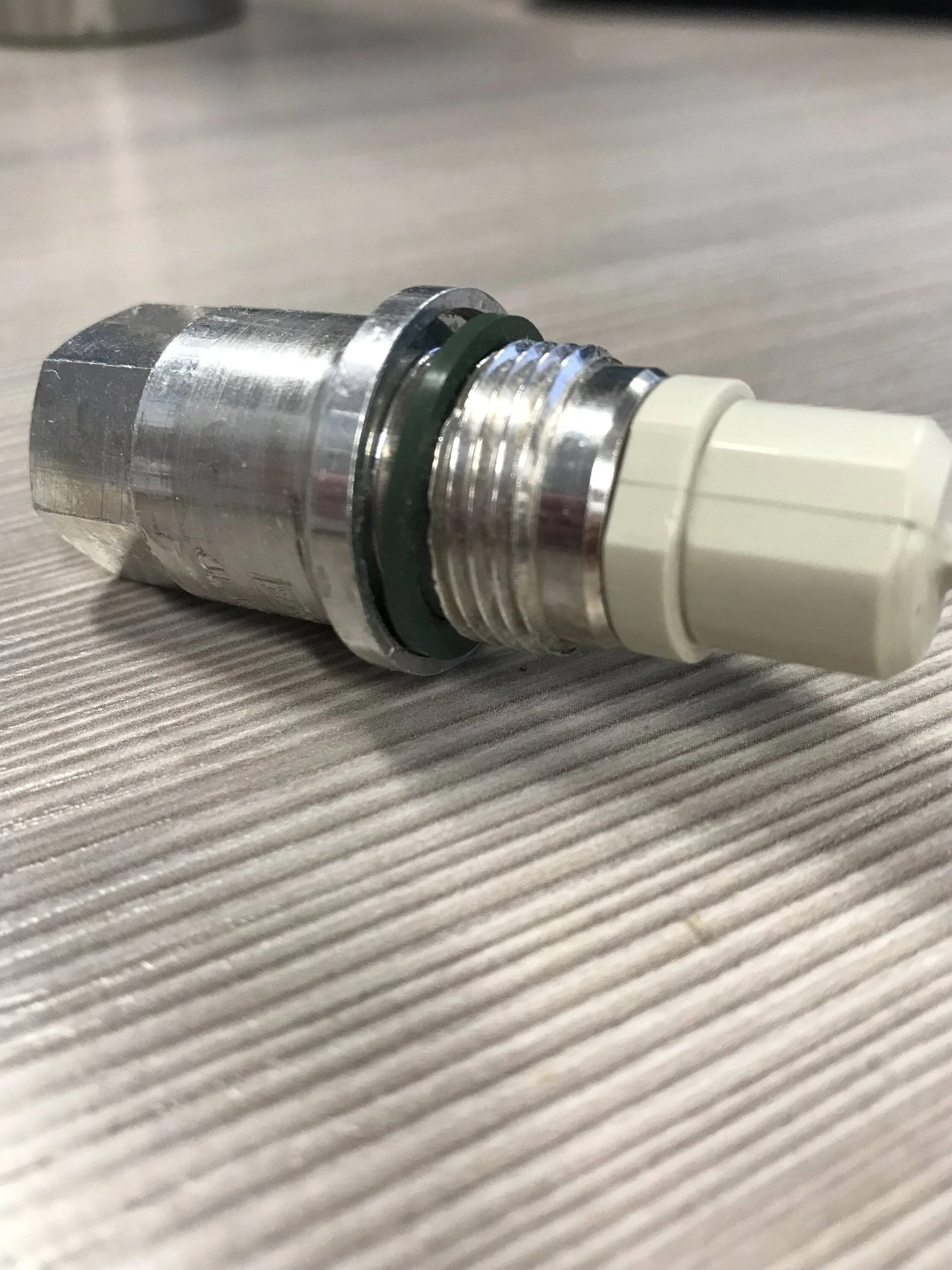

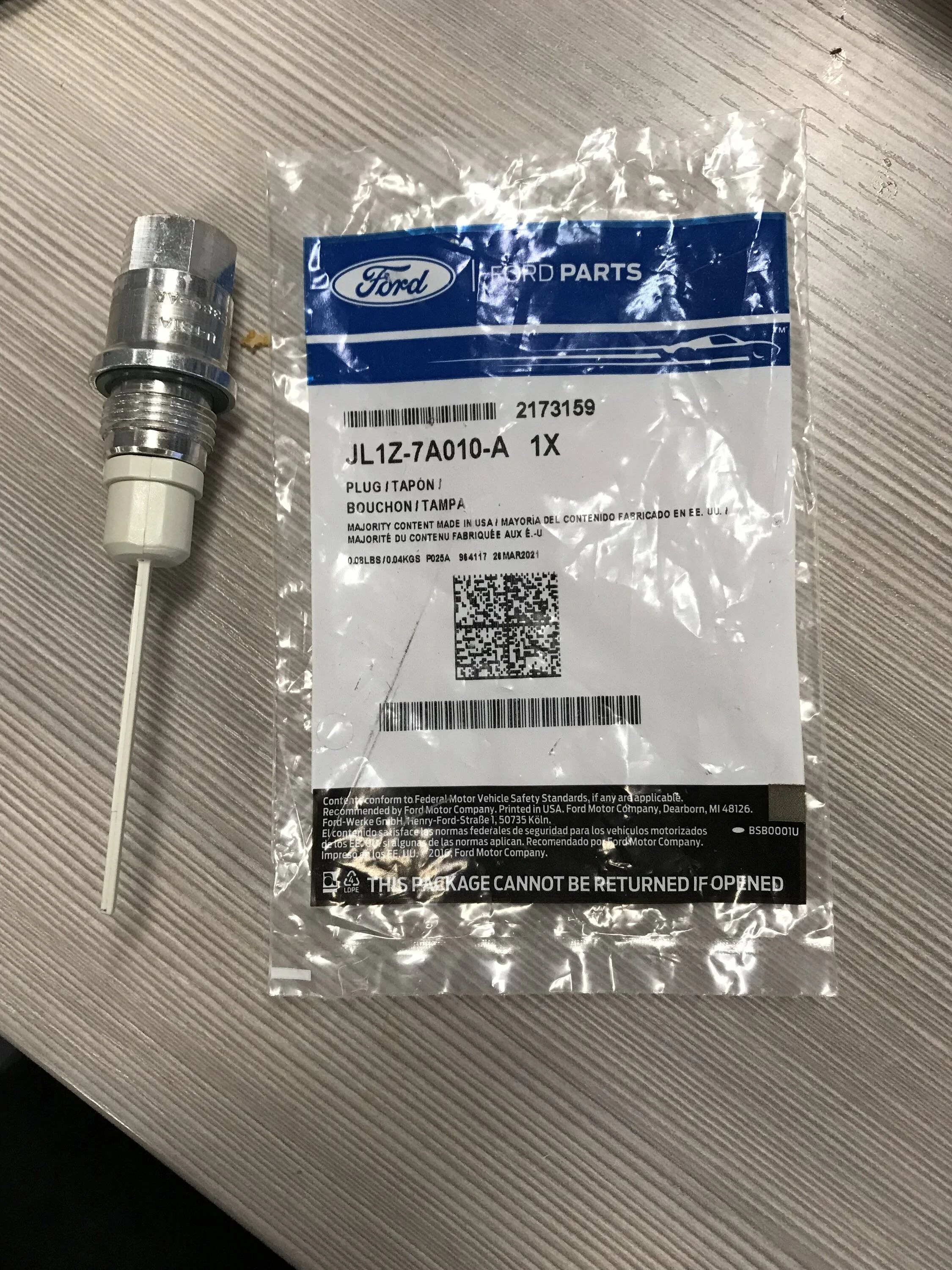

Ok part number for factory dip stick cap and plug is JL1Z-7A010-A 1X
If you look closely on the second photo you can see a green fiber washer used for sealing. It is undercut on the Aluminum cap so the edge of the cap hits the Transmission case and keeps from squeezing the washer past its max compression point to splitting.
Looks like you have a great head start! Thanks for the link Rick...the extra 1X is not part of number lol...threw me off...

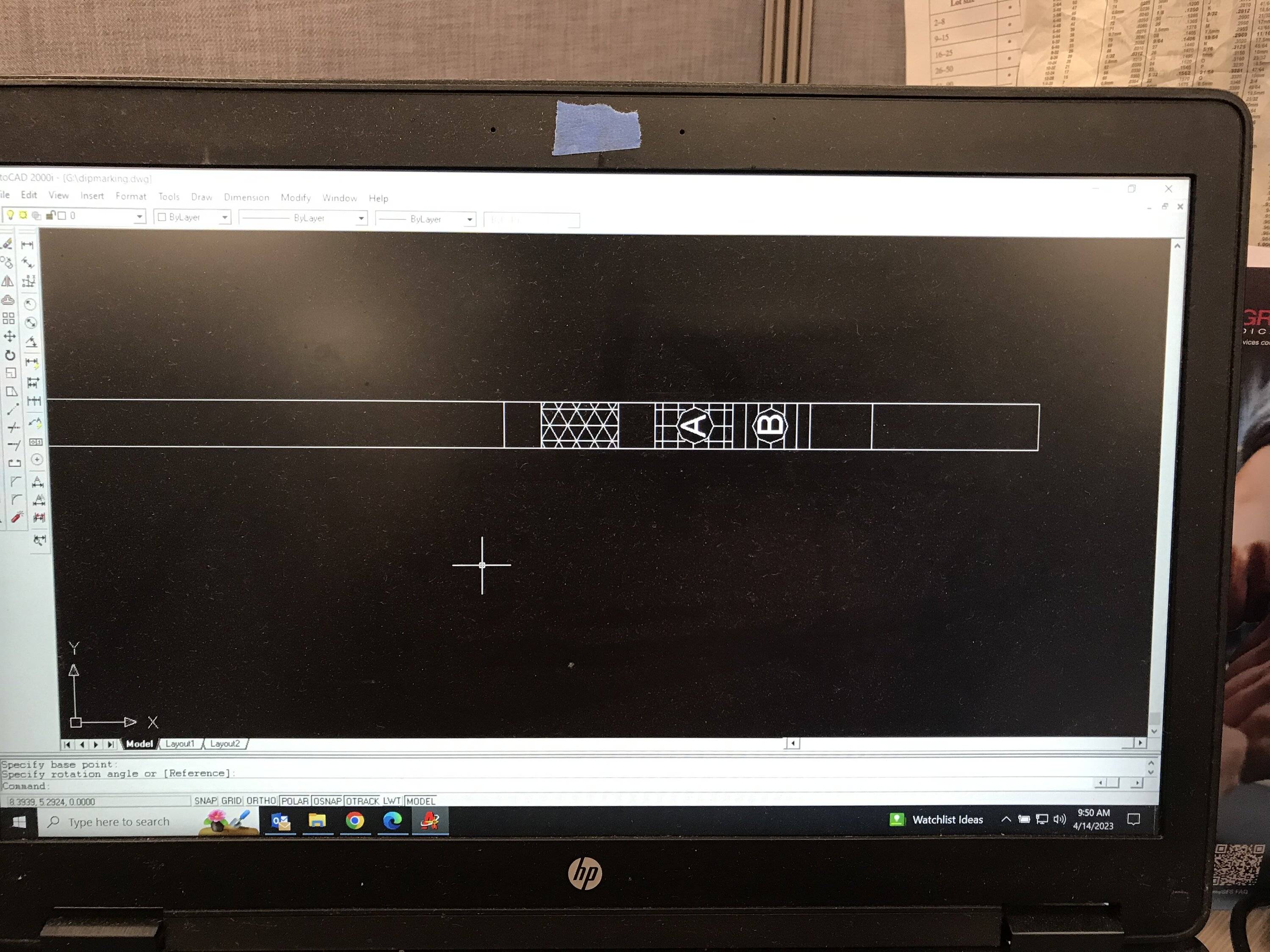

I won’t lie, long ago I looked into doing my own. Even bought a full dipstick and cap assembly from Ford. Also found a 5AN 3/8 ID hose with the right fittings. Did the CAD drawings to laser mark the Ford markings on the probe stick and then I lost focus on it. Still need to figure out how to mount the top end and still have it in a place that makes checks and filling painless. If that all comes together at some point I can then set the lengths of the blue steel inner probe so that’s not an issue. Different mounting will change the length it protrudes into the tranny case.
I think some of the fittings would have to be done on a Swiss turning center for replacement of factory nut and also the top end knob and lock mechanism.
Someday I get er done!
