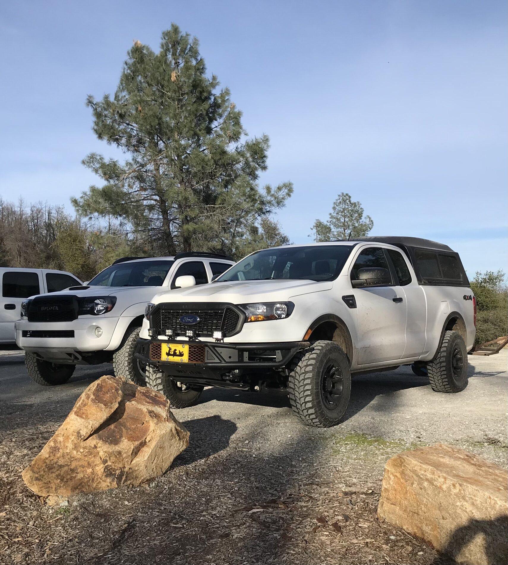

It's your call on what you do. In my opinion rhe KO2 is a great tire for offroad. If you take your truck offroad then I would suggest with that size or bigger. Why you ask? The more side wall you have the better for both the tire and wheels. Can you go with a different tire? Sure you can but I would recommend going through those tires or trying to get your money back by selling them or hoping the shop you got them at will help you out.

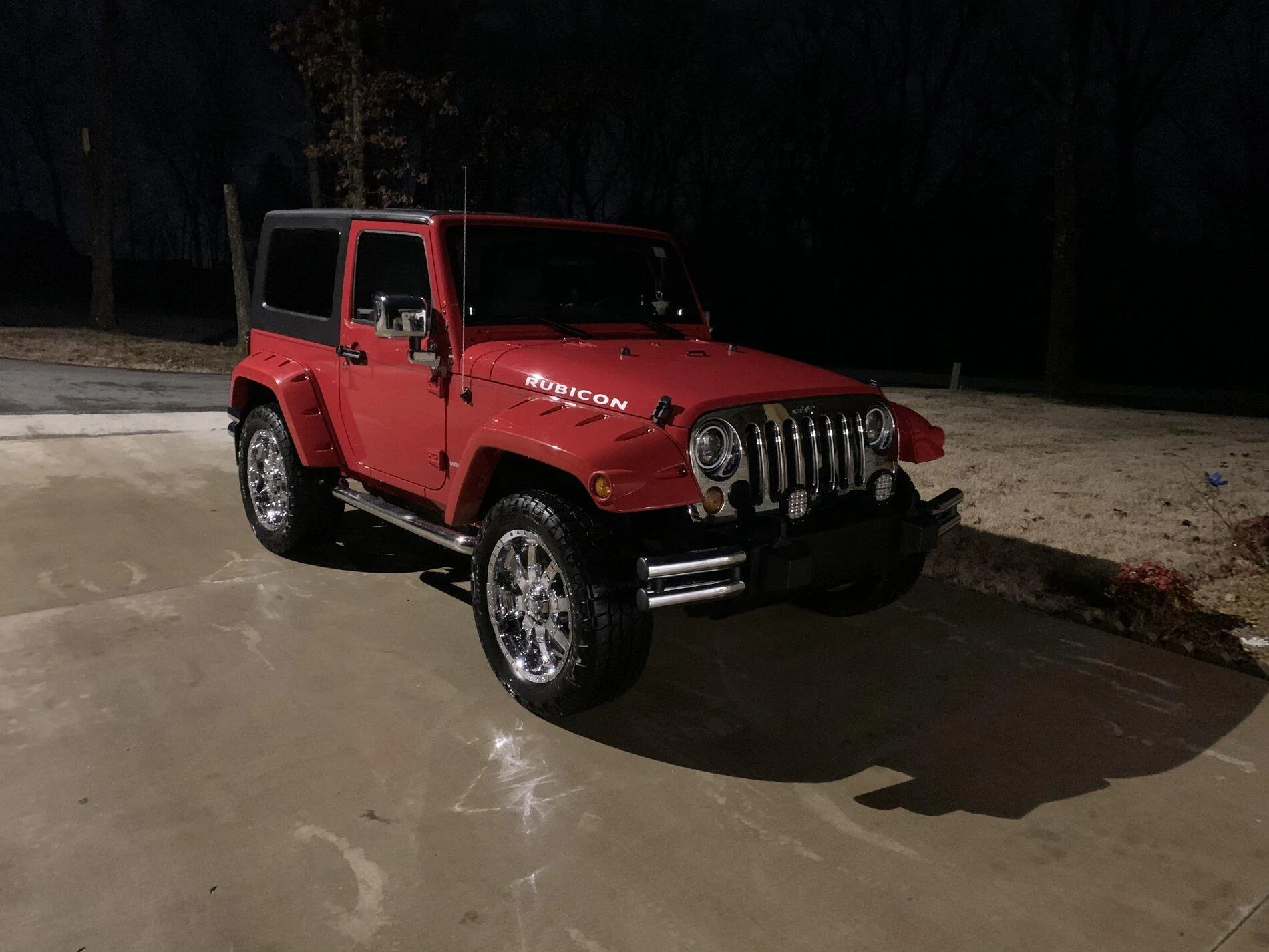

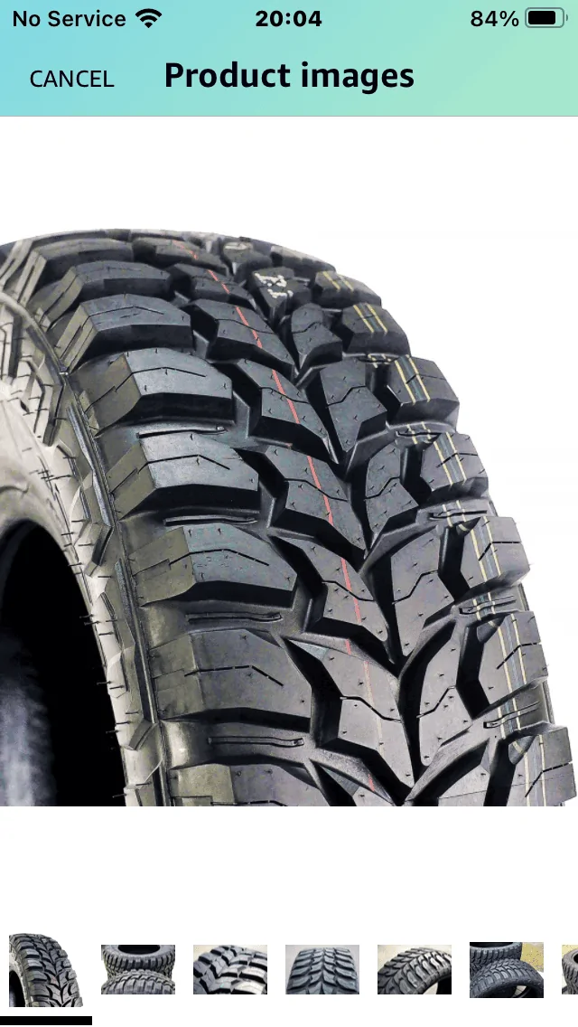

I had a similar experience with Cooper S/T Maxx’s loved them except for everything you complain about. Ended up with Crosswind M/T 6 ply tires from
Amazon and despite them being a cheaper tire they have been great! Really like the look of them too

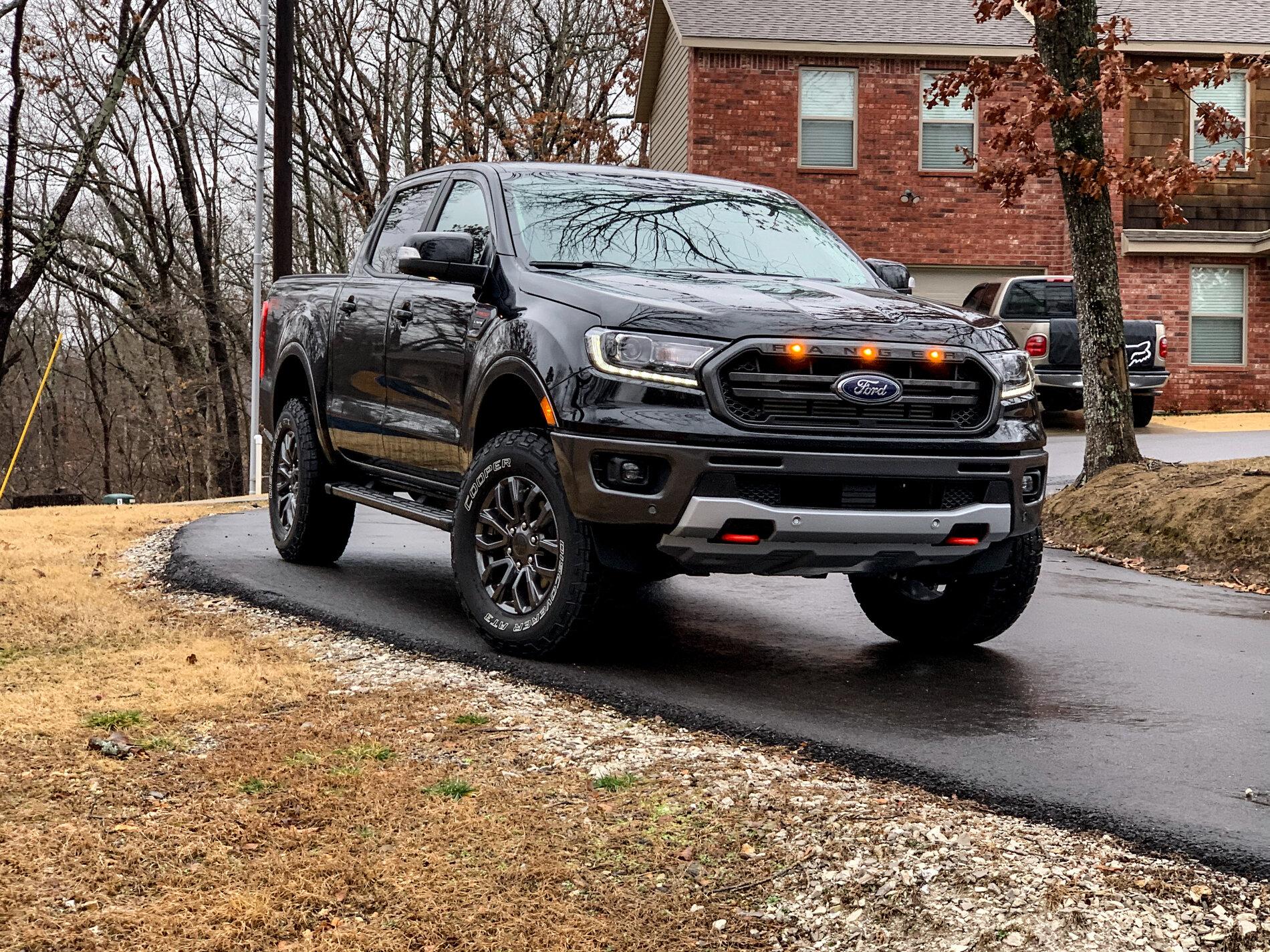

Hey guys, Im new here and i just put on 265/70/18 KO2 tires on the Ranger after my Fox 2.0 leveling kit, i think it looks good but the truck feels more sluggish, it takes longer to brake, these are E rated 10 ply so they are really heavy, now i cant return them, i only had them on for a week, do you guys think i should just stick with them? i dont want parts to wear quicker than they should, i am about to go with Perrelli Scorpion plus all terrain instead, in 265/65/18.
so i have a set of KO2 for sale local only, im in Illinois
I've said in other threads that Cooper's are now my preferred go-to tire now. I've been running a tamer version on my 2009 ram 4x4 in a 20" for years and the check off every box for me. Glad to hear others doing well with them!
