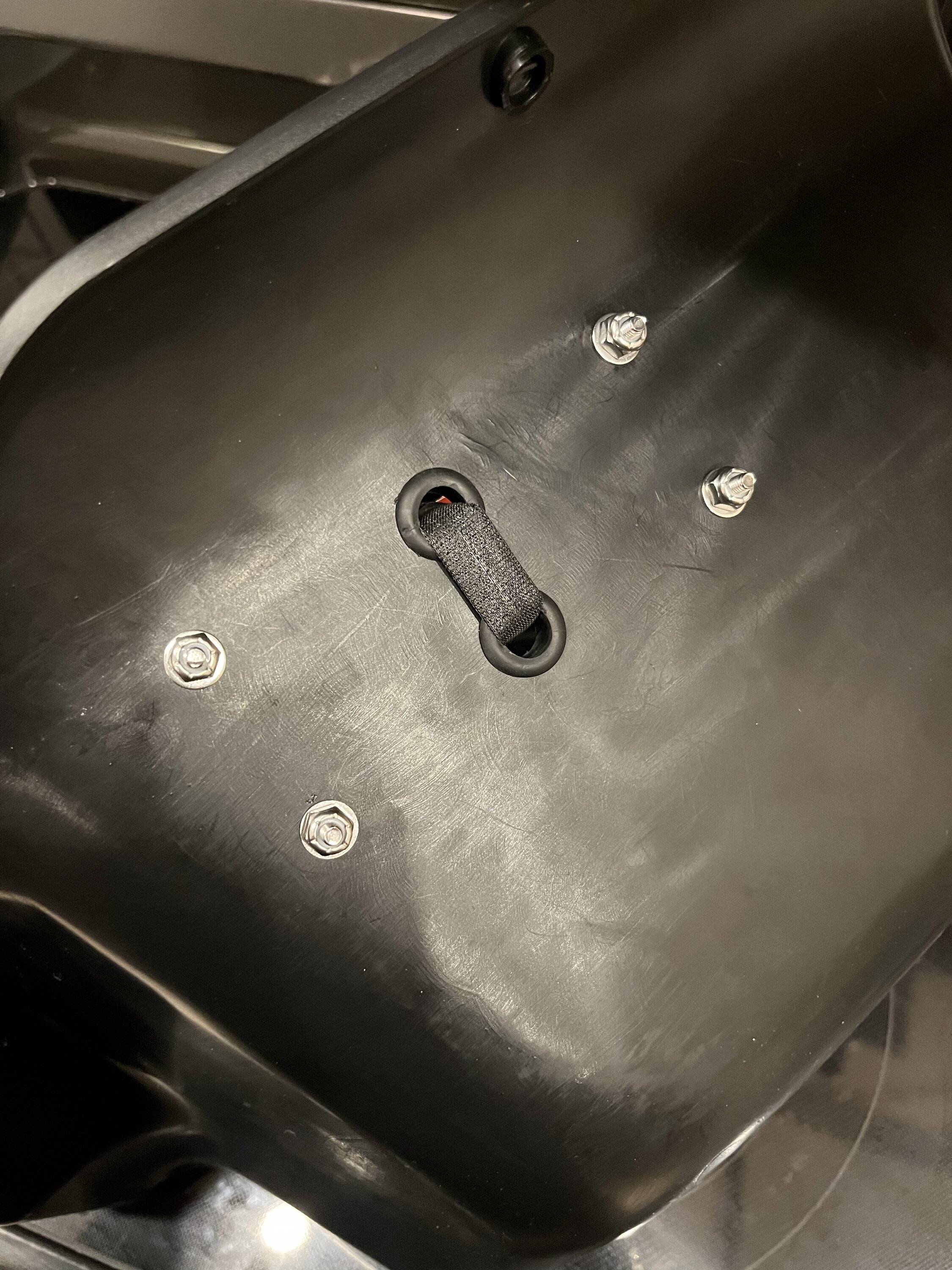

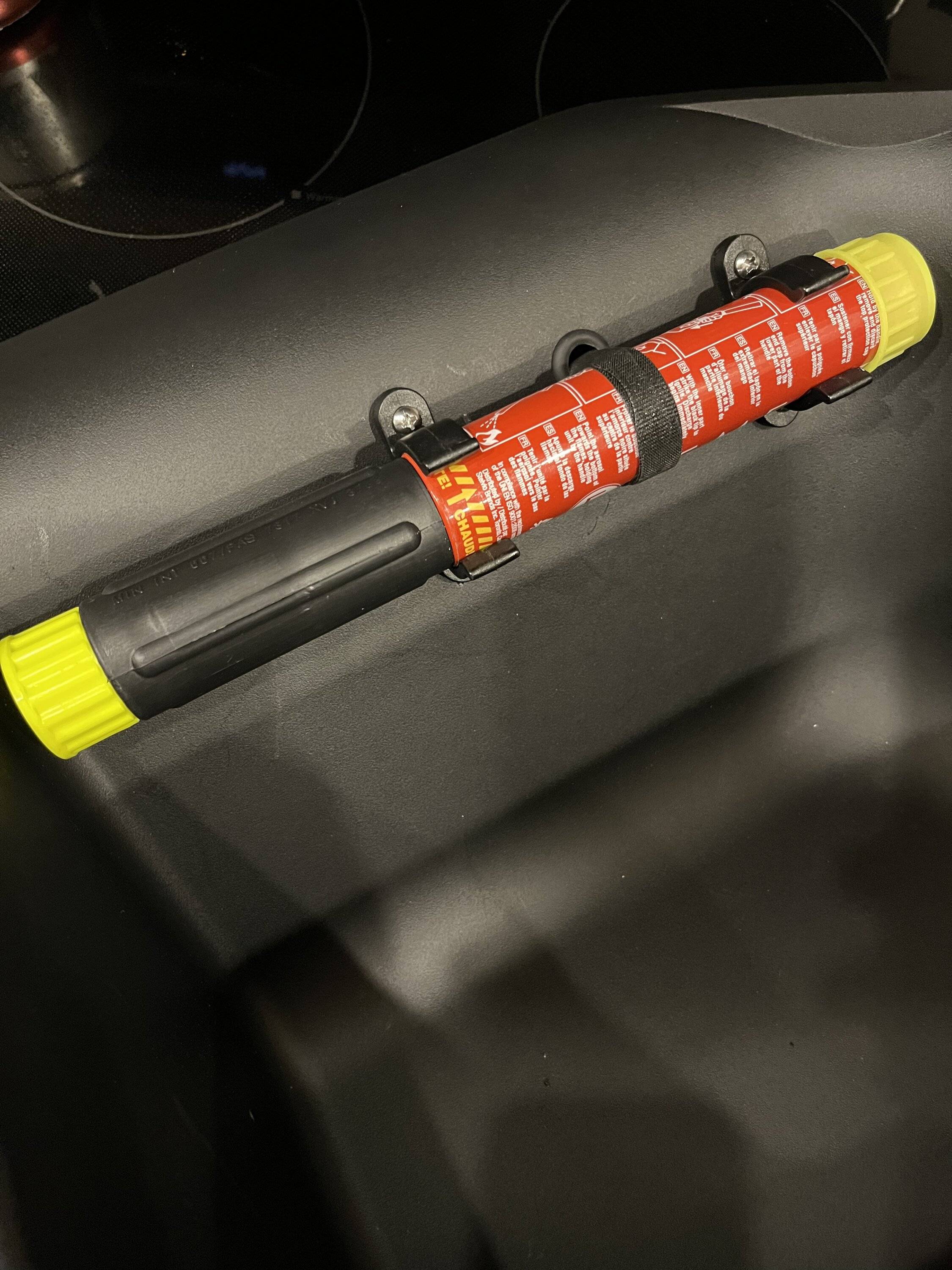

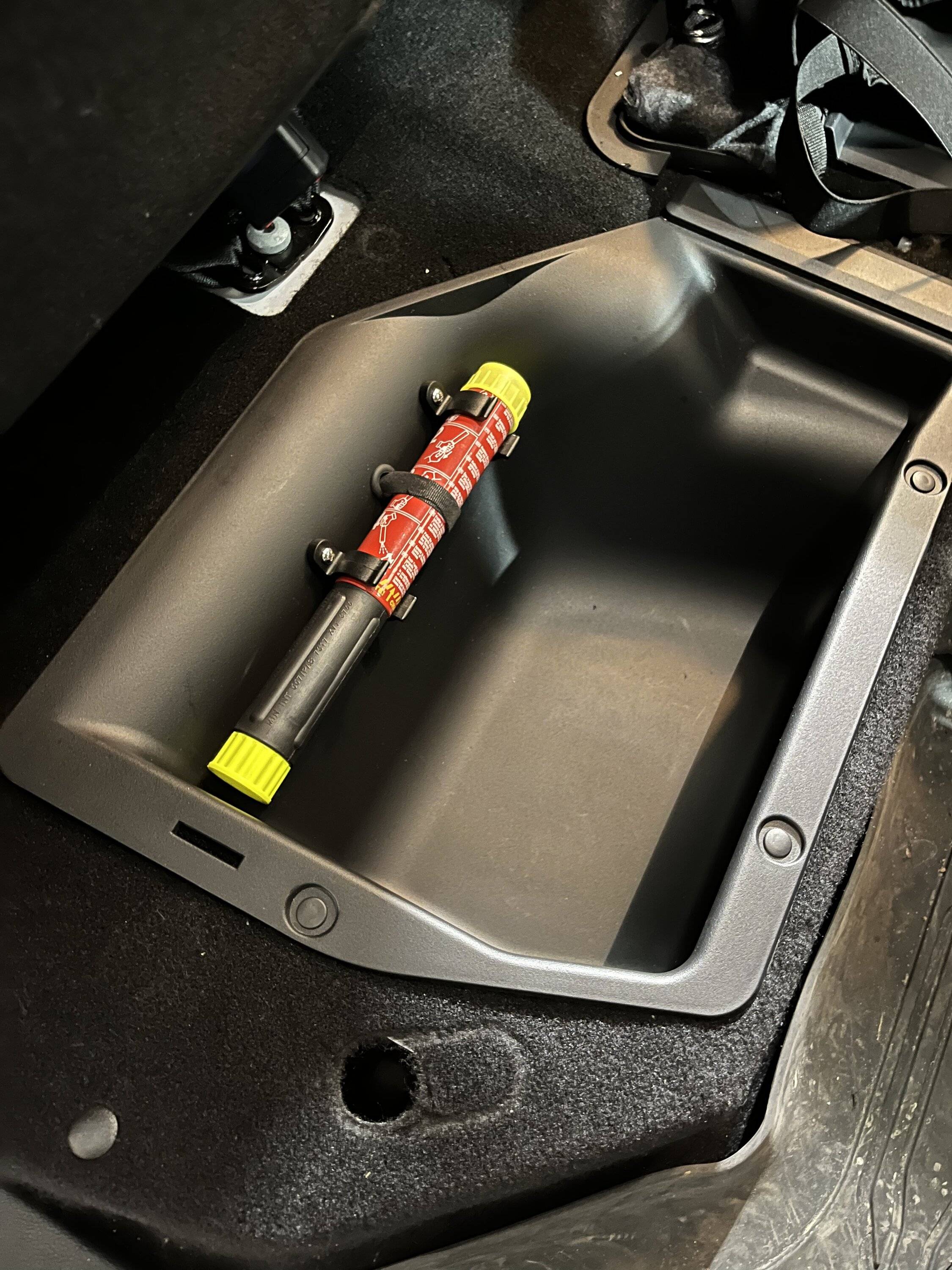

Decided that I needed a fire extinguisher a little while back. I don’t like the larger canister extinguishers because of the life-span and size which makes mounting tricky.
I went with an Element E50 extinguisher stick. These things are awesome. Last longer than a smaller canister, and do not have a shelf-life. (Solid state material) they do have some drawbacks - cost and not being able to stop it once it starts when compared to a canister. But for me the pros outweigh the cons, making it well worth it.
I ended up drilling a few holes I. The rear under seat storage compartment and mounting it under the rear passenger storage space.
Fits perfectly and is out of the way and tucked in nicely.
Bolted in with stainless steel bolts/nuts/washers. Retention strap with some rubber grommets to clean it up as well. I ended up cutting the screws shorter with a Dremel because it was hitting the body underneath. Once cut shorter it fits perfectly.
All-in-all I’m super happy with how it turned out!
Looks great! This is one really important thing to keep in your car for emergencies.
