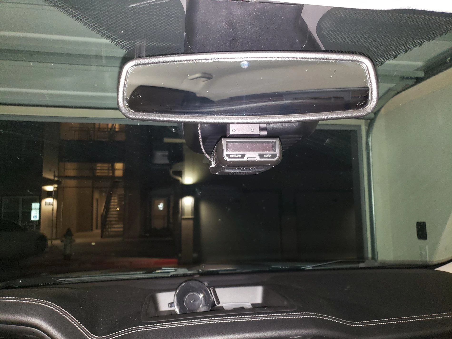

Did you ever have problems with the radar detector turning off when the truck turns off at a stop light? My valentine 1 restarts every time and it's really annoying. Was thinking of putting a capacitor on it but not sure if it will cause problems

I have not had that issue. The accessory power should remain on during Auto Start/Stop, which includes power to the camera/mirror system. Can you post a pic of your MirrorTap installation to verify you're tapped into the correct lines?
I recently had my windshield replaced by Safelite. They undid my MirrorTap. On they way out of the windshield shop, the old tech complemented my truck. :) Anyways, re-installation was no big deal, and my UnidenR3 is still saving my a$$.

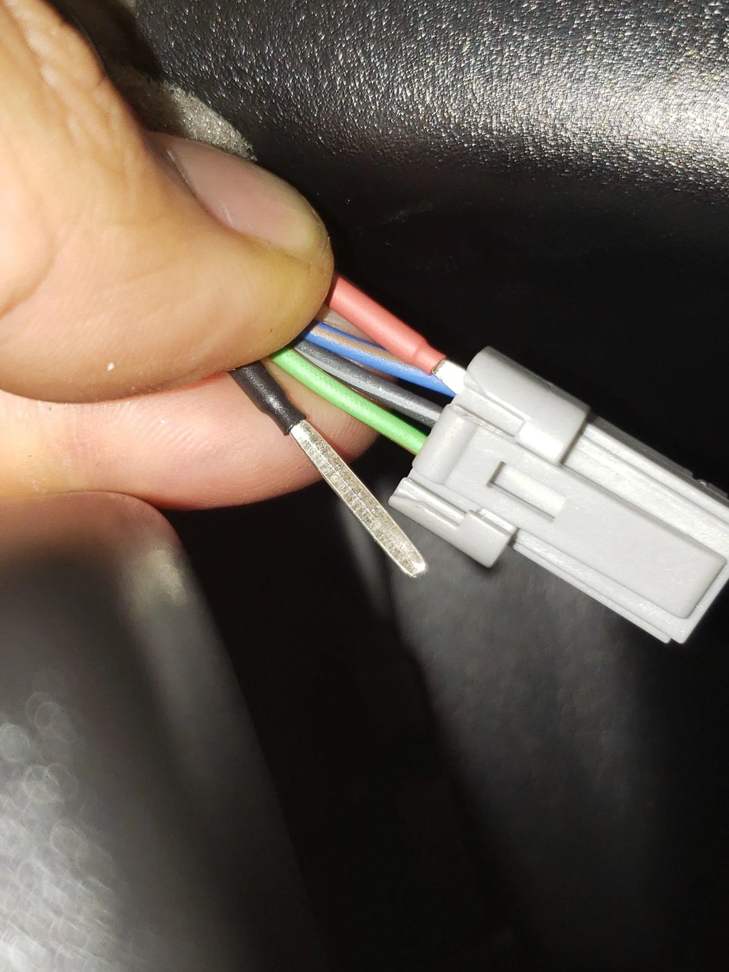

Yes I was able to confirm that it connected exactly like the pictures. Red to the blue and grey wire and black to the middle black wire. Everything looks identical but for some reason it turns off and back on only while the truck is starting after the start/stop. I haven't checked if it does it when turning the key from on to the start position (to start the truck) and back to on. I'm wondering if whatever power source the mirror is on gets cut during engine start. The radar detector also turns off if the key is on acc but the radio stays on but a previous comment says this is acc power?

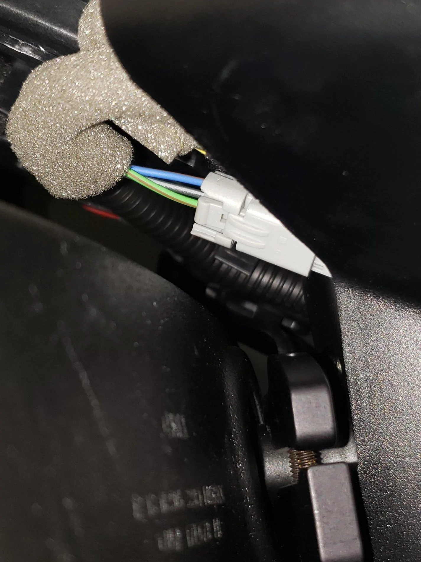

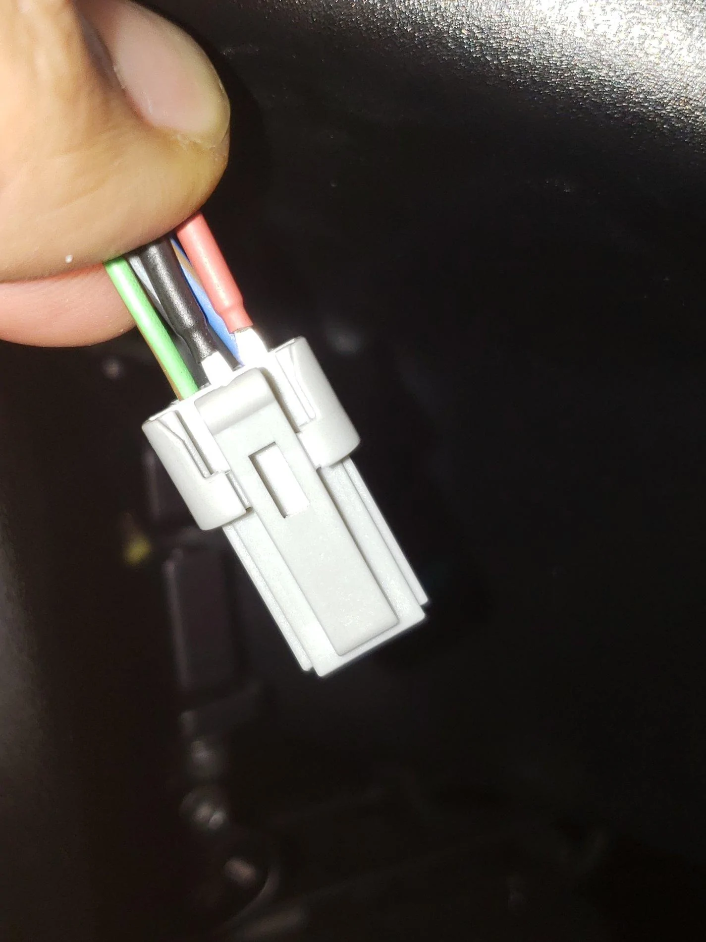

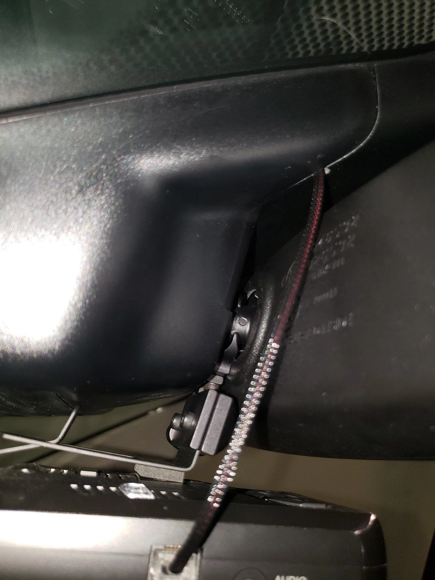

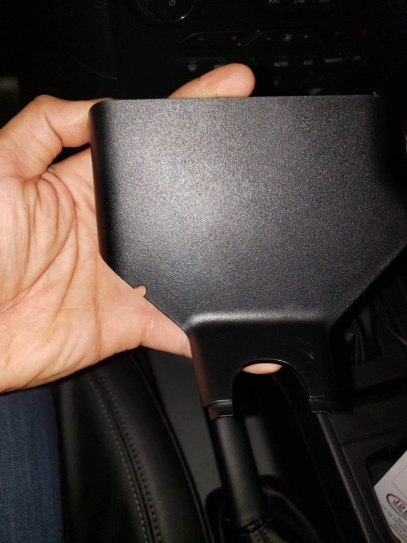

Making a new thread for this here so it doesn't get lost in the clutter.
  1. pull down firmly on the upper plastic housing surrounding the camera
  2. locate the light grey connector (w/ 3 wires) and disconnect male & female
  3. Insert positive (red) wiretap below the Blue (switchable 12V) wire
  4. Insert ground (black) wiretap below the Black (ground) wire
  5. Heat shrink your connections
  6. I used a 5/32 bit to make an opening to route my cable through the plastic housing
With so many people using dash cams these days, this should be a standard feature on all vehicles. Thanks for posting.
