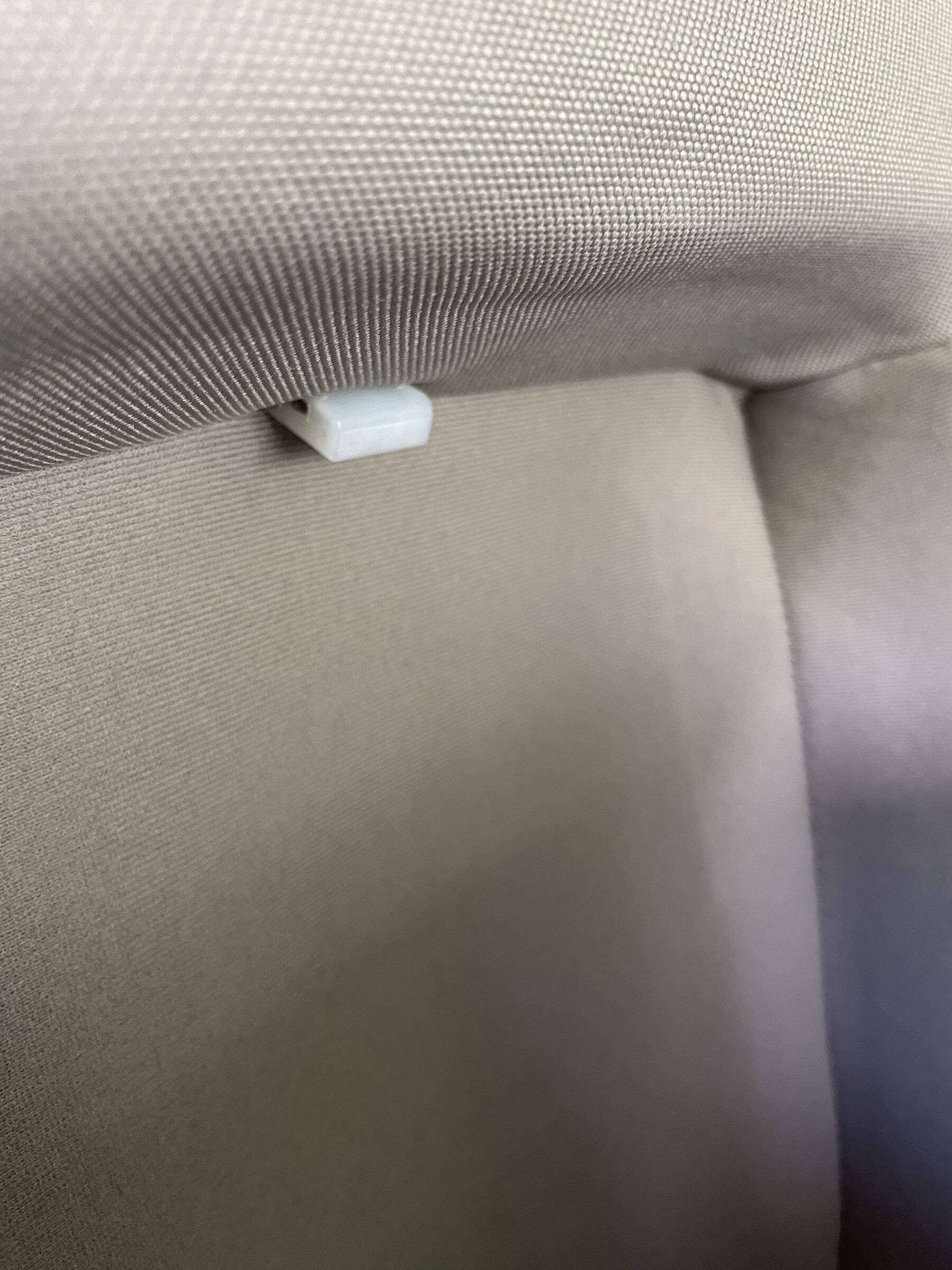

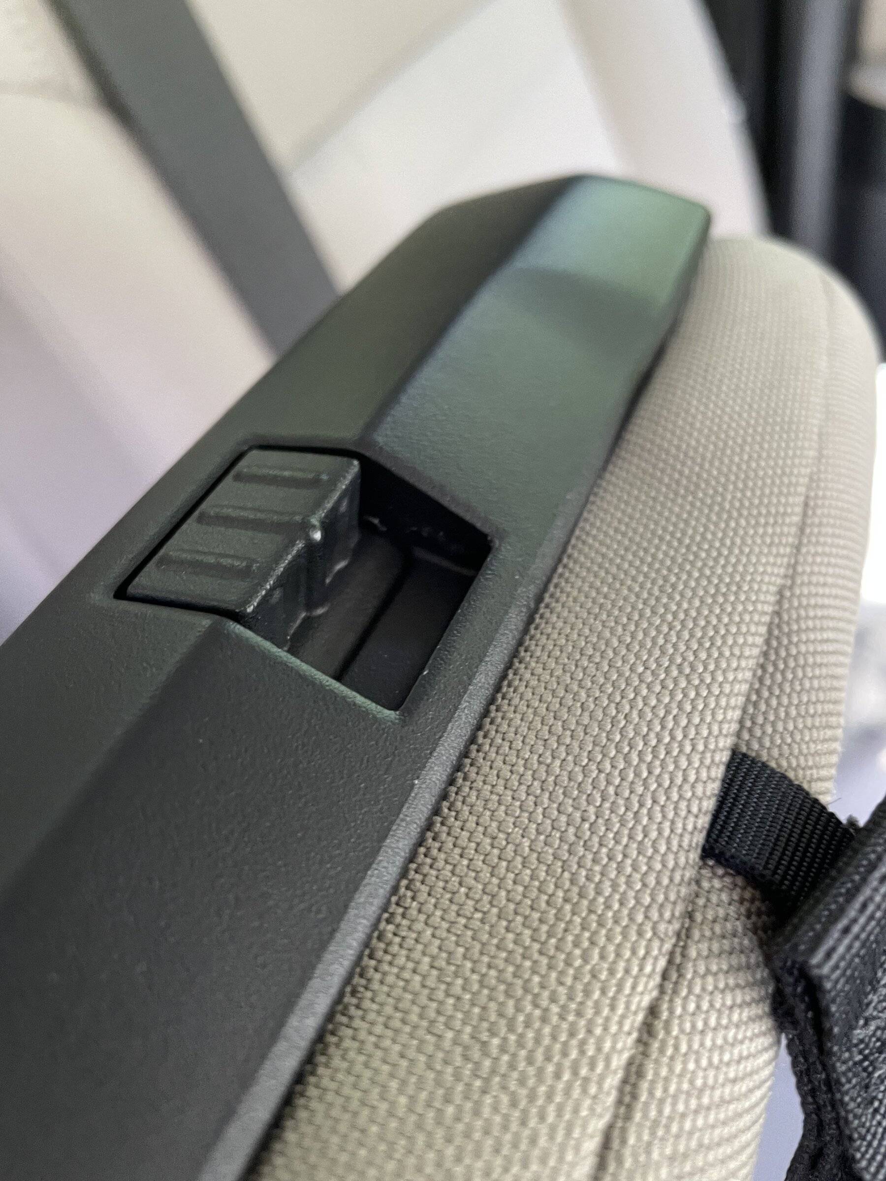

I'd push slightly inward on the armrest to release the tension on the latch, then slide a butter knife in at the top and try to depress the catch.
Edit: After thinking about it, I decided that I could hopefully do better than my armchair suggestion so I went out and grabbed a pic of the latch.
And here is the catch for it.
So the cushion is squishy enough that you can put your finger on the catch when it's closed. The latch is almost exactly the same width as the catch so you'll need something thin to push down on the side of the latch to release it.
I would think that a stiff enough feeler gauge would work.
Good Luck.

Thank you! That worked. Your picture helped a lot. Now that it's open, I see my latch is actually covered by leather. I don't think mine was really ever latching, as it has always been super easy to just pull it down. I think it got slammed closed and pushed so hard that it latched over the leather, making it a super tight fit. Lame design for sure.
