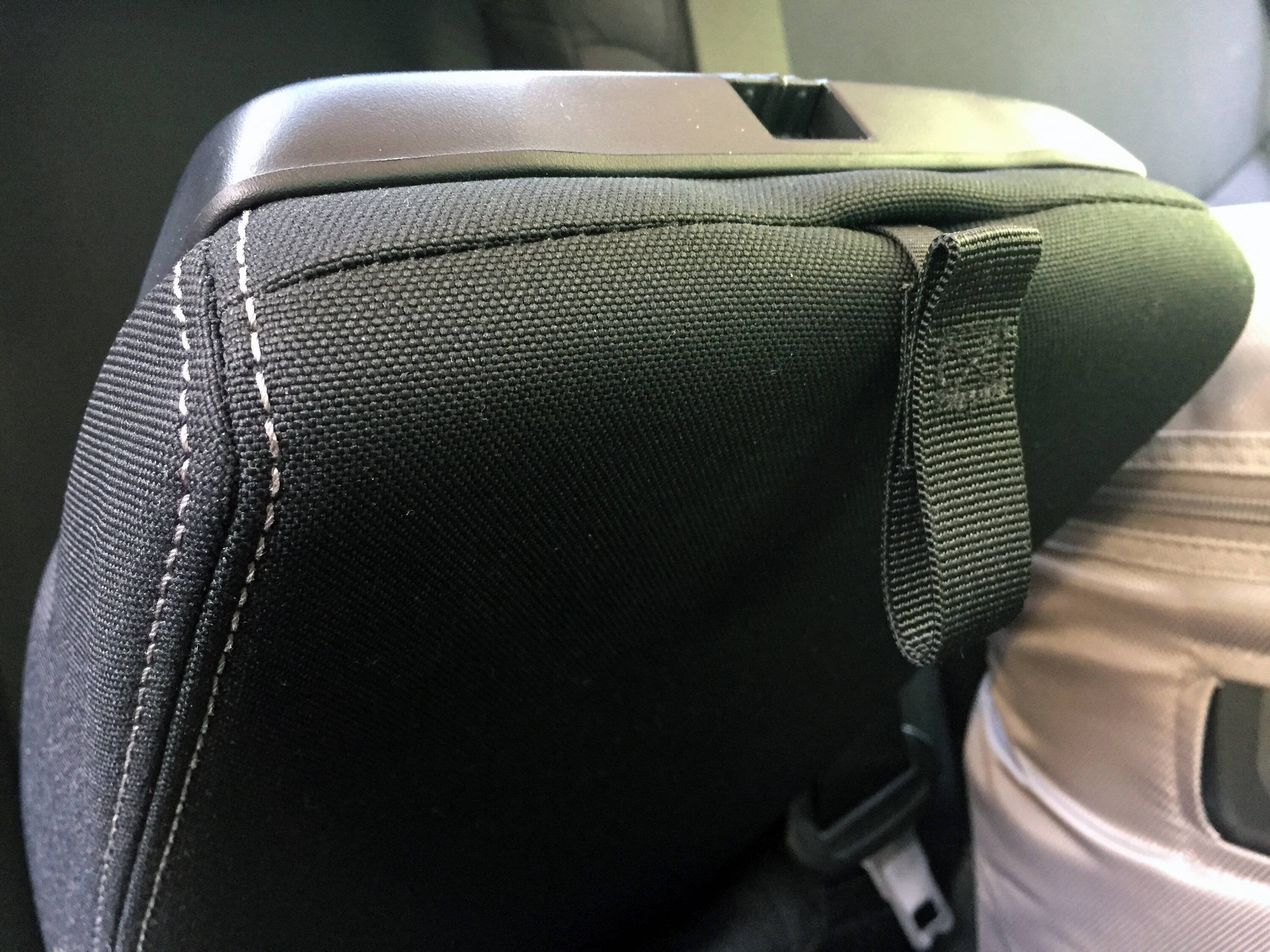

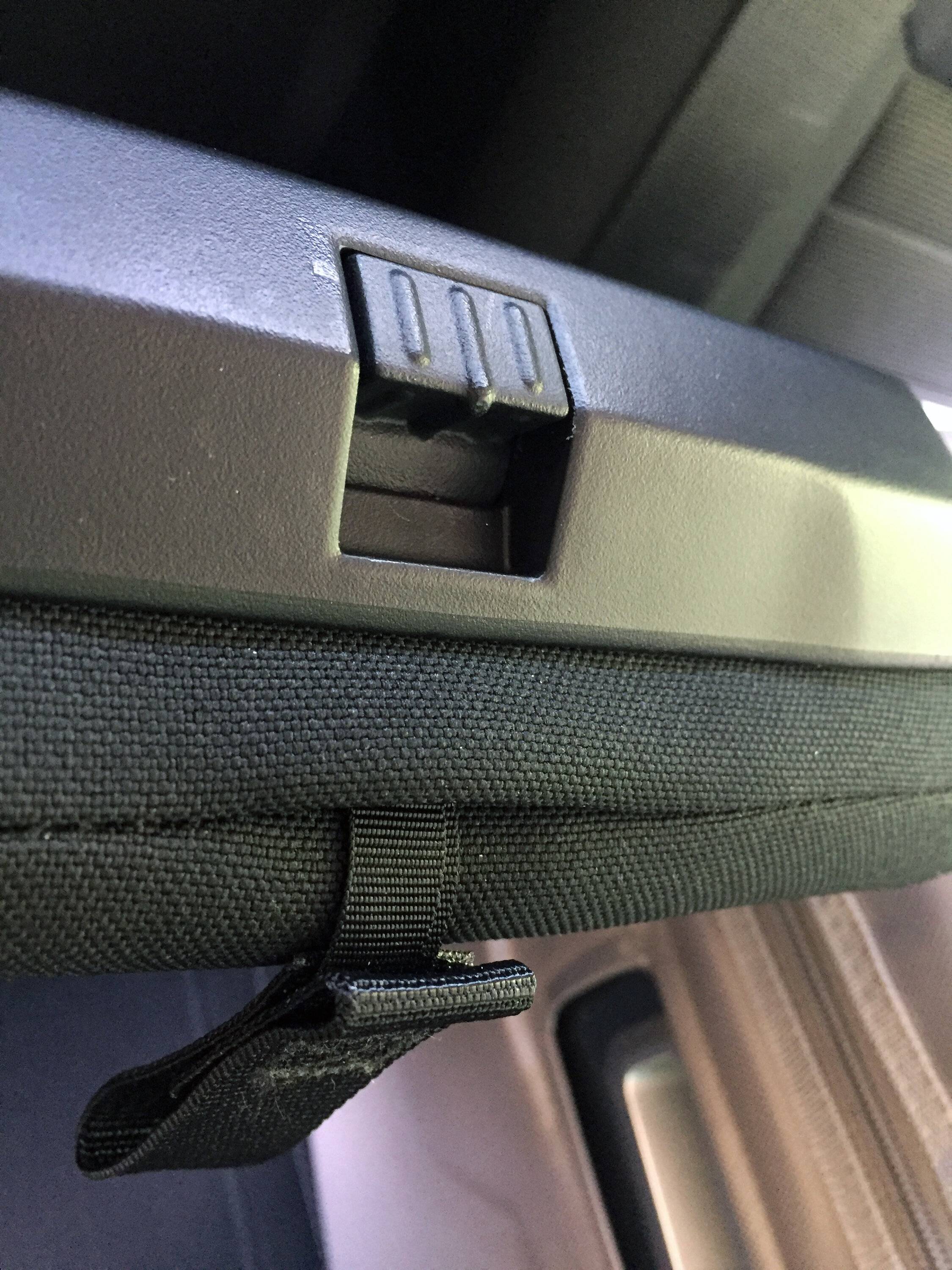

If anyone can please take a pic of how the strap is attached, would greatly be appreciated.
Others have re-attached the strap, so please share how you did that.

4 pages later and still no one's stepped up to take a pic ? ...I took the time to empty my rear seat and got the pics...not sure this helps though...
Since I'm rarely back here because my bench is filled with cargo 100% of the time, I had a tough time pulling down the arm rest...probably how Steve broke his tether...I came to realize the best release technique is to pull UP to unlock then forward...pulling forward may or may not release the latch causing unnecessary stress on the tether...

I've found if I just pull on the tether it wont release but if you pull the tether and push in slightly on the arm rest it will release easy
