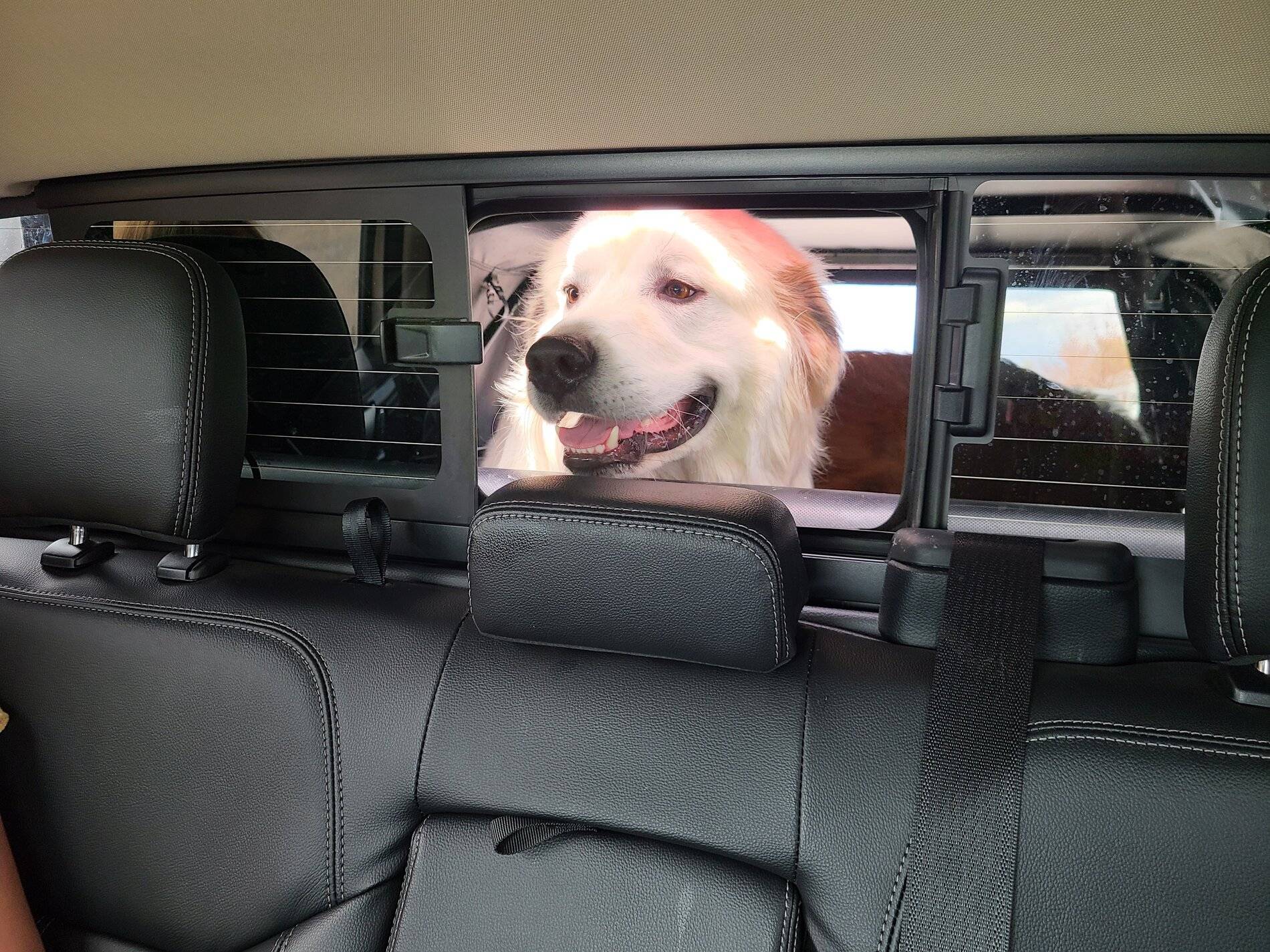

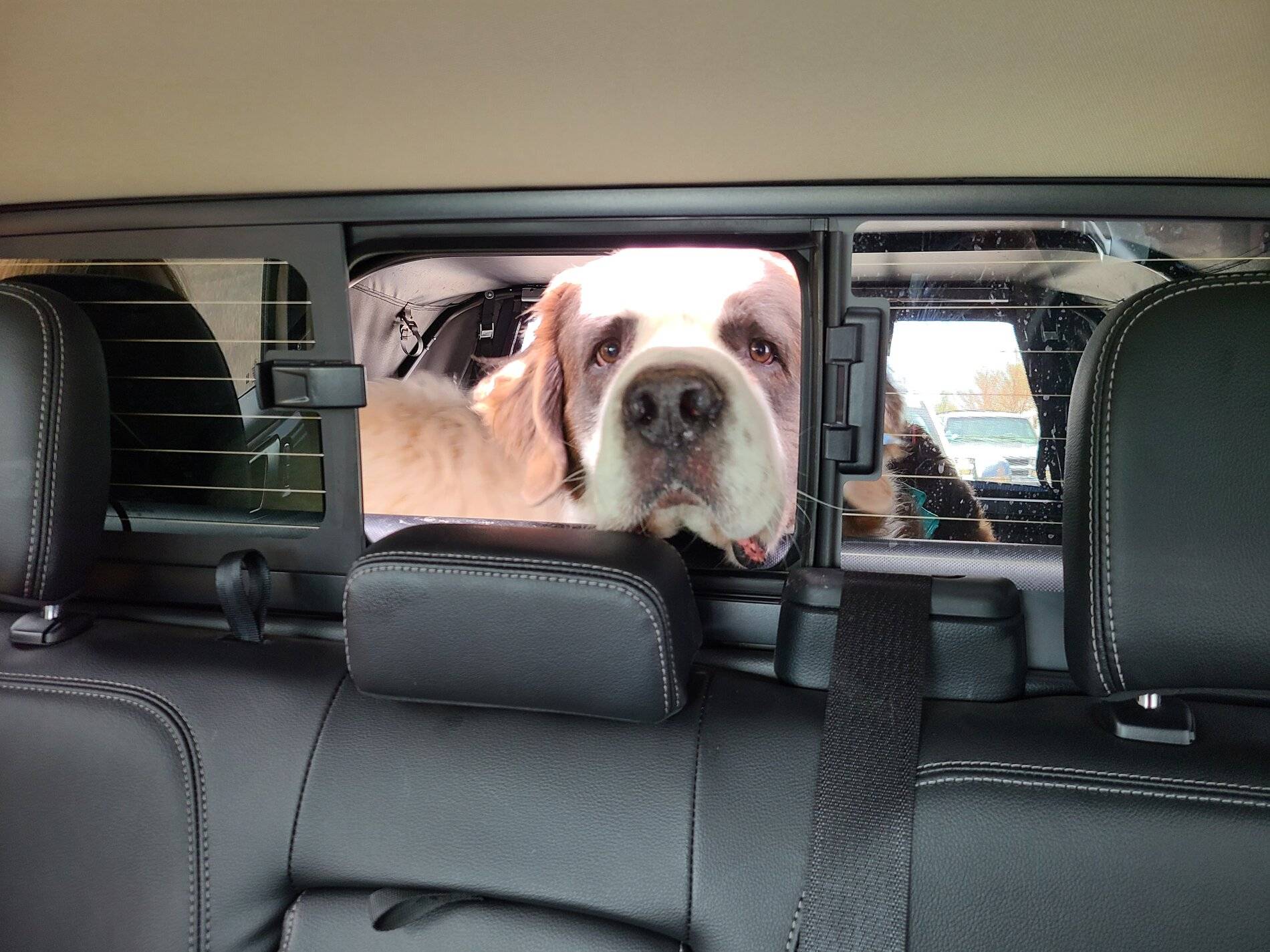

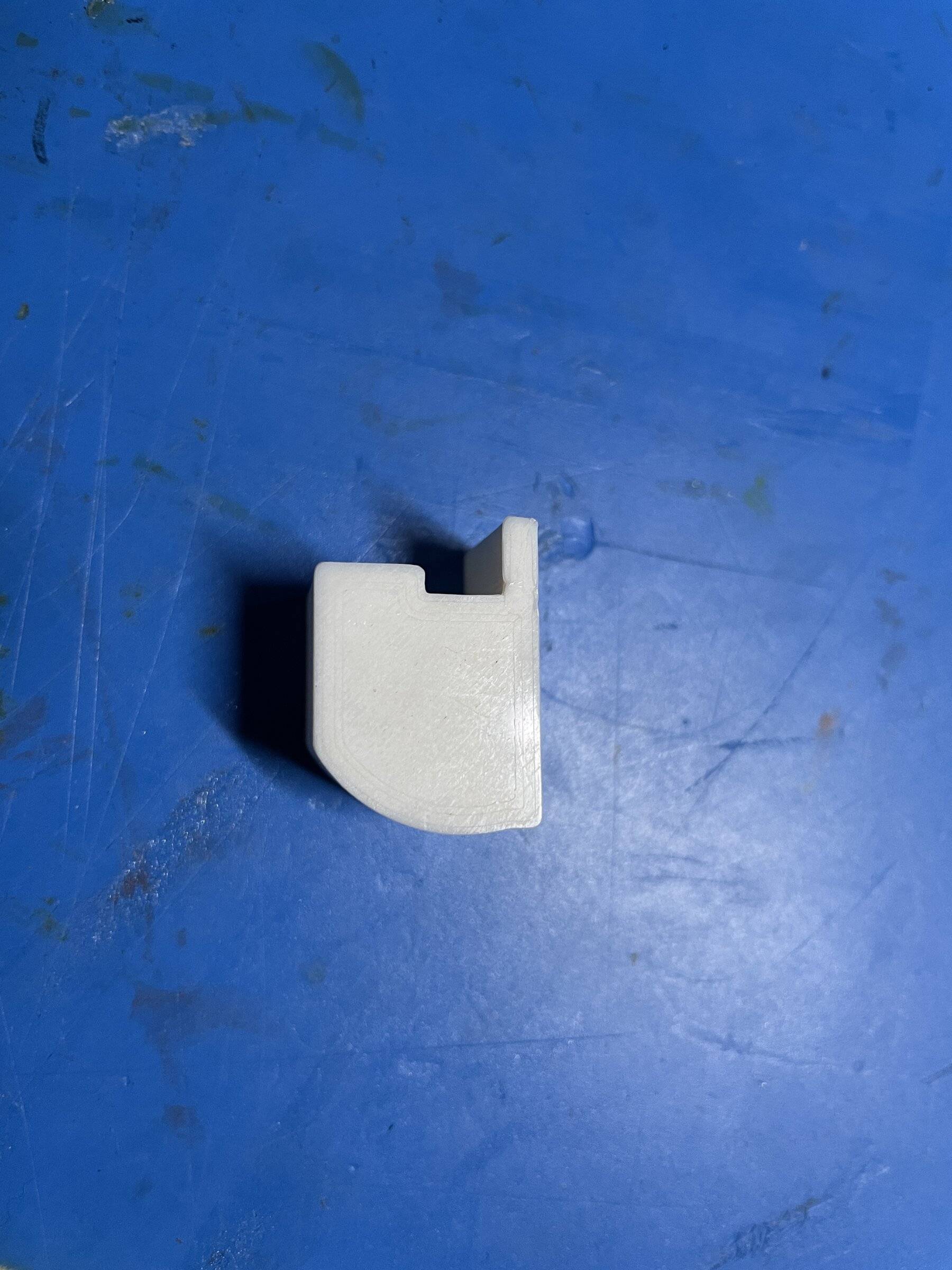

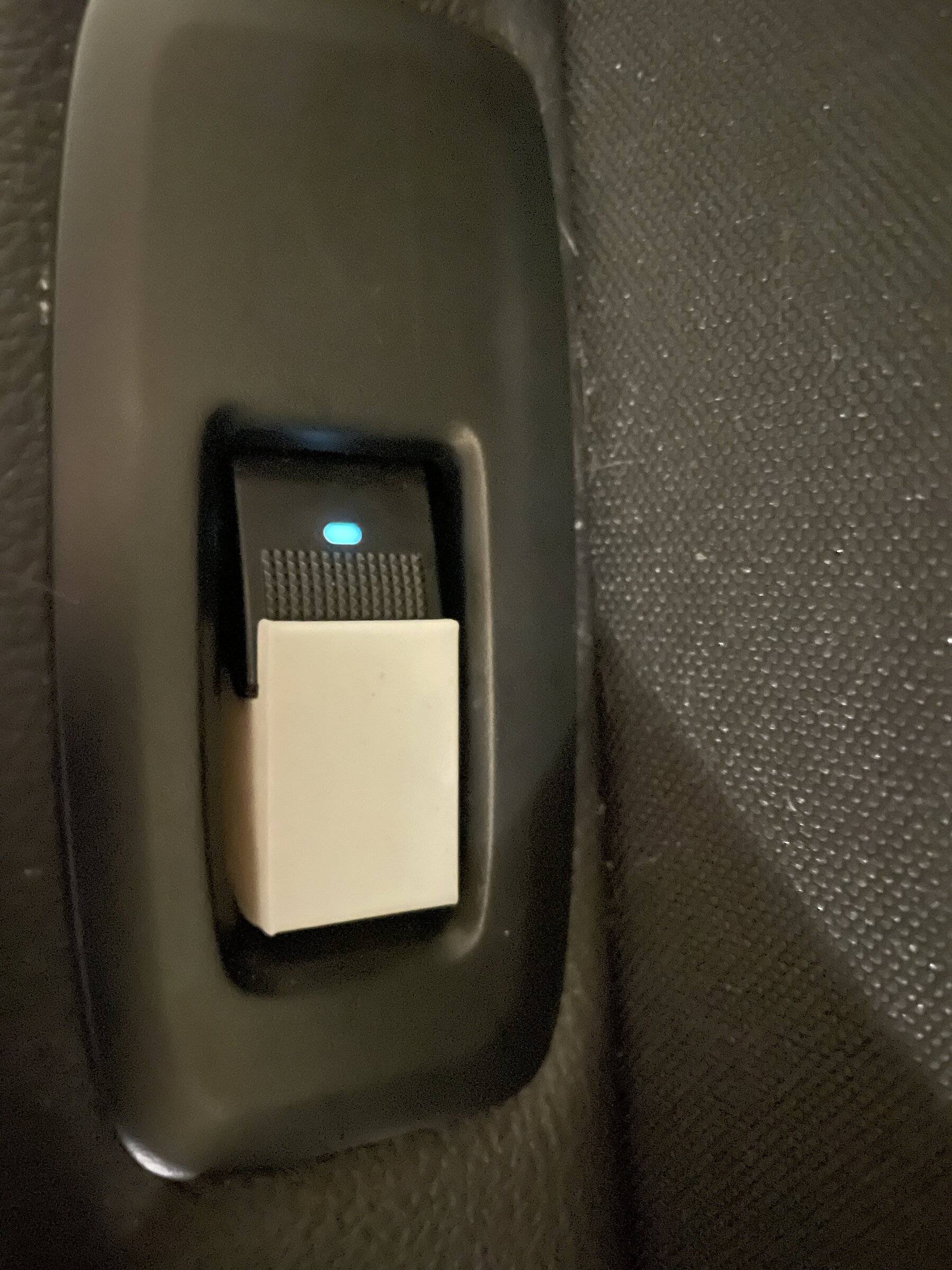

New Pup Window Guard 3000 installed!!!
They work great so far!!
Thank you Jeff!!! They could be as popular as a tailgate damper!!! ? but really!!!

Exactly!!
Maybe use a little rubber cement or something like 3M command strips to hold them in tighter than toddler fingers can pull.
That said then aren’t the toddler’s strapped in?? They shouldn’t be able to jump out of the window like my dog. My dog is not strapped in and now is not a problem. I’m really not seeing a safety problem here, just an annoyance. I get what you’re saying but you can lock out what those little fingers are doing.
I'm not worried about the toddler getting out, but them opening the window on the highway and throwing something (stuffy, sippy cup, etc.) out the window before anyone can stop it. Then I have to deal with a screaming, crying toddler and stop on the side of the highway to try to find the damn thing. There is also the safety issue of what if this all happens while I'm passing someone, and said flung item lands on someone's window & startles them causing a knee-jerk reaction? Yes, this is all a bit "worst-case scenario", but as every soldier knows "train for war, pray for peace".
