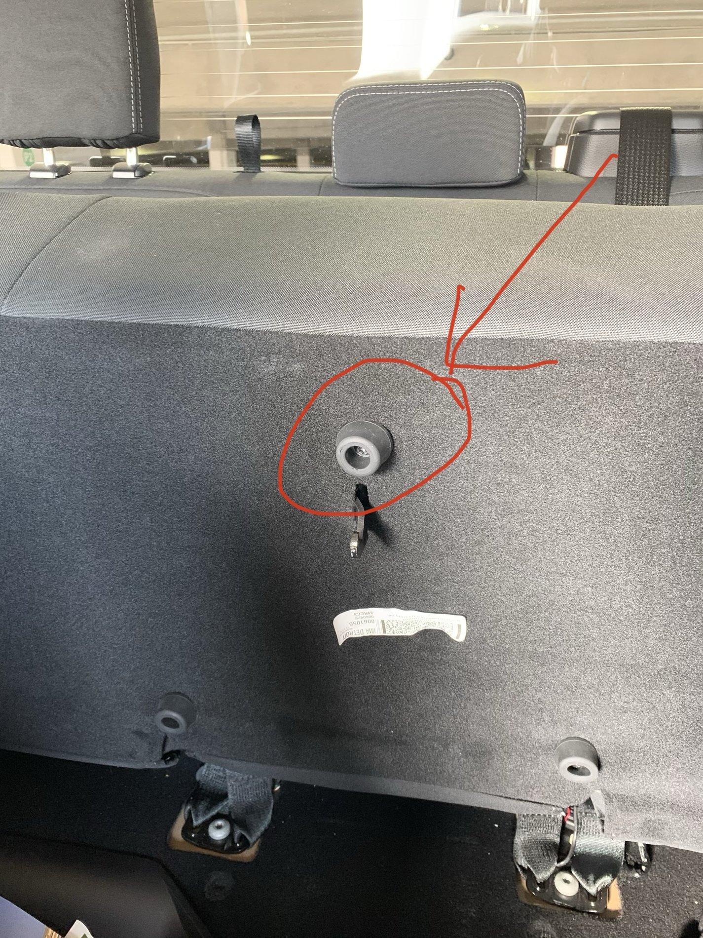

I had the same problem with the top portion of the seats. Try removing or cutting a little bit of this rubber area and I think you will be set.
As you have to pull the strap to unlock it,you have to do the same thing when you put it down.Try it ;}>
