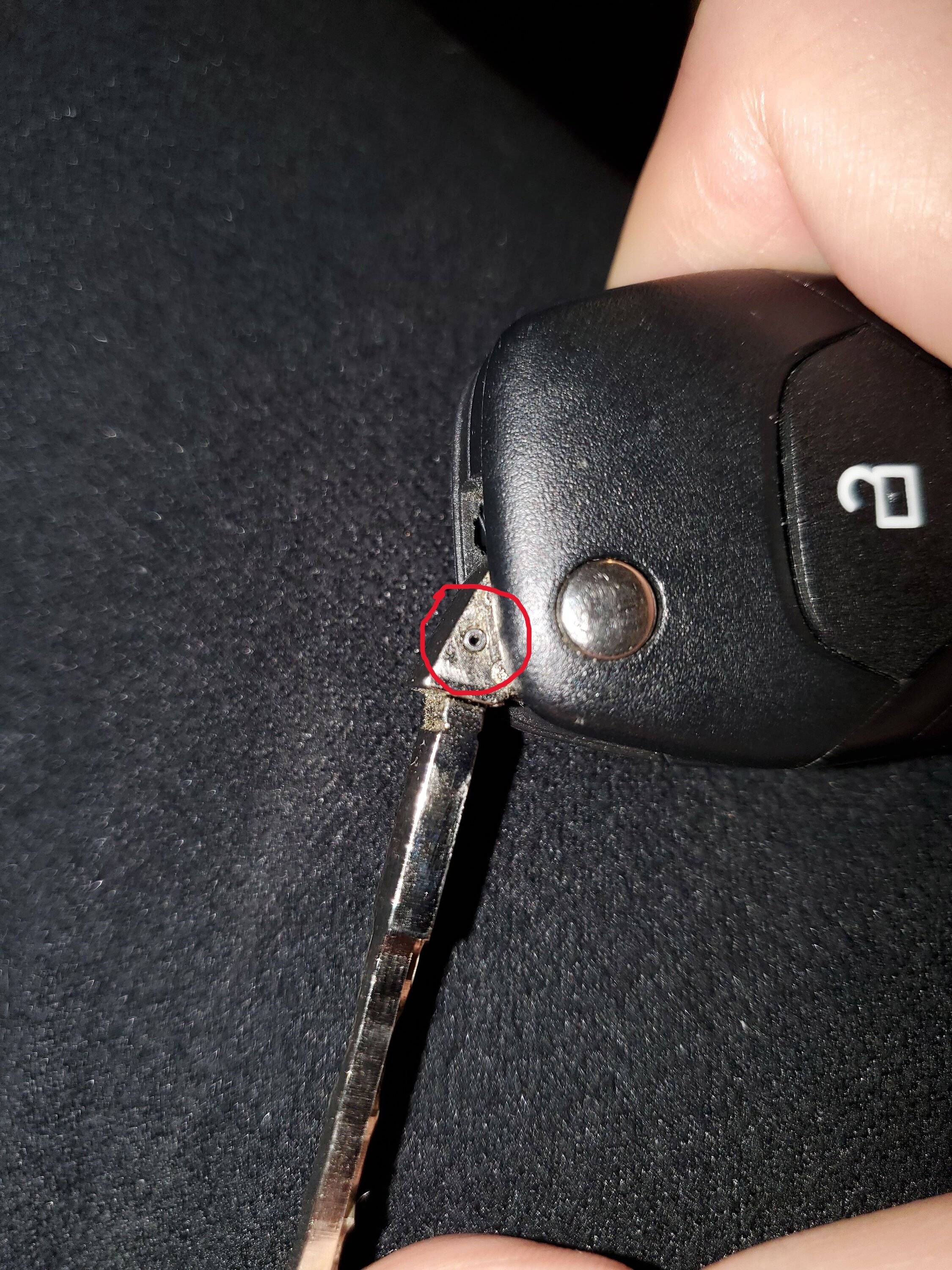

Here is the roll pin circled in Red.

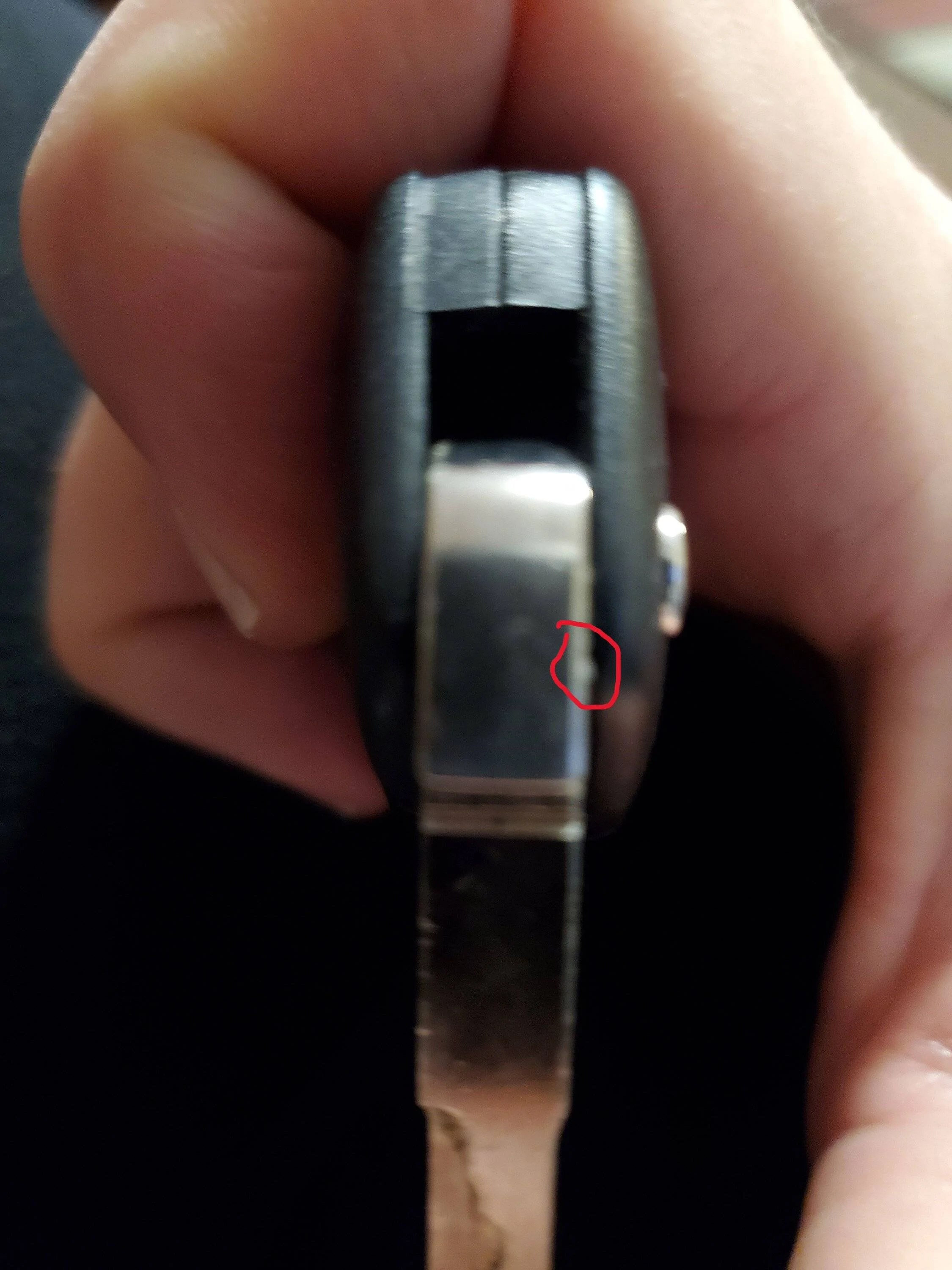

Make sure it isn't sticking too far to one side or the other. Bad picture but you can barely see mine is slightly sticking out one side.
If it's sticking out one side too far, the key won't open or close properly. Push the pin back in and put a small drop of nail polish or super glue on it without letting it open or close all the way. Let it dry and then close it and use it.
That should prevent a small problem from turning into a major catastrophe.
