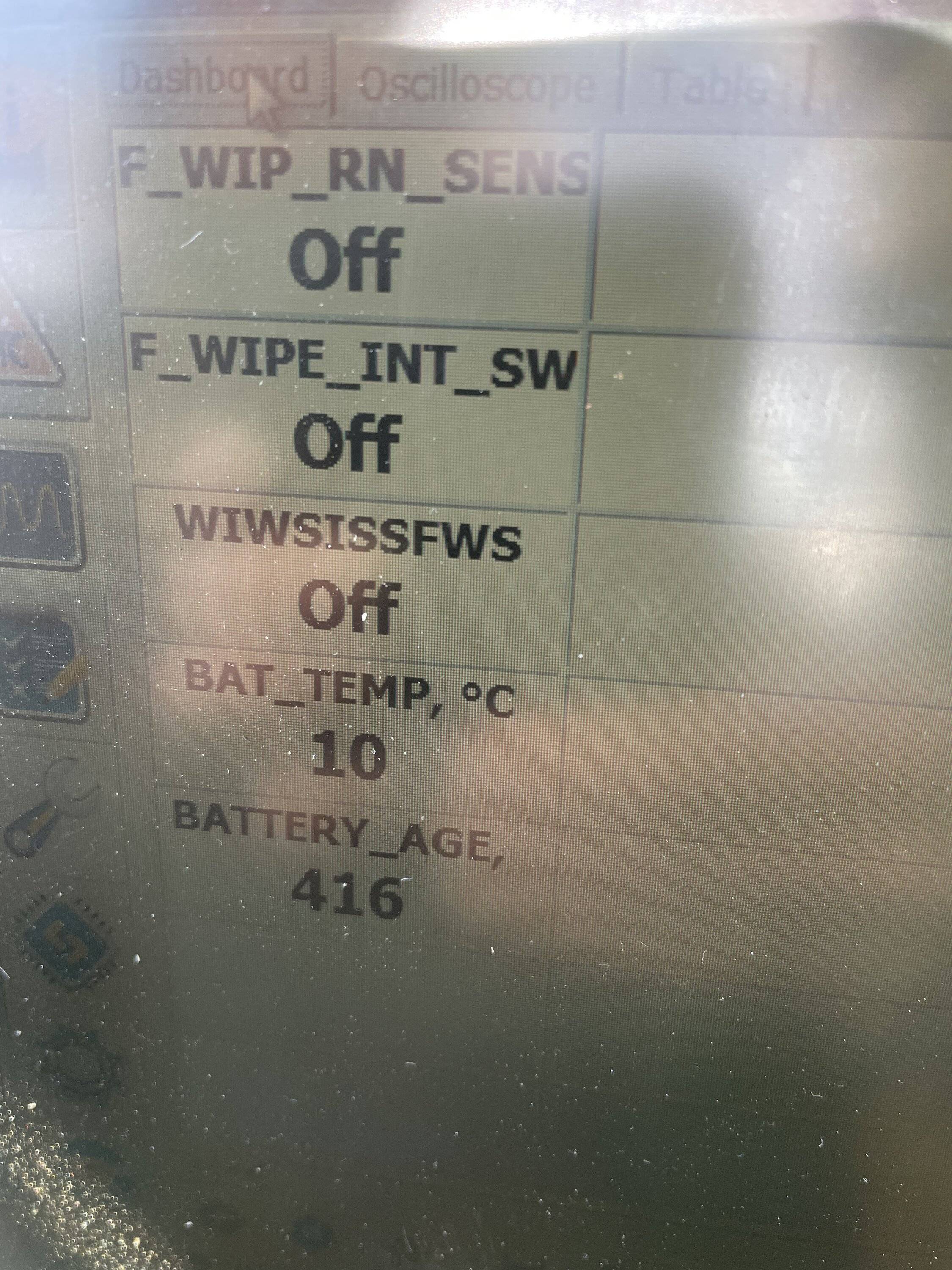

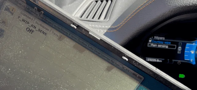

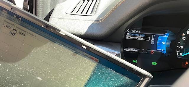

Auto wipers function is not so effective as it was last year. It’s like working somehow but not really. Mostly I control wipers manually. Have tried several setting and no difference - kind of manual work.
Got her wired and it showed me auto wipers OFF even though they were set ON on truck. Tried to set opposite and checked from PC - no change.
I don’t get it. Any ideas?

Worked perfectly last year until winter.
I got used to it and I want it back.
What I find weird Forscan shows auto wipers OFF even if they are turned ON.

Could it mean that the wipers are turned "On" and in stand by, not swiping because it's not raining, and Forescan is reading "Off" because, they aren't moving?
Got her wired again and tested with spay bottle. The answer is “no”. Nothing.
At the same time auto wipers worked like they do - not smooth but can’t say they didn’t work. Sensitivity is not good.
Live data graph also showed nothing while wipers were working.

Enabling RainSense requires a few tweaks in Forscan and a new Stalk ($70) and a rain sensor ($35). You have to wire the sensor as well, which isn't hard. 3 wires, power/ground and the sensor wire goes to a wire in the SCCM module (accessed under the steering wheel column cover).
