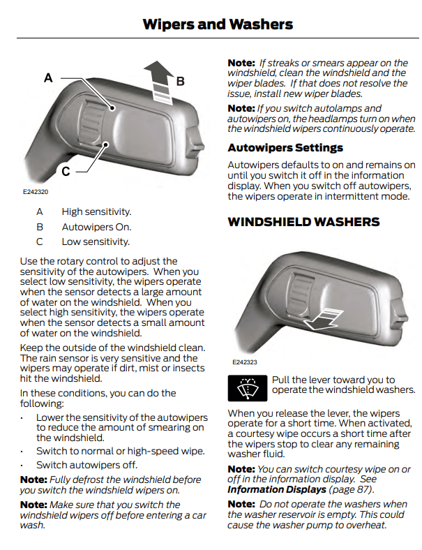

Hello,
Is there a way to turn off the wipers? Due to the vehicle's poor design, I wind up hitting the stalk when turning the wheel, activating the wipers. The wipers then stay on, no matter what I do until I turn off the vehicle. When I get back in and go again, the wipers resume right where they left off. Regardless of weather, I'm driving down the road with the wipers on like a goof. According to the manual that shipped with the vehicle, it's easy to disable automatic wipers from the vehicle settings. That's not the case. All I have under wipers is "Courtesy Wipe", (whatever that is), but no off. Do I have to pull a fuse or something?
Thanks in advance
This may help.....
