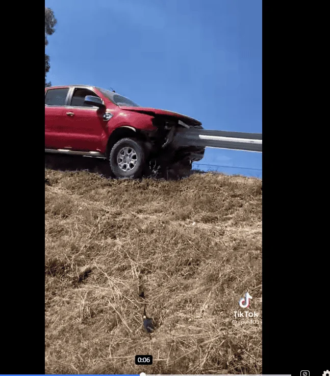

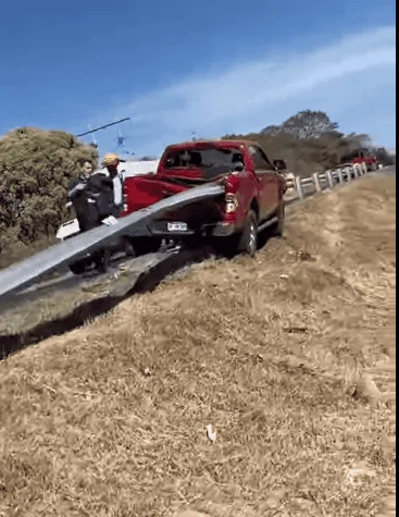

Glad you came out of your accident OK but I don't think that is the kind of impact they are designed to protect against. You had the full frontal area, bumpers, bumper braces, crumple zones to absorb an dissipate the energy. The offset test drives a wheel straight back to the firewall. I wonder if the larger heavier tires dissipate more energy than the stock tires. So many variables involved an a lot of accidents come down to luck. Crash bars didn't help this:

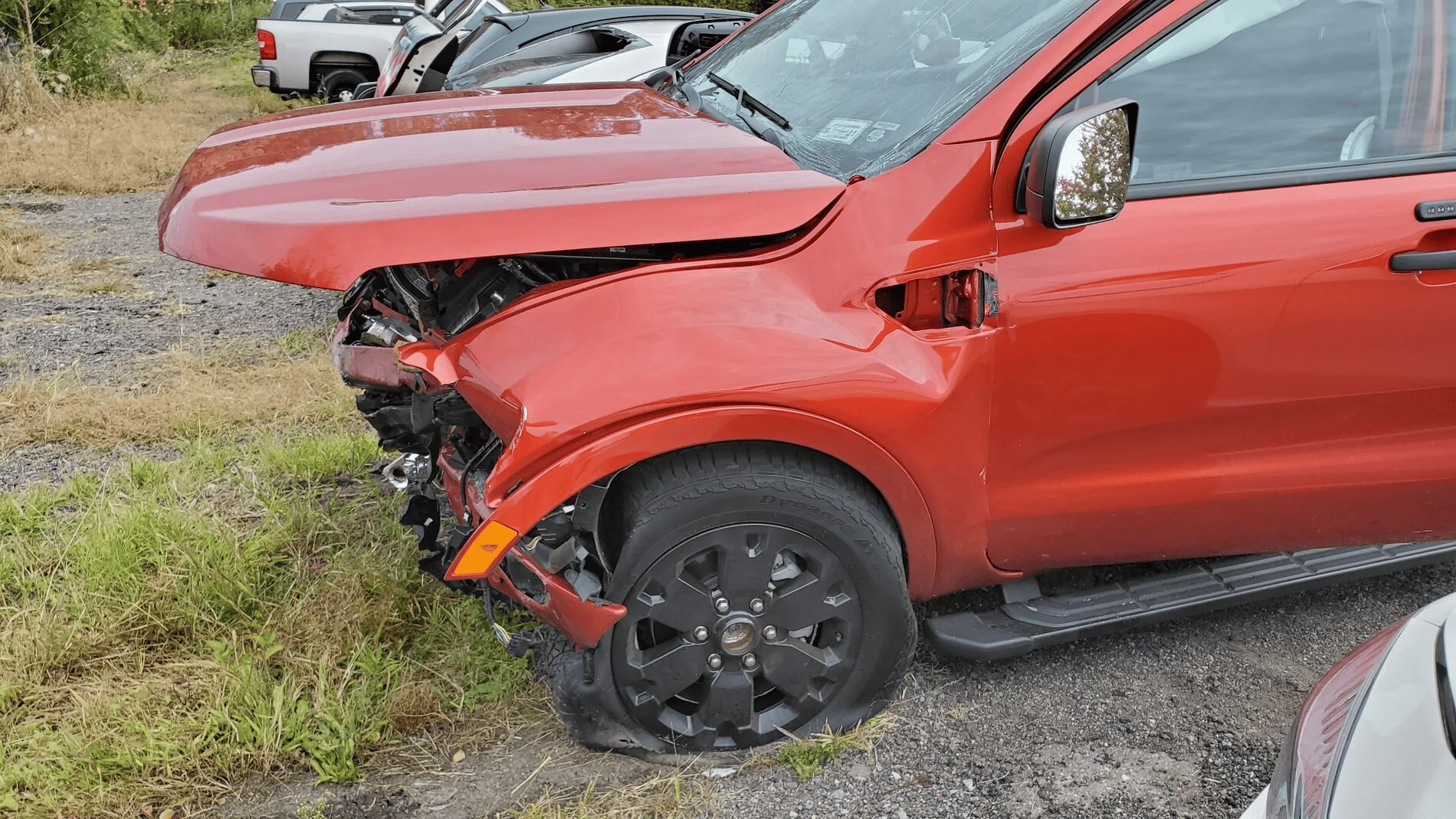

Crash bars doing what crash bars do…..
This picture is a perfect example. You can see from here that the bars did their job. Hell the tire is deflated right around the bar.
It proves the crash bars about as well as it proves the hood is stronger than the rest of the front end. ;)
The hood is hinged and it's obvious from the windshield that it flew up. Which makes sense when everything the hood latches to is gone.
Not sure where I used the word "proves," but OK.
Of course it PROVES nothing. But it is quite obvious that the bars kept the wheel/tire from encroaching into the passengers compartment in this particular instance.
It's obvious the wheels stopped, not what stopped them.
Sure, if you're not familiar with the structure behind the fender.
But we are.
What do you propose might have stopped the wheel if it wasn't the crashbar? The plastic flare? The sheet metal fender? The tire is literally deflated around the bar.
But we are.
This was not a small overlap collision with all the force on the wheel. The entire front end absorbed the crash. Full width bumpers, crumple zones, Ranger both full length frame rails fully engaged, which allows very little force to be pushed through the wheels once compressed as it was.
There isn't enough force on the wheels in this type of crash to push them into the passenger compartment. If he had hit two concrete blocks, with a 4 foot gap between them, and all the force was on the wheels, which were then stopped by the crash bars, it would be more conclusive, but still needs a base line, and control group to define efficacy.
You could run vehicles without crash bars squarely into a flat wall hundreds of times without ever causing wheel to cab intrusion.
You could run hundreds of vehicles without crash bars squarely into a flat wall hundreds of times without ever causing wheel to cab intrusion.
Sorry, but I don't buy that explanation.
If the wheel/tire was not pushed back with significant force then why has it moved? Of course the bumper absorbed some impact. But if it absorbed it all the tire would not have been moved.
So despite the fact that this was a square collision, and despite the fact that the bumper absorbed some impact the wheel/tire obviously did indeed move. And it stopped at the crashbar, even if it wasn't the crashbar that stopped it.
