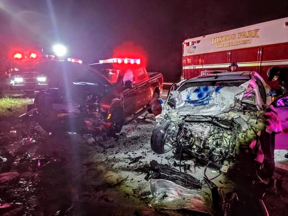

The top photo doesn't look to be enough damage to cause wheel to feet intrusion, and the bottom looks to be so catastrophic the bars would have been obliterated as is the rest of the front end.
IMO, the crash bar is only going to come in to play and make a substantial difference in a very small amount of collisions. For example anything under 50km/h differential won't be enough to break-through with or without beams, any thing above 70km/h differential would break through if beams were there. The collision also has to be the perfect amount of over lap, or the vehicle in just the right amount of yaw.
I could crash my truck at 10km/h and say look how good the crash bars worked, and another at 90km/h and blame the lack of bars. Apples and oranges, again, just my opinion.
With that said I do accept that I will probably be held liable if the unthinkable does happen, and their removal is noticed.

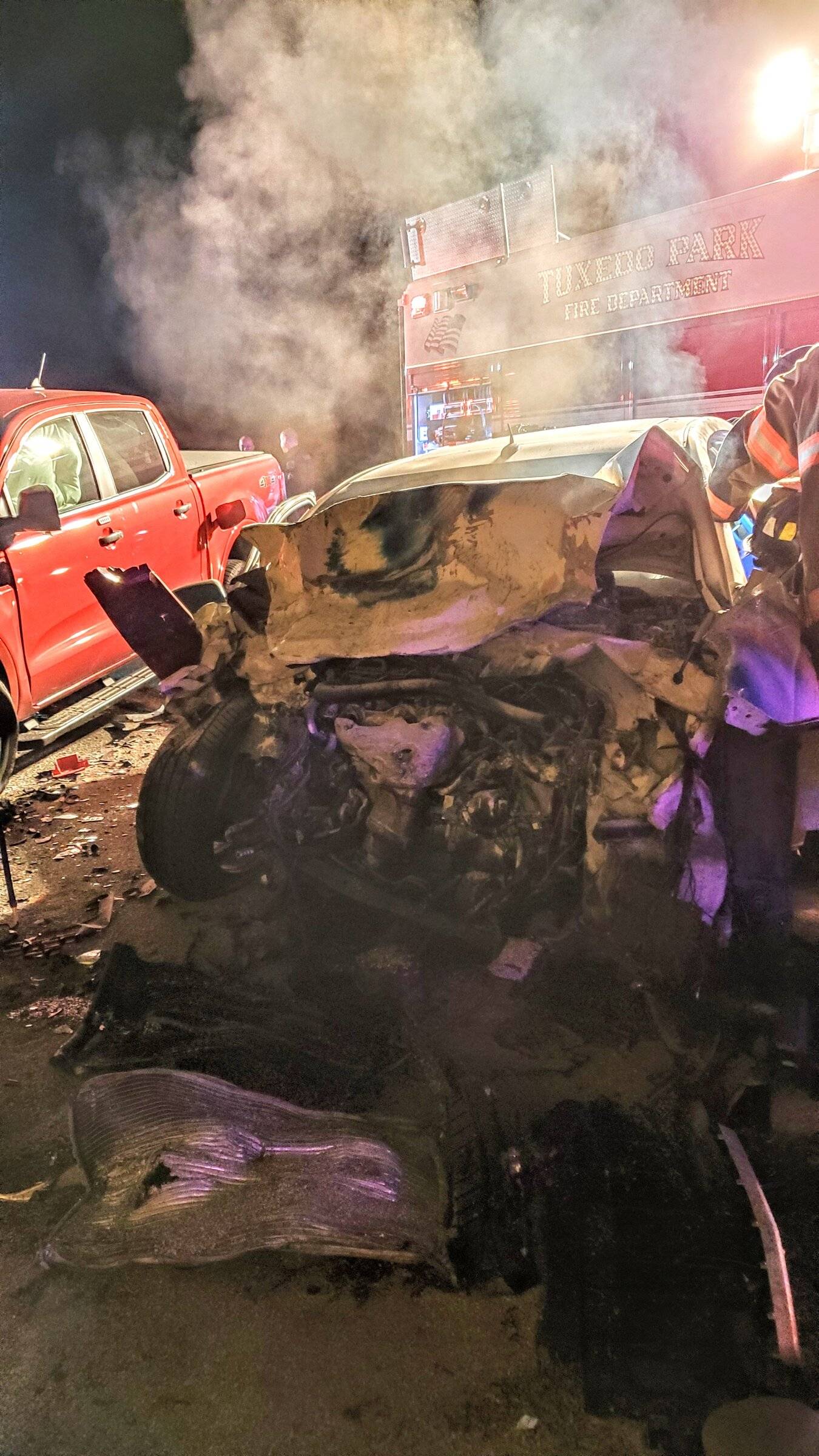

Red truck is mine. That was the result of a wrong way driver that hit me pretty square, I was traveling at 60 mph.
I think it shows the crash bars made a difference for sure, I had no injuries to my legs/feet from intrusion into the cab. The other driver, albeit in a smaller vehicle was not so lucky. Just throwing out my experience, I think any modifications you do to your truck are your business. One of my other rides is a supercharged motorcycle and one of my first mods was to remove the side reflectors because they are ugly, thus making myself less visible to other drivers. So who am I to judge. ?
I think it shows the crash bars made a difference for sure, I had no injuries to my legs/feet from intrusion into the cab. The other driver, albeit in a smaller vehicle was not so lucky. Just throwing out my experience, I think any modifications you do to your truck are your business......one of my other rides is a supercharged motorcycle and one of my first mods was to remove the side reflectors because they are ugly. So who am I to judge. ?
Happy to see you are okay, that's a nasty crash.
Agreed, I don't really care what anybody does to their ride, I don't agree with all of their mods, not everyone agrees with mine. :thumbsup:
It looks like your Ranger saved you from serious injury. I'm not removing ANY crash bars to clear tires. Because even if I chose to take the risk, my wife sure won't be so understanding if worse comes to worse. To add insult to injury is if my Insurance company denies some of my claim because I modified the safety structure of my truck!

at least the bottom pic was from a test, the speed is known. and if i recall its the standard speed used in the tests. which isnt crazy.
Yup. Top photo is Marks@SICKQK real world crash at speeds of 60 mph +/-, versus the standard off set crash test by NHTSA of 35 mph.

Yup. Top photo is Marks@SICKQK real world crash at speeds of 60 mph +/-, versus the standard off set crash test by IHTSA of 35 mph.
Yes, 60mph with both vehicles full impact protections systems in play. Full width bumpers, crumple zones, Ranger both full length frame rails fully engaged, which allows very little force to be pushed through the wheels once compressed as it was. The other is 35mph, completely missing the long frame rails, and only engaged with lateral add-on supports, allowing full impact in line with the wheel, which by design is not fully rigid. It's evidence and worth consideration, but neither tells the full story.
