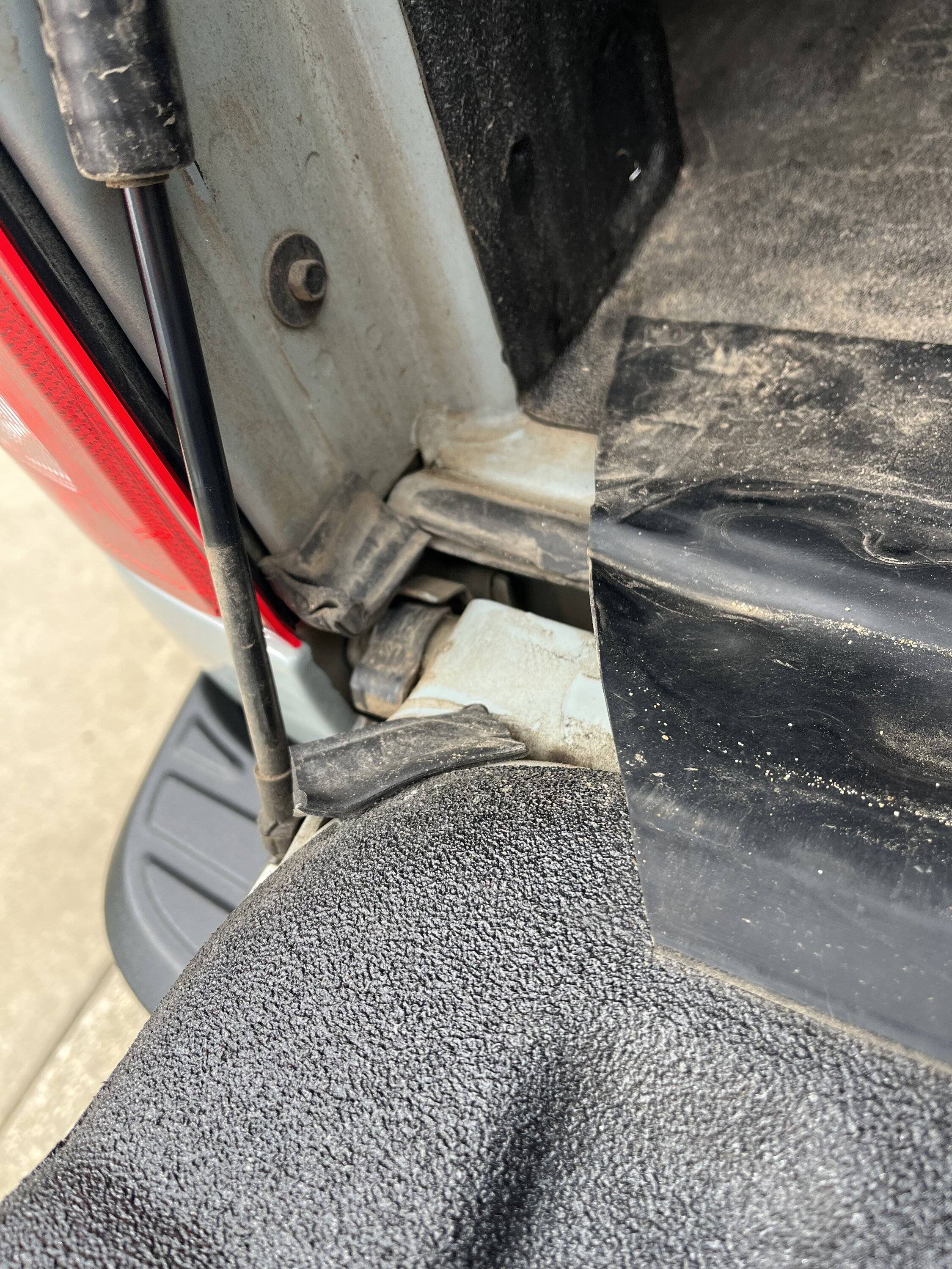

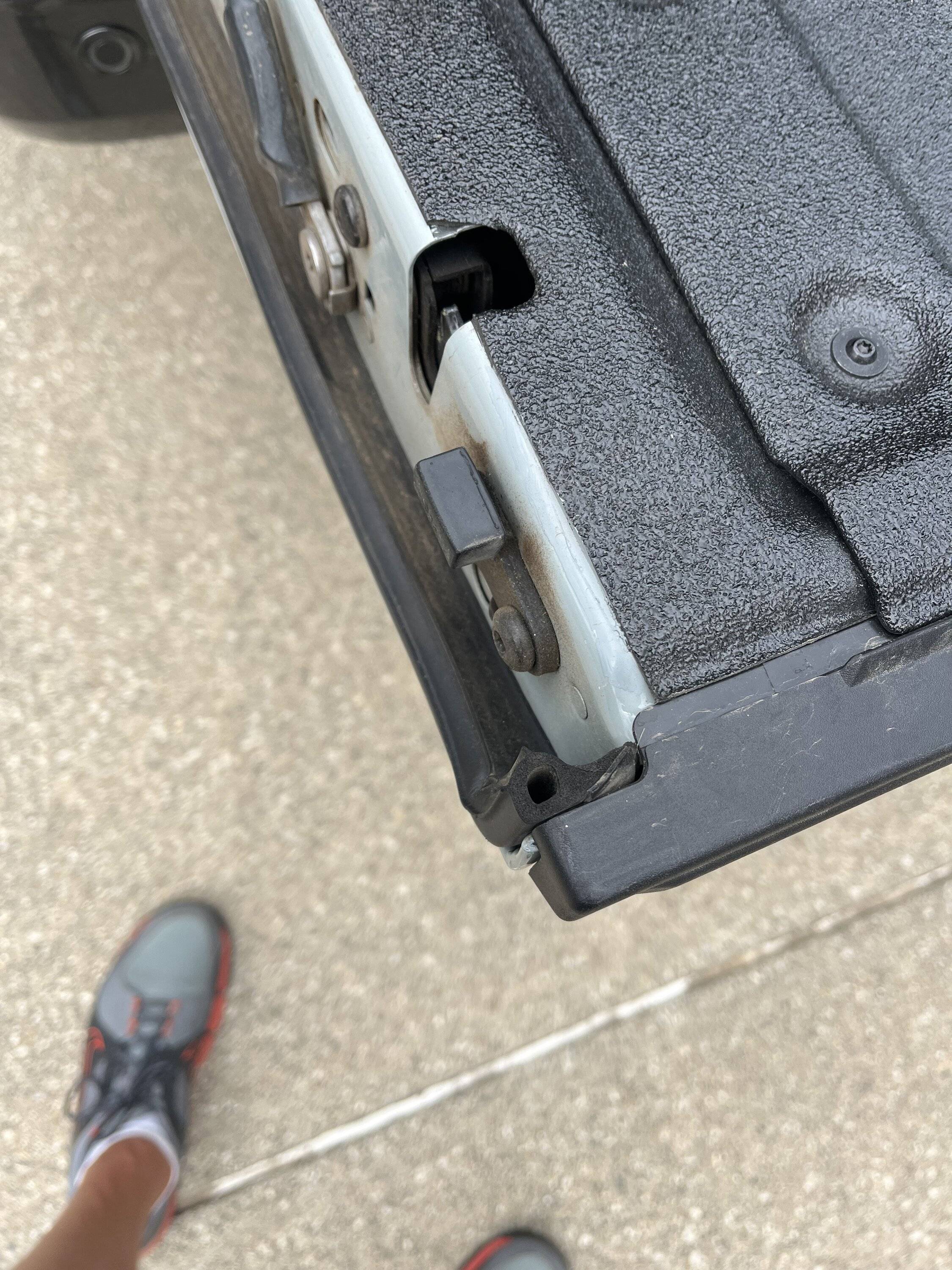

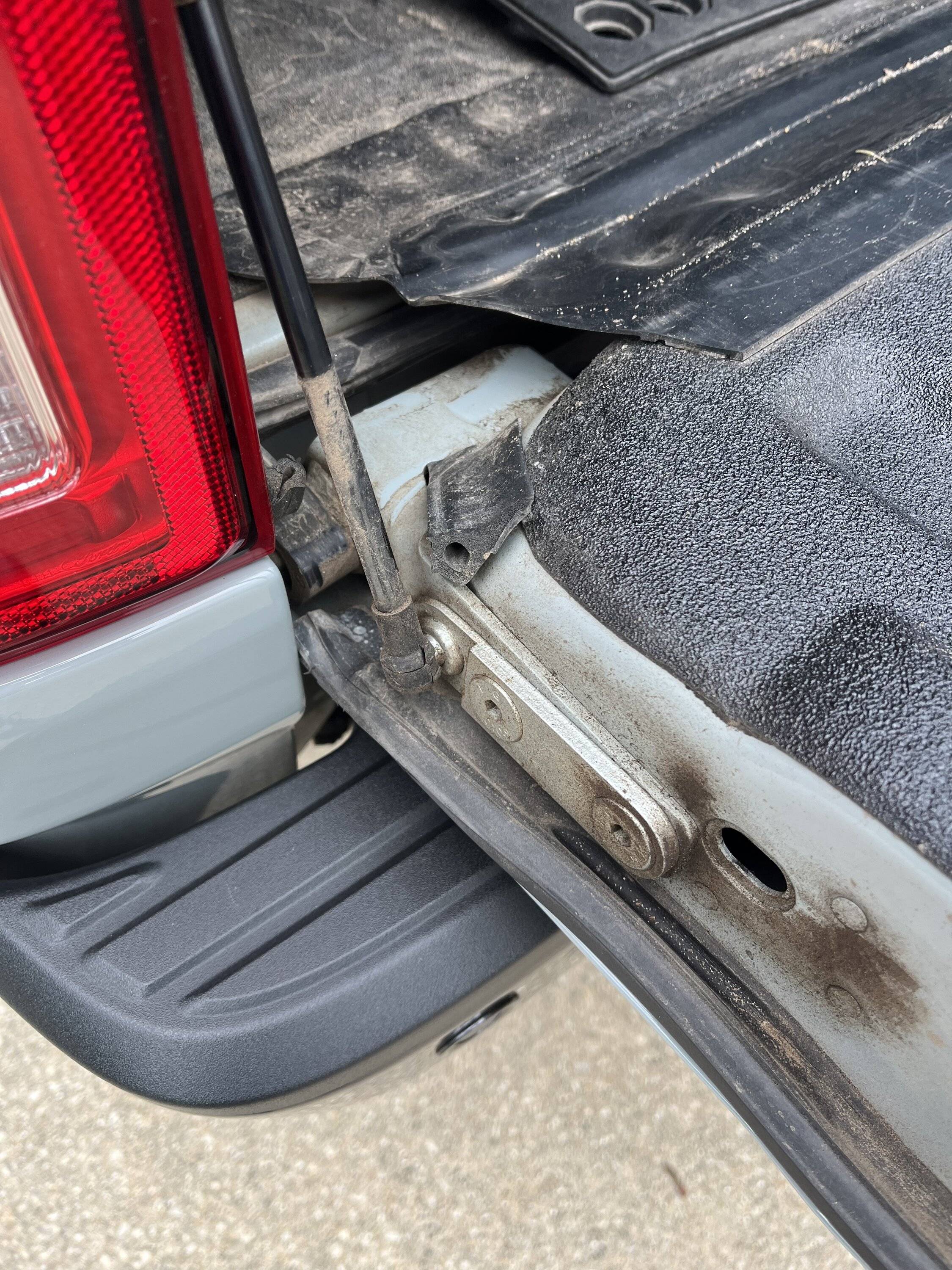

I used a couple different types to seal it up. Got them off Amazon and can look them up if interested. Does a pretty good job of keeping it out in heavy dust. I have a Truxedo low pro roll up. Also make sure you plug all the small openings at the front of the bed too.

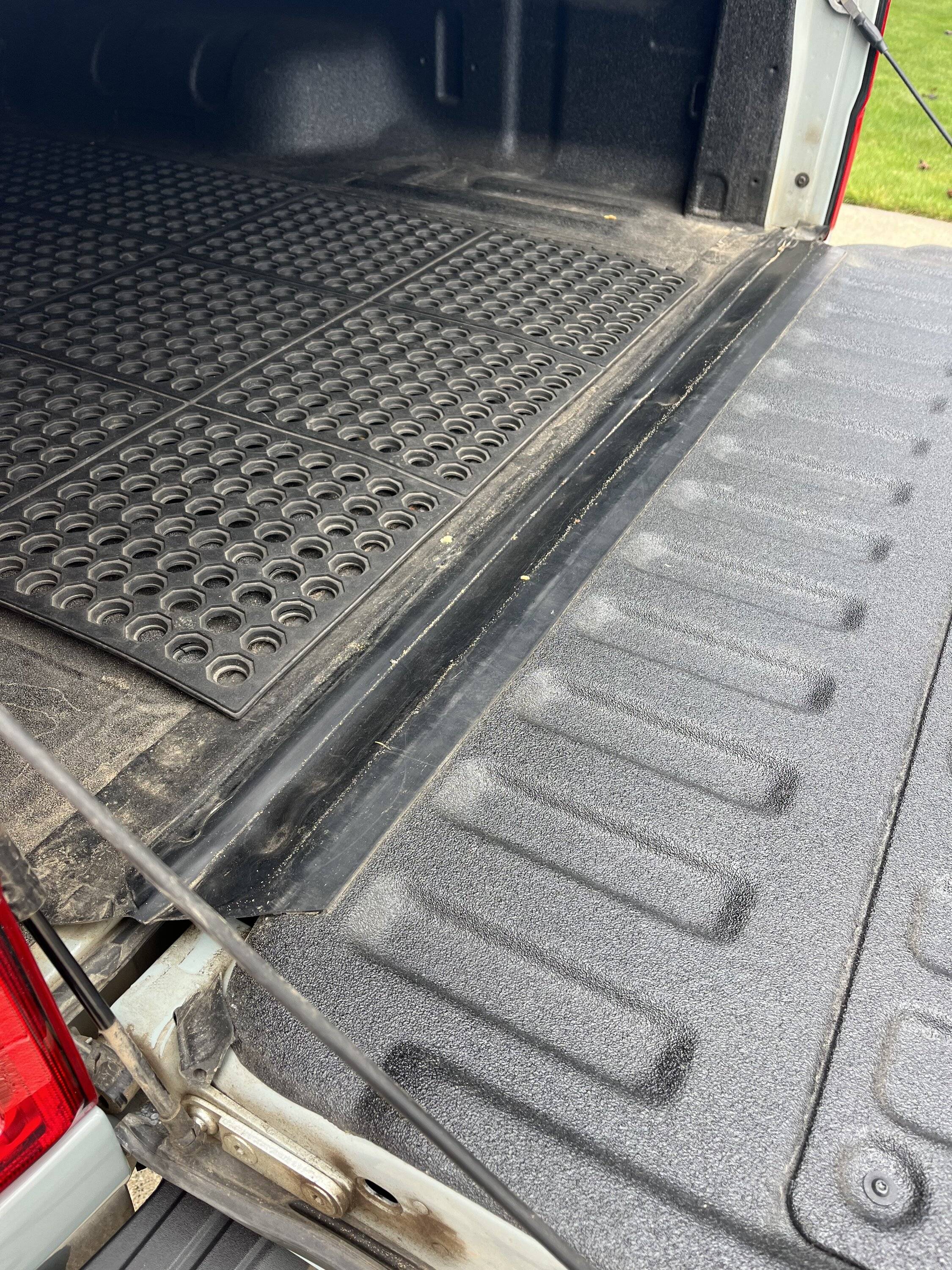

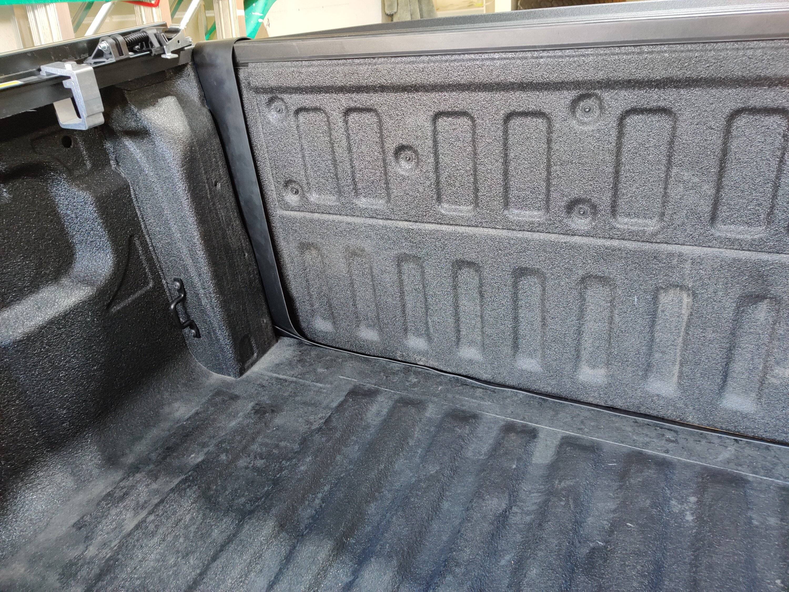

there’s a Ranger owner that left a review for the extang on Amazon saying it doesn’t seal well. Sounds like you have had a different experience?
Probably some noob that didn't put it on right or in the right places
Its not perfect, as others have stated there are other small holes in other areas of the bed
However between the moving blanket and tailgate seal it probably cut the dust down 80-90%

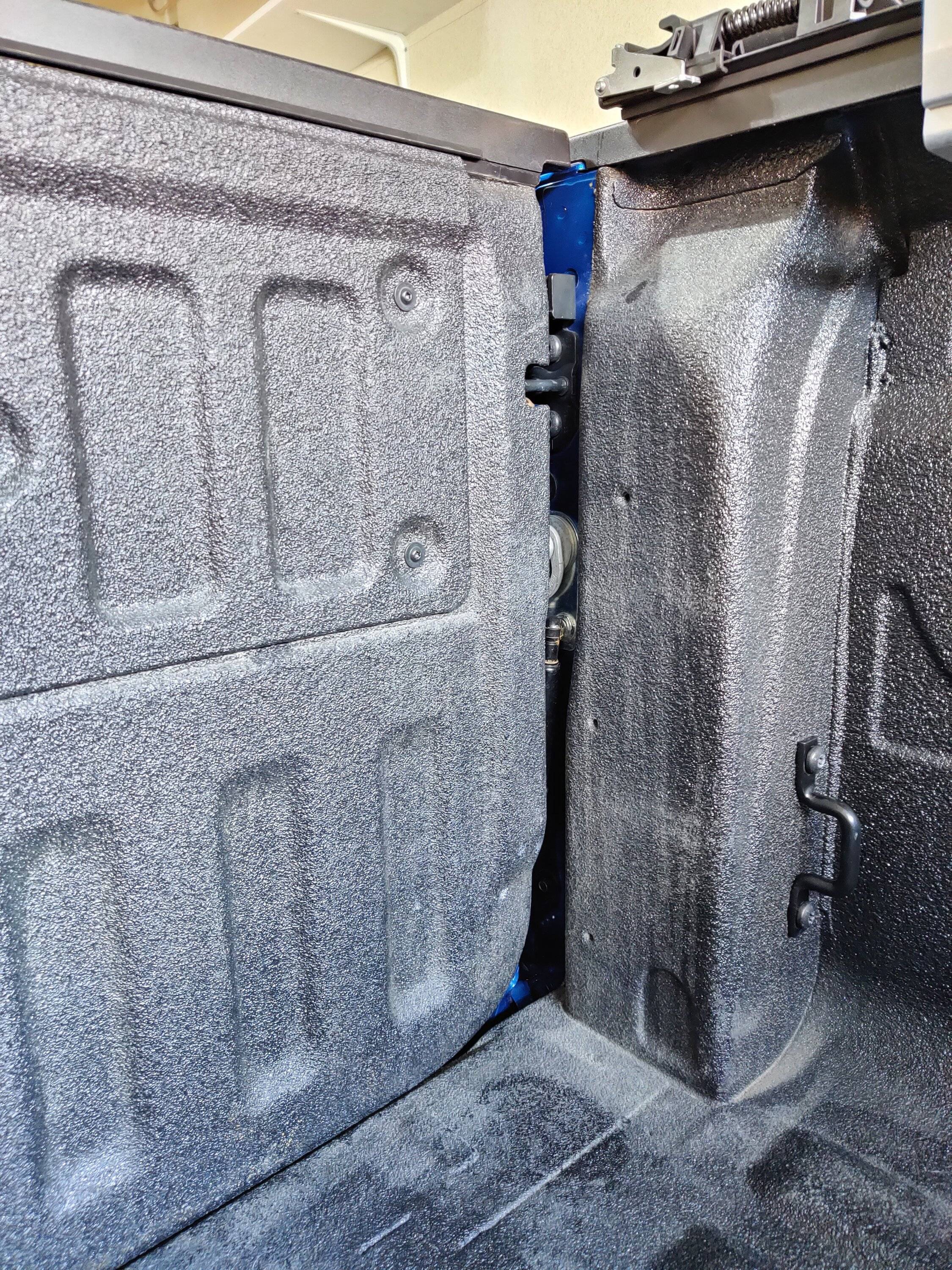

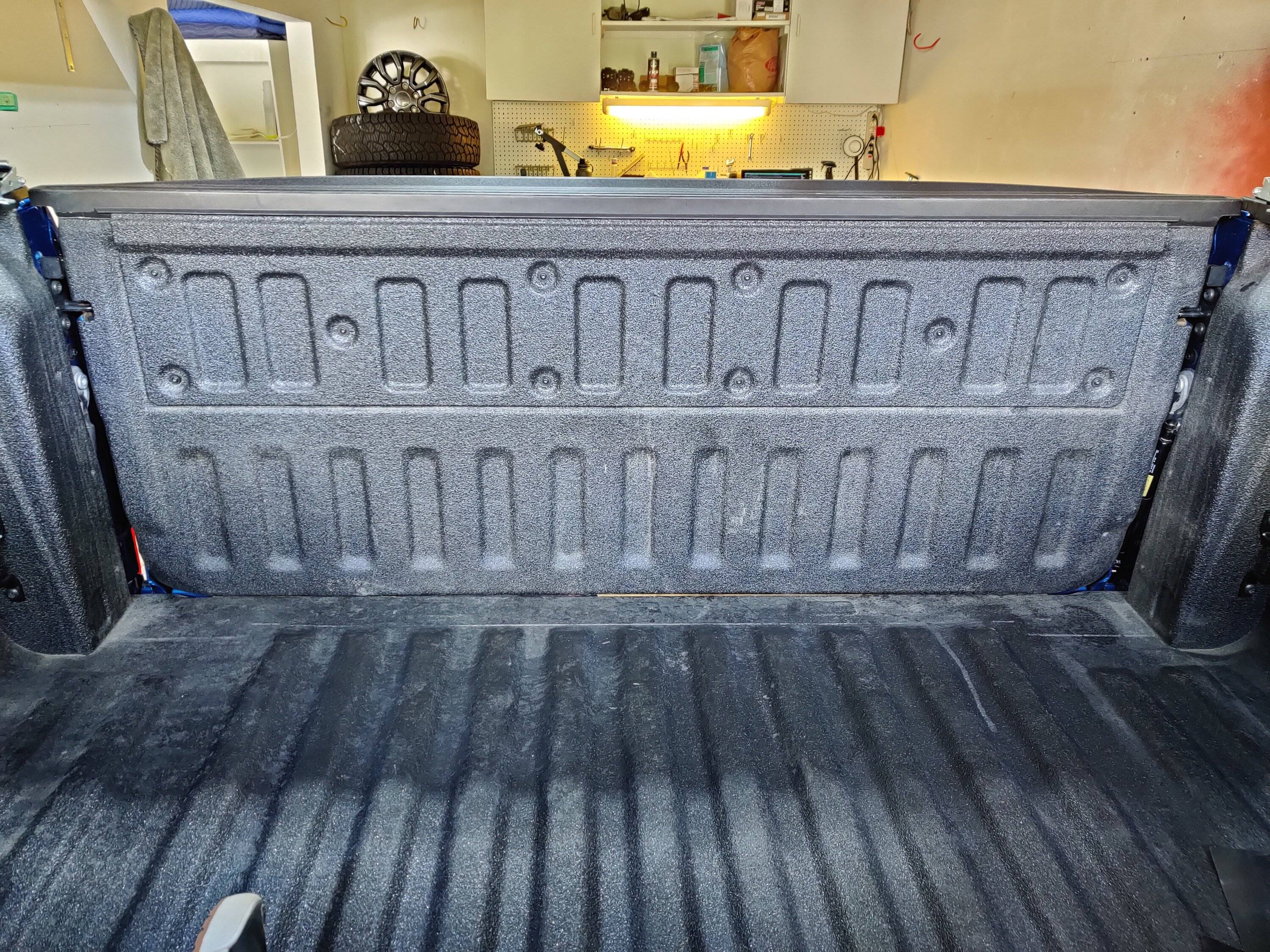

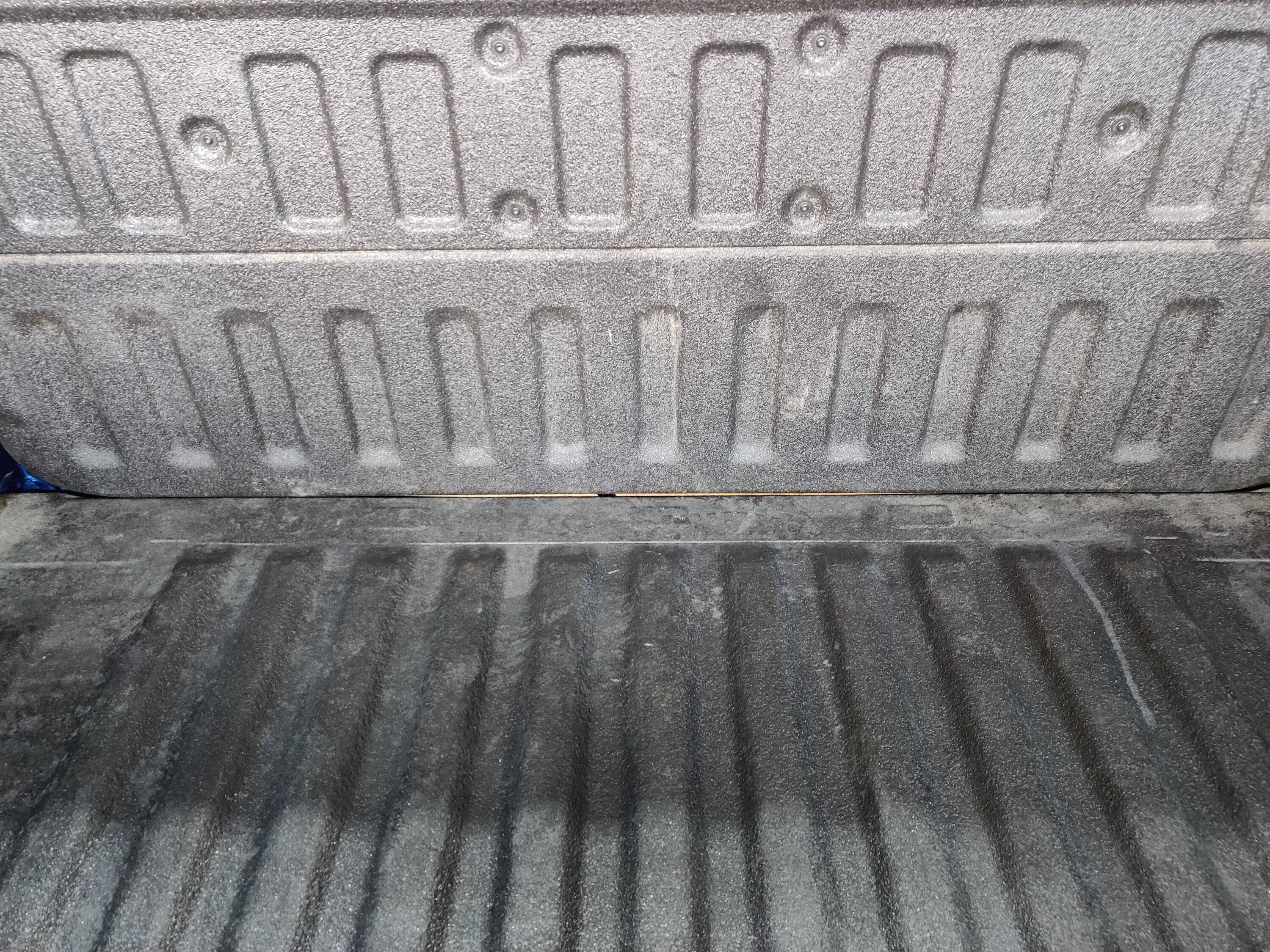

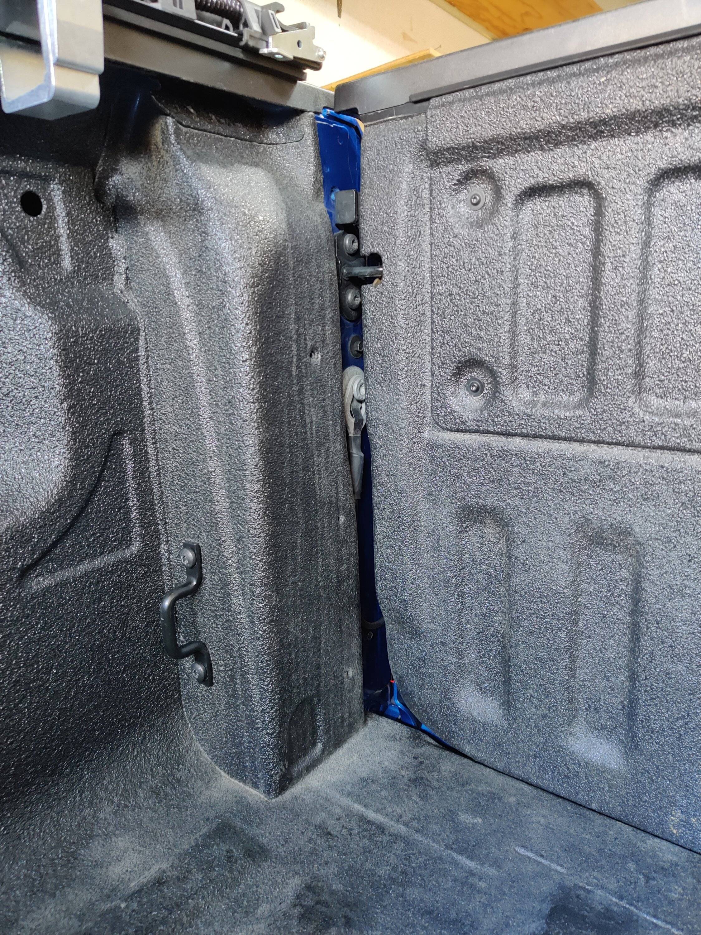

I bought and used this one, and while it helped, it's still far from perfect. If you close the tailgate and look from the bed to the outside, the gaps around the tailgate are *unreasonably* enormous. I mostly gave up on trying to solve for it, especially since I don't live in that territory anymore, but it is definitely a, still to me, unsolved problem.
