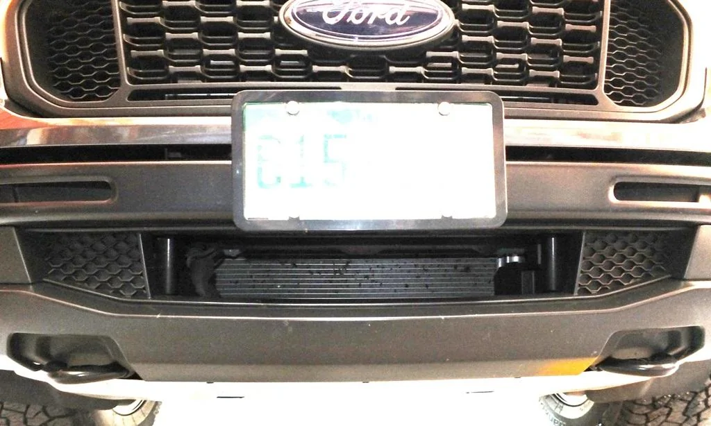

That does not look to be the radar unit, that appears to be either your radiator or intercooler (I can't quite tell which).

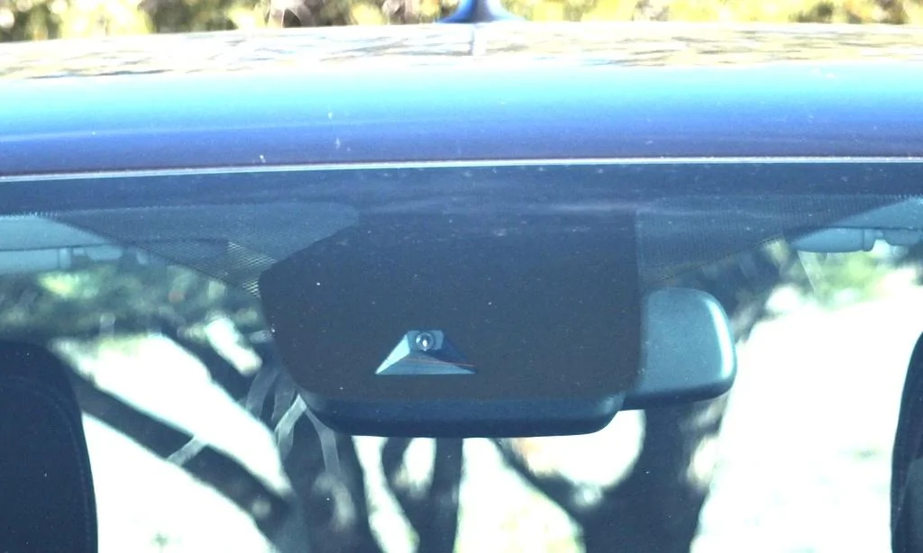

Check the front camera area of the windshield too Wipers do not sweep this area.

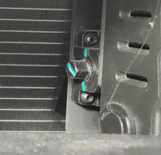

this is at the back of his radar unit....the lines arent lined up...is that normal? is that an adjustment screw?
I'm not sure what that is, but mine looks similar to this except mine has an X on the "dial" (instead of just a line). Neither of mine are lined up with the vertical blue lines.

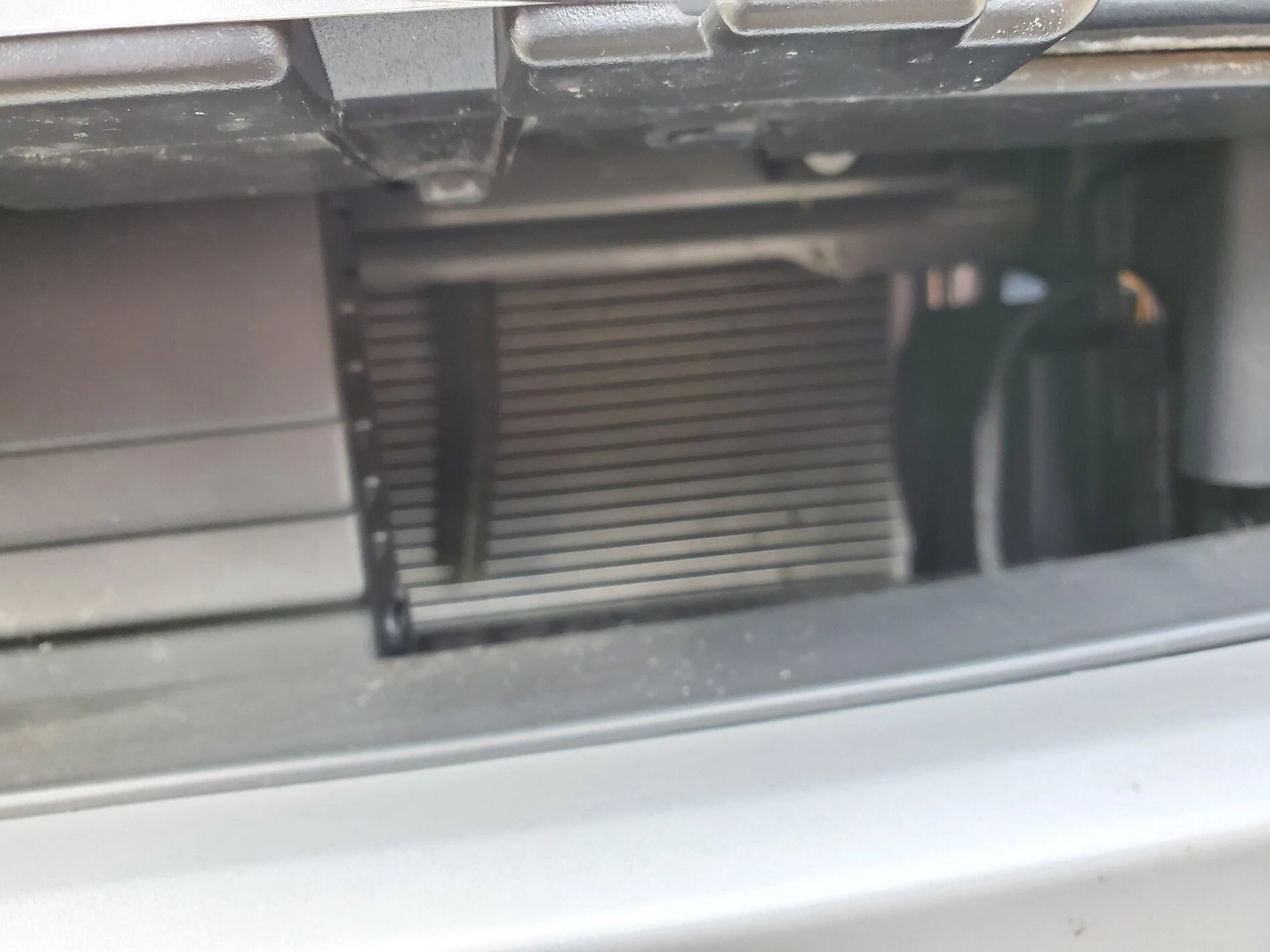

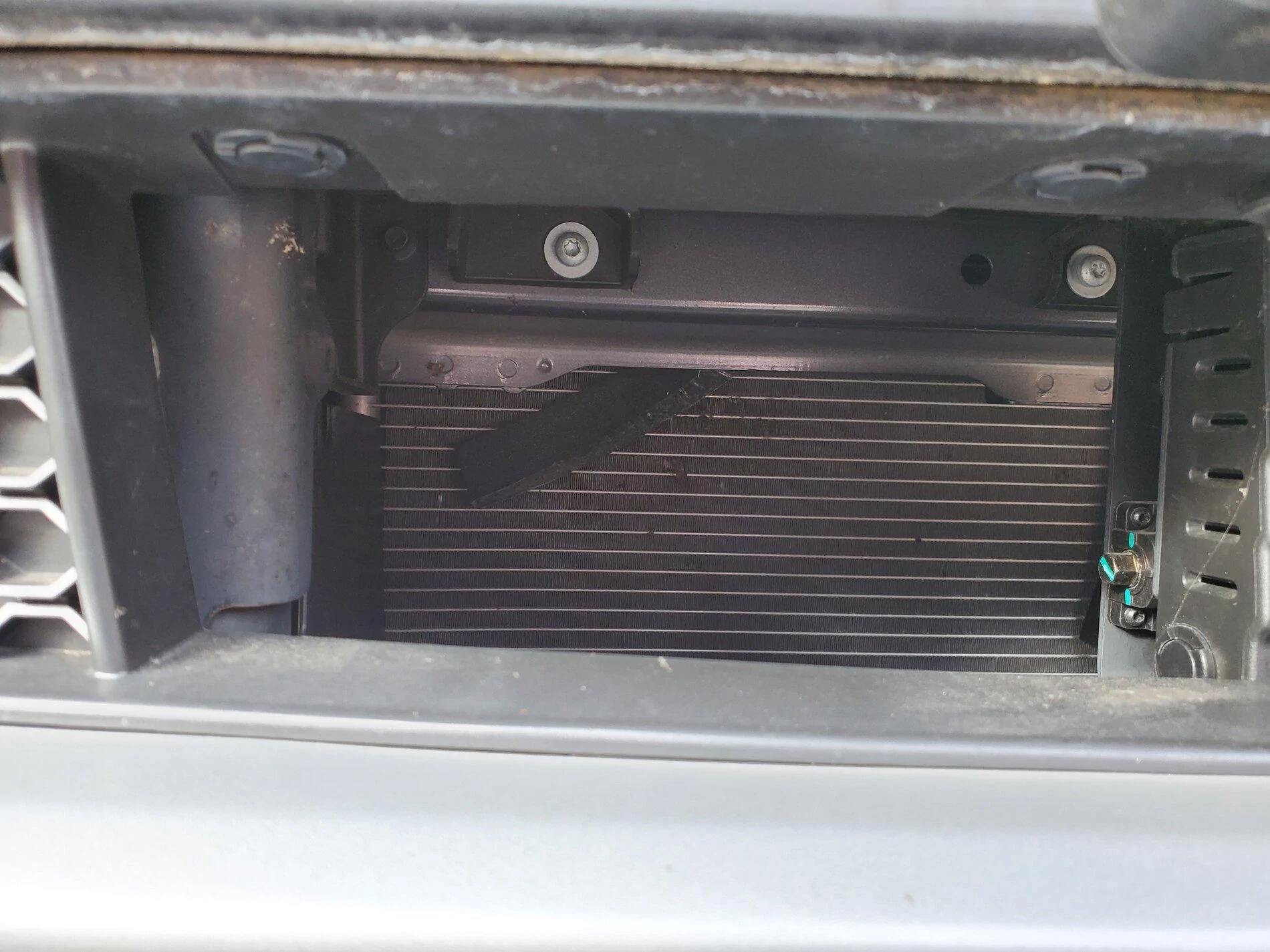

So I got on my hands and knees to see if there was anything obstructing the sensor and I found this weird foam strip hanging on both sides. It looks like the glue is no longer holding it in place. I'm wondering if that started the whole ordeal?
We have pre-collision on our XL and regular cruise cpntrol, but none of the other technology such as lane change assist, curve control, adaptive cruise control, etc.
Our Ranger has no sensors in the grill opening.
The only sensor used by the pre-collision, on our xl, is the camera behind the rear view mirror.
Therefore it seems logical that the sensors in the opening in the grille are not for the pre collision.

Don't know if this helps or not, but when I worked on radar cruise with a failed sensor, you could press and hold the cruise main switch 5 seconds and it turned off radar and it became a regular cruise control and worked. But that was other than Ford.
When I read your post the first I thought was one of the revolving scrubbers snagged the radar sensor and knocked it off alignment.
These have to be dialed in with a target to look at. It's very time consuming and the dealer could be giving you the brush off for now.
BTW, the lines are for reference when dialed in.

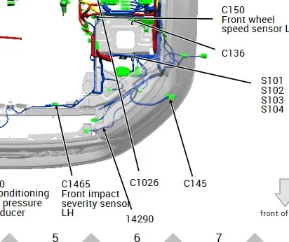

I’m in NE Pa and it’s cold! Every time I go through the car wash by the time I get home one of my front parking sensors is going off. I’m assuming it’s ice/frozen related. “Usually” it’s corrected by the next day….usually.
That is exactly what is happening to me. I live in Ottawa Canada so it gets cold here too. Had to have a front parking sensor replaced which restored operation of the the parking system but this other event still occurs after the new sensor was installed. The parking system display shows it as a front driver side obstacle. Anyone know what is happening, which connector to re-seat?

Hi Chandler,
Ford has a test called the car wash test. The vehicle must pass this test with on problems, Body, Chassis or Electrical. You vehicle exhibits a problem that the dealer must resolve...this should have never happened. We do not produce vehicles and have the customer id problems...Something is wrong. There is an electrical connector not properly seated that needs to be addressed. If I had to guess, it is the huge electrical connector behind the left headlight. There was a recall on the frame connector but it does not match your symptoms. I diagnosed and fixed mine when I found the connector behind the left headlight. I got one hand in the area and was able to tug and pull and got a resounding "click"....no problems with the sensors in the front after this.

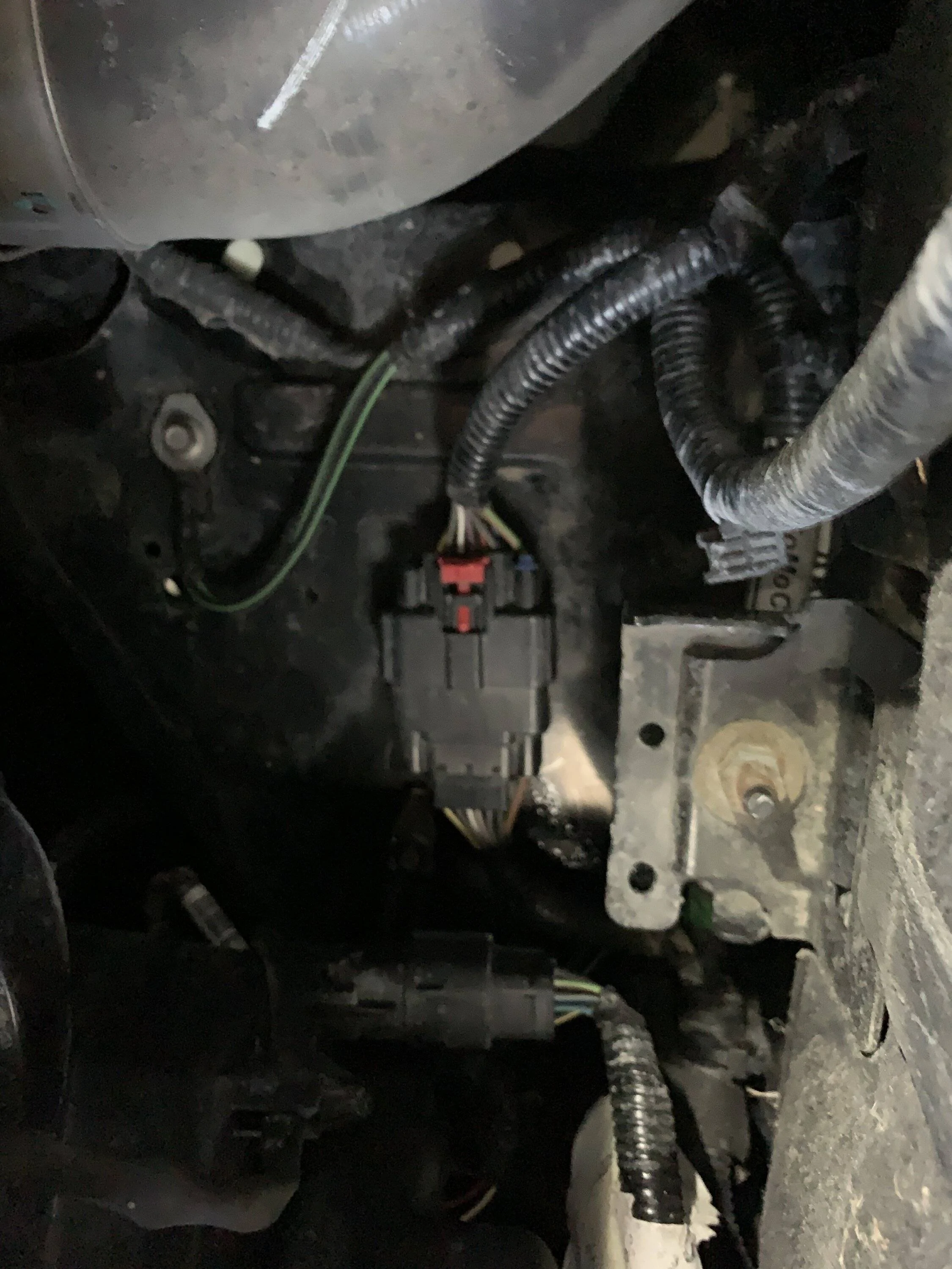

Phil, is this the connector you are referring to that you re-seated?
I get that too when it gets cold enough. The sensors aren't obstructed, but whenever I start to brake (especially at a traffic light), they start going off. The truck's in the shop for an unrelated issue, so I asked them to have a look while they've got it on the lift, that way I don't have to crawl around on the frozen driveway. I'll let you know what they say.

You should be looking for C145 (Inline Connector)
The Front Parking sensors are wired
Both Inner (Left/Right) - Share the same circuit
Both Outer (Left/Right) - Share the same circuit
Both circuits pass through the Inline Connector C145
You may want to ensure all 4 sensors are CLEAN, any frost/ice/snow or even wax will possibly fault the sensor.
It should be throwing a code, what code is it triggering?
Would you be willing to share a picture of the connector and where it is located so that I can find it please. All 4 sensors were wiped dry after the car wash. Thanks!
