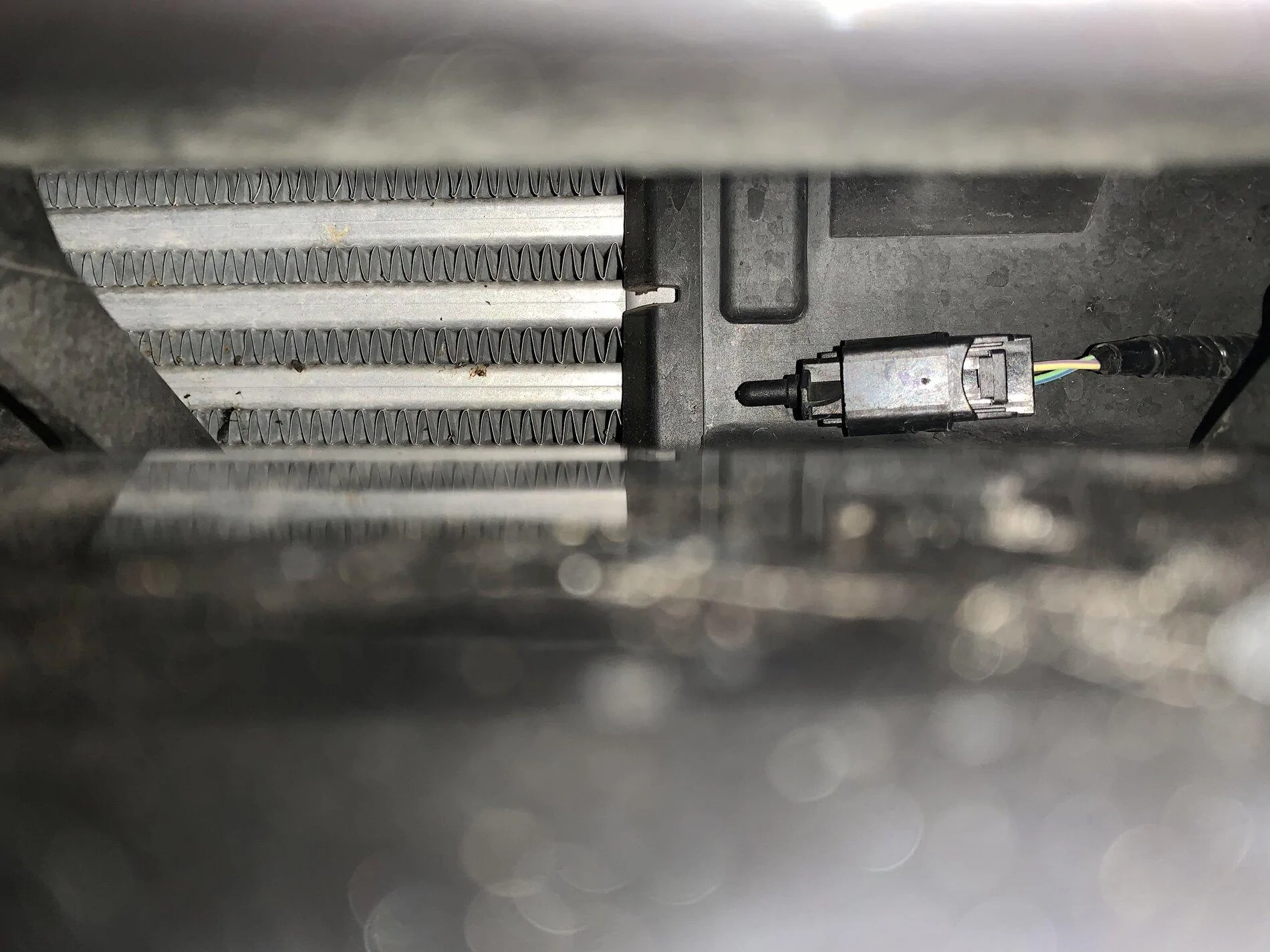

Try this. When facing the blue Ford oval badge on the grill. Measure down 7.5 inches to the gap between the grill and bumper, shine a flashlight in the crack and measure 13 inches to the right. You should see this sensor, is it clean and unobstructed ? You can access it by hand from the opening in the bumper. I am no mechanic but think I cleaned it too when I had my issue.
Also put the tire pressure at 33 to 34 for sure. 42 is ridiculous.
Not sure what sensor that is, but if I had to guess, I would say external air temp. Not sure what it would have to do with the problem. You did say you looked for things that changed when things went wrong.
You might be right, I had googled radar sensors and cleaned around the grill area, looked for loose connections, obstructions and scrubbed my windshield inside and out. The problem went away, but back to my original thought it was strange that both events were right after tire replacement. When my tire went way down to 15 to 20 psi (nails) on my way to the tire store, it might have disabled the system. Took a day or so to right itself. The second time all four tires and sensors came off my old wheels and were put on my new wheels. Same thing, took a day to right itself. The OP like me is just trying everything to fix it. Since OP is at 42 PSI, I am just wondering if one tire is off and triggering a similar event. I am not a mechanic so just guessing.
