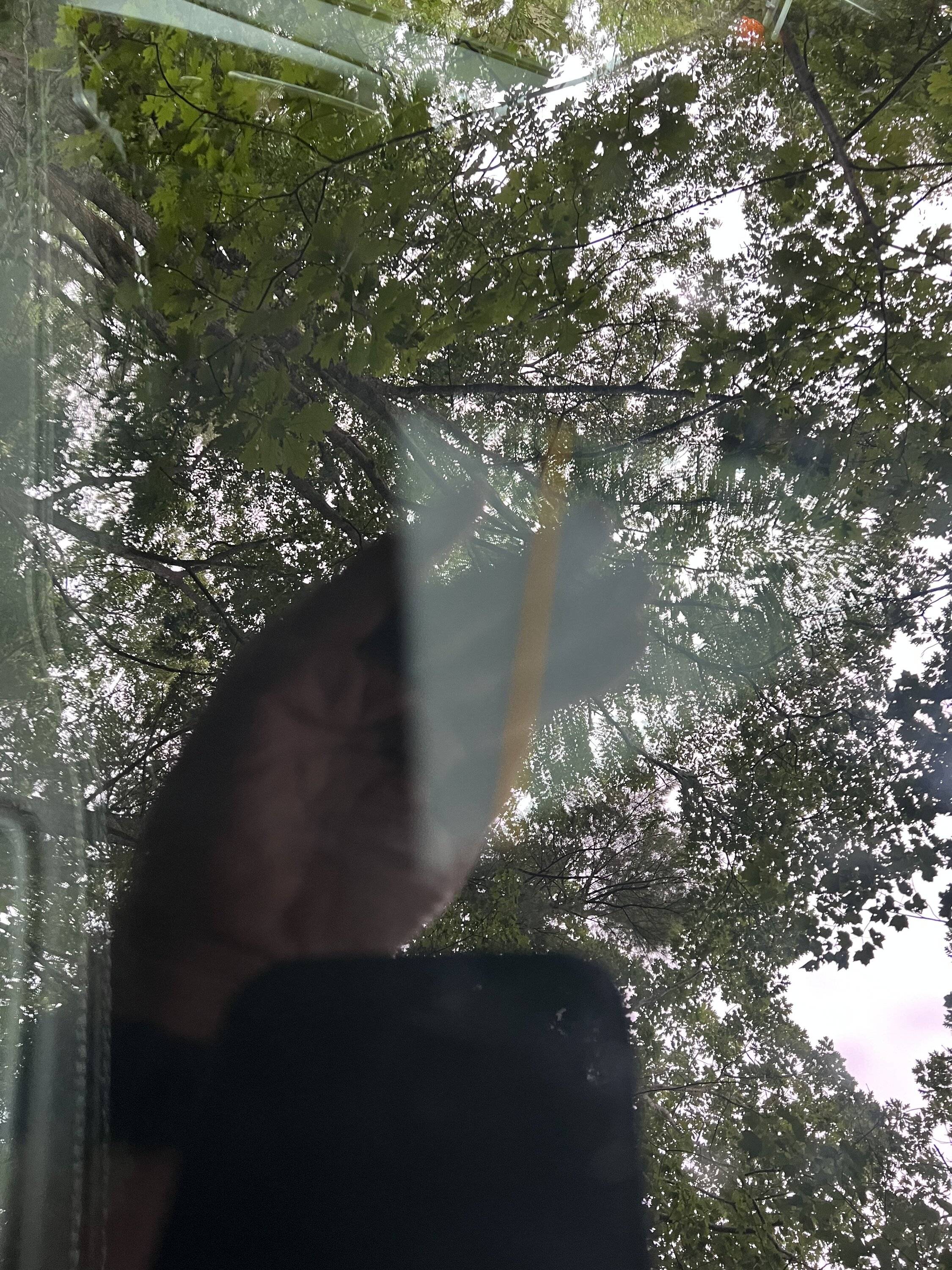

Yes, I’m starting a new thread. I did read 2 other threads, but I think I found the problem. My question is, how did this happen and is it the likely culprit?
On ours (1.5 weeks in hand) Lariat Tremor with adaptive cruise, there is what appears to be a pine needle in the camera space between the camera and the windshield. How on earth can this happen ?
I’m hesitant to try popping covers off and removing. But I’m also hesitant to rely on a dealer to take a look for themselves especially when I bought the truck 6 hours away.

seriously, theres other threads on it. it's normal. its supposed to be there.
some say its a defrost element, but its for the camera calibration
Thanks. I didn’t see mention of that in the 2 other threads.

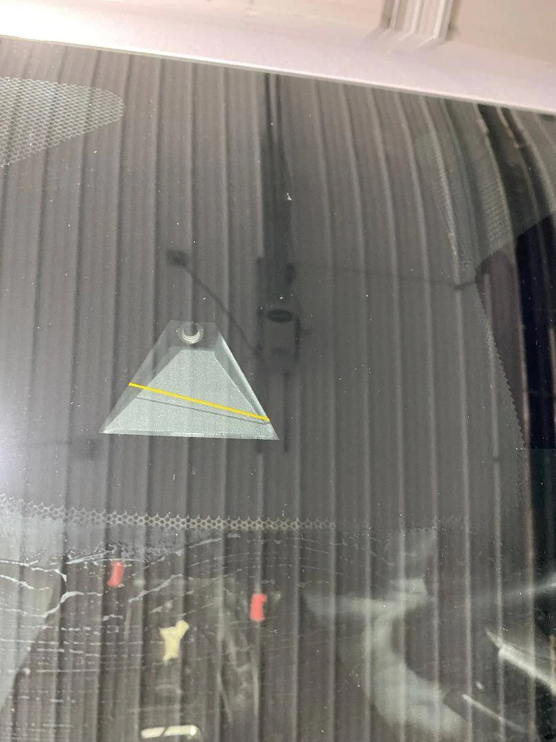

There's a thin orange (?) line on the camera lens I assume it give the camera a reference point. That doesn't look like what I've seen.

The "pine needle" is a heating element I believe. We all have one.
Kind of the the defroster you have on your rear window.

The pine needle is for the camera calibration. The camera works hand in hand with the radar to provide adaptive cruise, pre collision assist, and lane departure warning/assist.

You had my curiosity going so I went an looked at mine. It's probably the pic but mine is thinner an more yellow. I only got those alerts when the windshield would frost up.
I made this comment before, and I don't think this area has anything to do with the OP's issue, but can anyone confirm if it's a heating element to defrost the camera area? Or is it some sort of calibration element as some have mentioned? (or maybe both) It's been discussed on the forum before and I think the consensus was heating element for defrosting the area. I haven't heard of calibration element until this thread.
