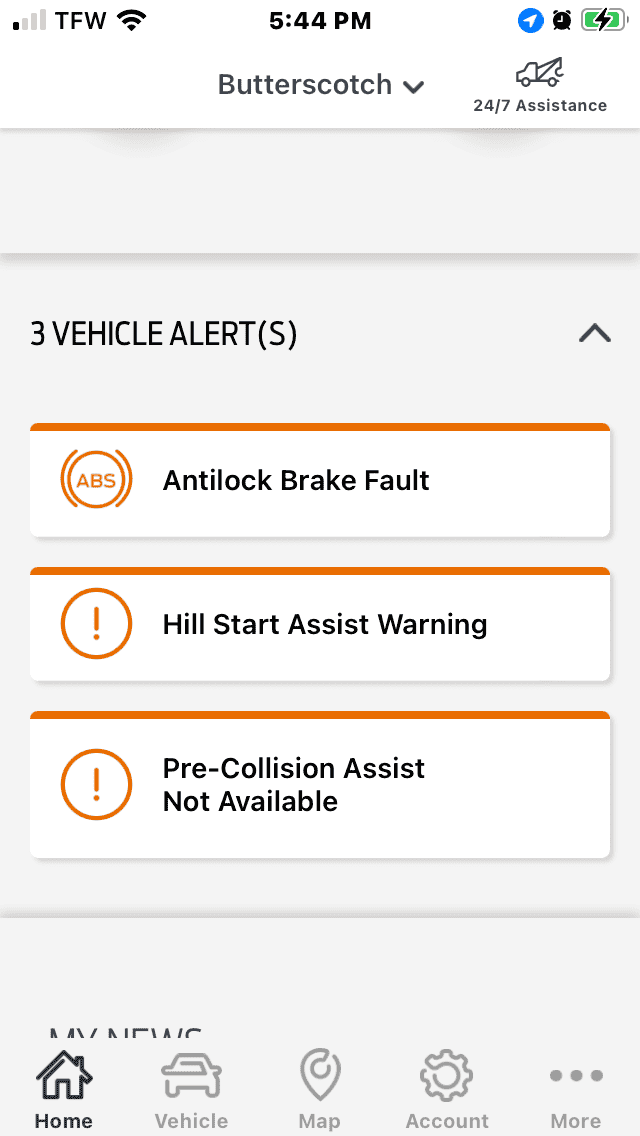

I had this come up this evening and I was not on a hill. Nor do I drive with both feet. Freaked me out. When my husband gets home, I’m going to get him to disconnect the battery & see if that corrects it. I don’t want to electrocute myself.:rolleyes: I wiped off the sensors at the front and back of my Ranger. I used my parking brake the other day for the first time. I was parked slightly uphill. I blame it on that dadgummit!:oops: Anyway, I’ll let ya’ll know what happens. My first real issue (hopefully not really an issue). May have to take it in. We’ll see.
Disconnecting the battery for 20 min did not work. It does great for about 5-6 miles, then all the alarms go off. The brakes do not lock up. The truck drives perfectly fine. Going to take it in tomorrow & my son will check for codes.

It showed a code C1A99. Son said it had do with Brake Fluid Pressure sensor and ABS sensor showing where brakes were being applied when they weren’t…or something like that. He updated something and said it re-calibrated the sensors…or something like that. Long story short…it’s fixed! Thank The Lord!!! :turkey:

The brake fluid pressure sensor in the abs hydraulic control unit was sensing pressure and brake being applied when bpp break pedal position switch was not being pressed causing a correlation code between the 2 sensors. Reprogrammed abs module and cleared all codes. Code c1a99
This is the official report from my son who is a mechanic & checked out my Ranger. For anyone else who may have this problem.:)
