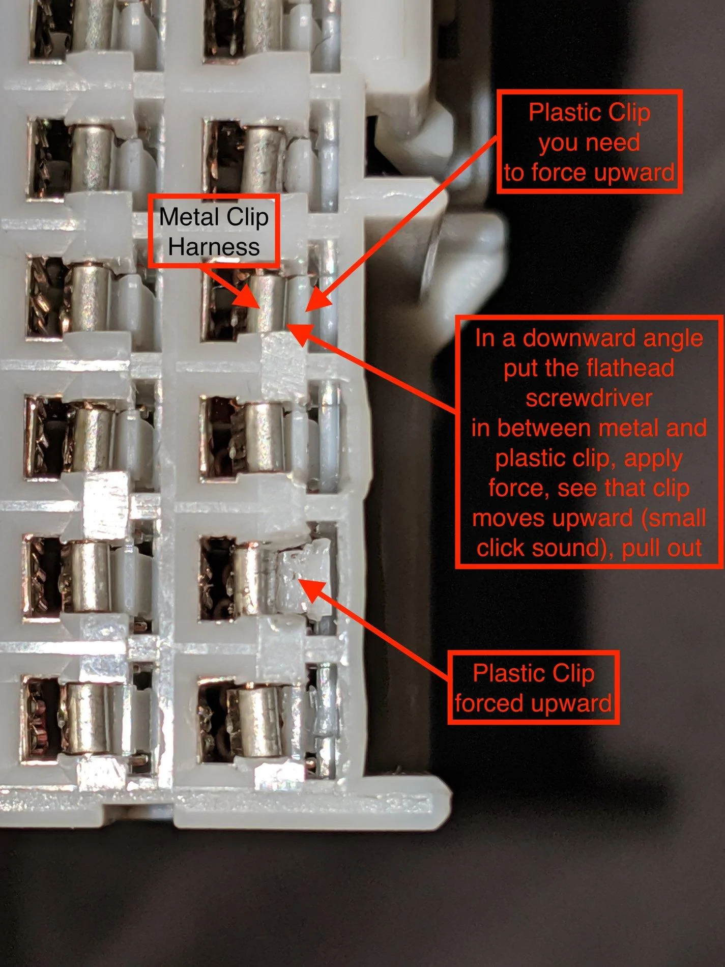

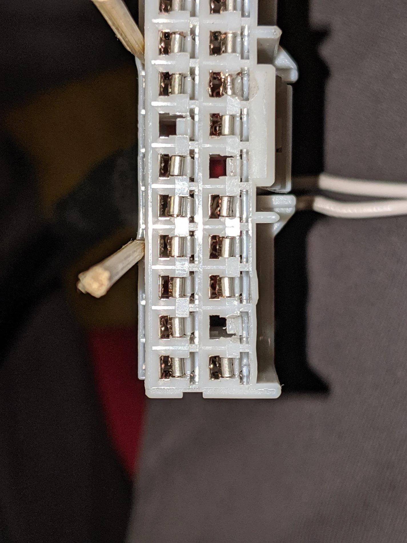

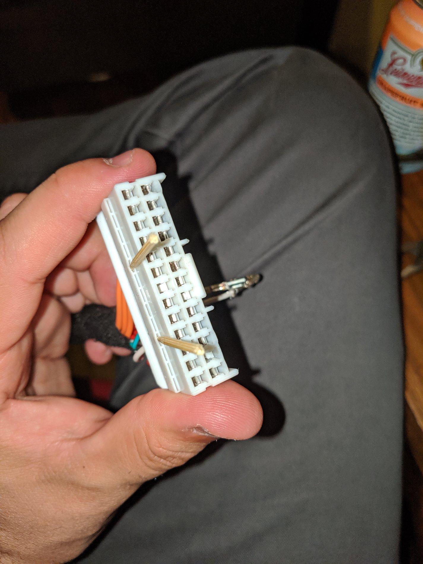

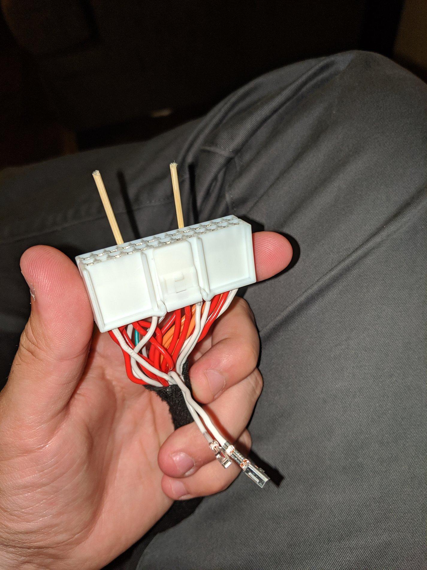

In case you guys who are trying to figure it out before giving up need some more help. I have attached a few images that detail what is going on here. It takes a few tries to get the wire to pull out some times as the clip keeps snapping down. I used the other guys two broken toothpick method to hold the bottom clip open as well.
Yet to verify full functionality.
