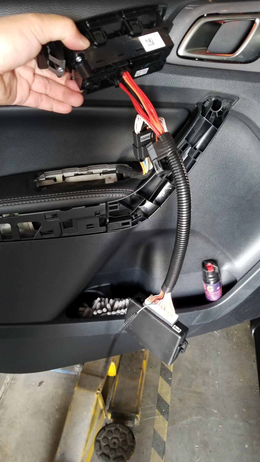

Okay, I did the install tonight. The install warrants some discussion -- it's not a 20 minute job. Some thought needs to go into it. But that's for another time.
So what functions do we have that is verified for the Ranger? The green is tested and working. Red is for issues.
I did the install; tested that all windows behaved properly in relation to their designated button. <<< WORKS
1. one touch operation on all windows. Quick press rolls up/down all the way. <<< WORKS.
2. Auto window up. When you exit the car with the windows ajar/rolled down, pressing the lock button should trigger the auto roll up. << DOES NOT WORK
  • HOWEVER, when I press unlock to enter the car, the windows rolls up. This function seems to be backwards.
3. unlock + unlock + unlock: rolls all windows down. WAS WORKING; then now only driver and passenger rolls down.
  • And after a minute of inactivity, it's supposed to auto-lock the car and roll up the windows. <<< DOES NOT WORK
4. Have not tried the ventilation function <<< Unknown

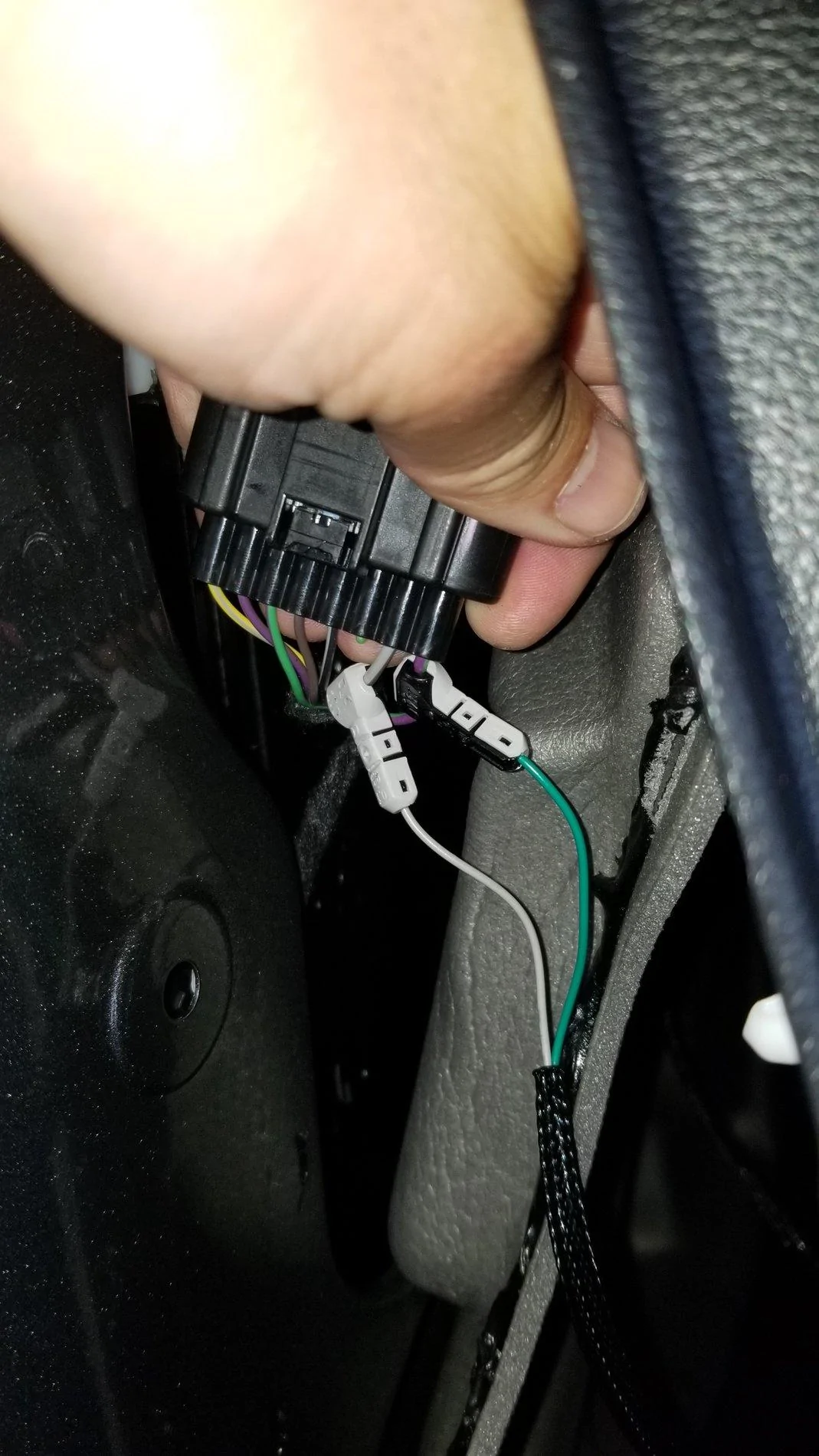

As I posted in my build thread I found a one touch open/ close module for all windows and remote open, close and vent. It's plug in module that goes between the switch and harness and 2 wires tapped into the lock/latch harness. The install can be done without removing the door panel completely. Same procedure I outlined in my one touch down module on the passenger side with pictures except you don't have to pull the whole thing off. Just the bottom enough to access the latch harness and mount the module. I attached the module to the inside of the door panel with 2 way tape so it won't rattle around. Chime in here if you're interested in the module. Comes complete with instructions.
Link to the video of them in action : RCMUSTANG's Magnetic FX4
Pricing will depend on how many units ordered at the same time plus shipping to you. Regular price is around $105 USD plus shipping. I'm trying to get the pricing around $80 + shipping.

I need to trouble shoot with him that the 2 lock wires are connected to the right place.

I mean physical location of the plug. Maybe it will be obvious once I get in the door?
You're going to have to peel back the sound/weather damping held onto the door panel by a black/sticky glue. I believe it called butyl glue. you can reuse this gummy glue. The wiring resides near the door latch assembly.
It's not hard; but there are some considerations. Two things I suggest:
1. take your time and remove the door panel completely.
2. You're going to have to give some thought on where to store the relay box; and how to keep it from rattling -- longterm.
