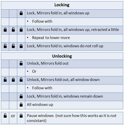

micI9... great tool... please elaborate on these 2:
They seem the same... or is that press lock once, pause and press it again to get the windows to go up?? Thanks.
I updated the table, let me know if it helps clarify
And I can say after 6-7 months of use I have no regrets. Love the auto down in the summer.
