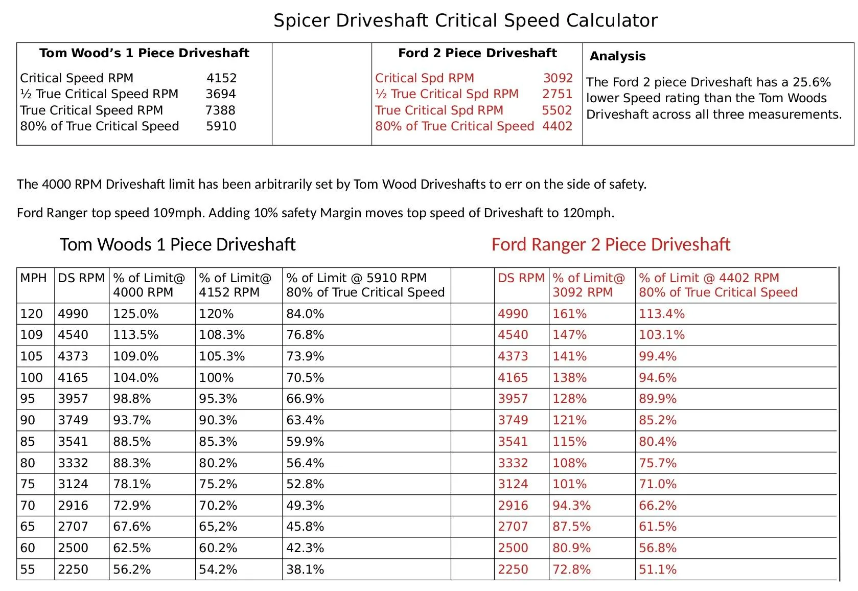

I just discovered the top speed of the Ranger to be 109mph. I created a Chart using the Spicer Driveshaft Critical Speed Calculator comparing the Tom Woods driveshaft with 3 RPM limits with speeds up to 120mph - this is top speed plus 10%. It has been mentioned on several occasions that Ford must build Driveshaft to exceed the top speed of the truck by 10%-15%.
  • 4000 rpm - The limit that was set by Tom Woods Driveshaft to insure a safety margin
  • 4152 rpm - the "Critical Speed" Result of the Spicer Calculator
  • 5910 rpm - 50% of "True Critical Speed" results doubled, with 20% removed for a safety margin. The calculator reported 3694 rpm.
I then ran the calculator with the Ford 2 Piece Driveshaft specs using the identical parameters and process.
  • 3092 rpm - the "Critical Speed" Result of the Spicer Calculator
  • 4402 rpm - 50% of "True Critical Speed" results doubled, with 20% removed for a safety margin. The calculator reported 2751 rpm.
These speeds were all derived from the Spicer Calculator, and both driveshafts appeared not to meet the criteria that Phil reported that Ford uses to determine safety. When I calculated using the 1/2 True critical speed result, the Tom Woods Driveshaft was at 84% of True critical speed of 120 mph with a 20% safety margin.
The Ford Driveshaft was at 113% at 120mph and at 99.4% at 105mph with a 20% safety margin. The Ford driveshaft consists if two parts, a 2.5" front shaft and a 3.5" rear shaft. I selected a 3" shaft as Spicer did not allow for entering each section separately. I also selected 1330 u-joints.
The Tom Wood Driveshaft was 4" with 1350 u-joints. Both 60" long (this may be a little short, but it was short for both driveshafts.)
The Stock driveshaft under performed the Tom Woods driveshaft by 25.6% according to the Spicer calculator.
Please double check my math. The chart below shows the details. I do not claim expertise in this area, I simply used the tool to derive data that is relative.... Even if the calculator is flawed, the results are relative. The same measurement criteria was used on both driveshafts, According to Spicer the Tom Woods Driveshaft is a more robust product.
For the record, my Ford 2 piece driveshaft was manufactured by Spicer.

Fitzmotor
Gold Sponsor
May 6, 2021
1,388
5,835
Saugus
Retired from Honda Racing.
That's a lot of work to calculate all of that data, if those numbers are correct, that makes me want to replace the Ford shaft.
I only have a vibration when I have weight in the bed, it vibrated unloaded before I put in pinon shims, I might have already bought a one piece shaft but was concerned about about Wood's not recommending their shaft for higher speeds.
If anybody, or especially Shaun pops in here and validates this data that would be really cool.
TJC, thank you very much!!
- T
This makes sense considering the truck is factory speed limited to 110.
Those folks with tuners that disable this governor might wanna take note.
