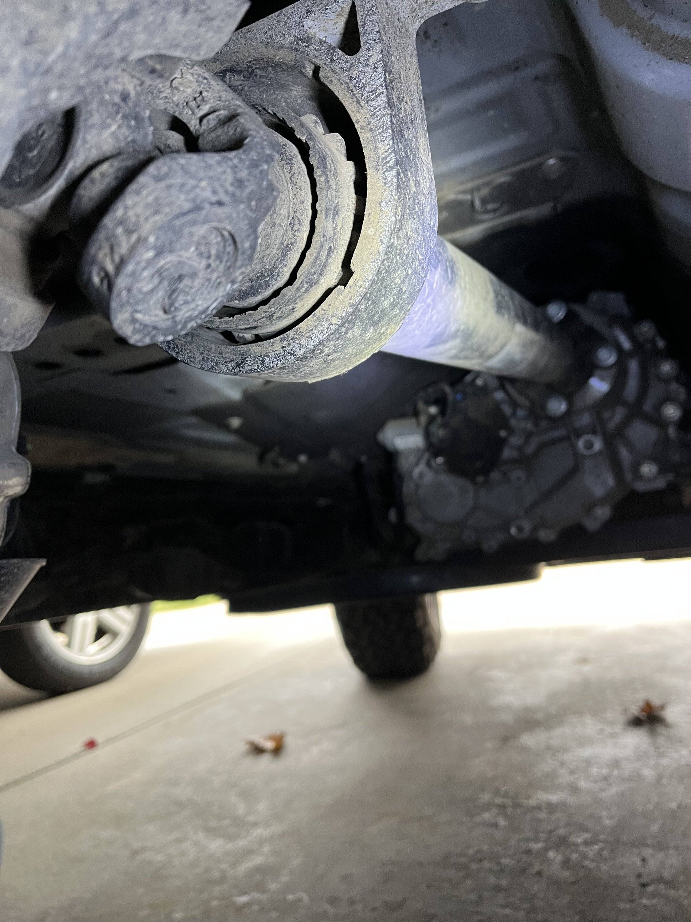

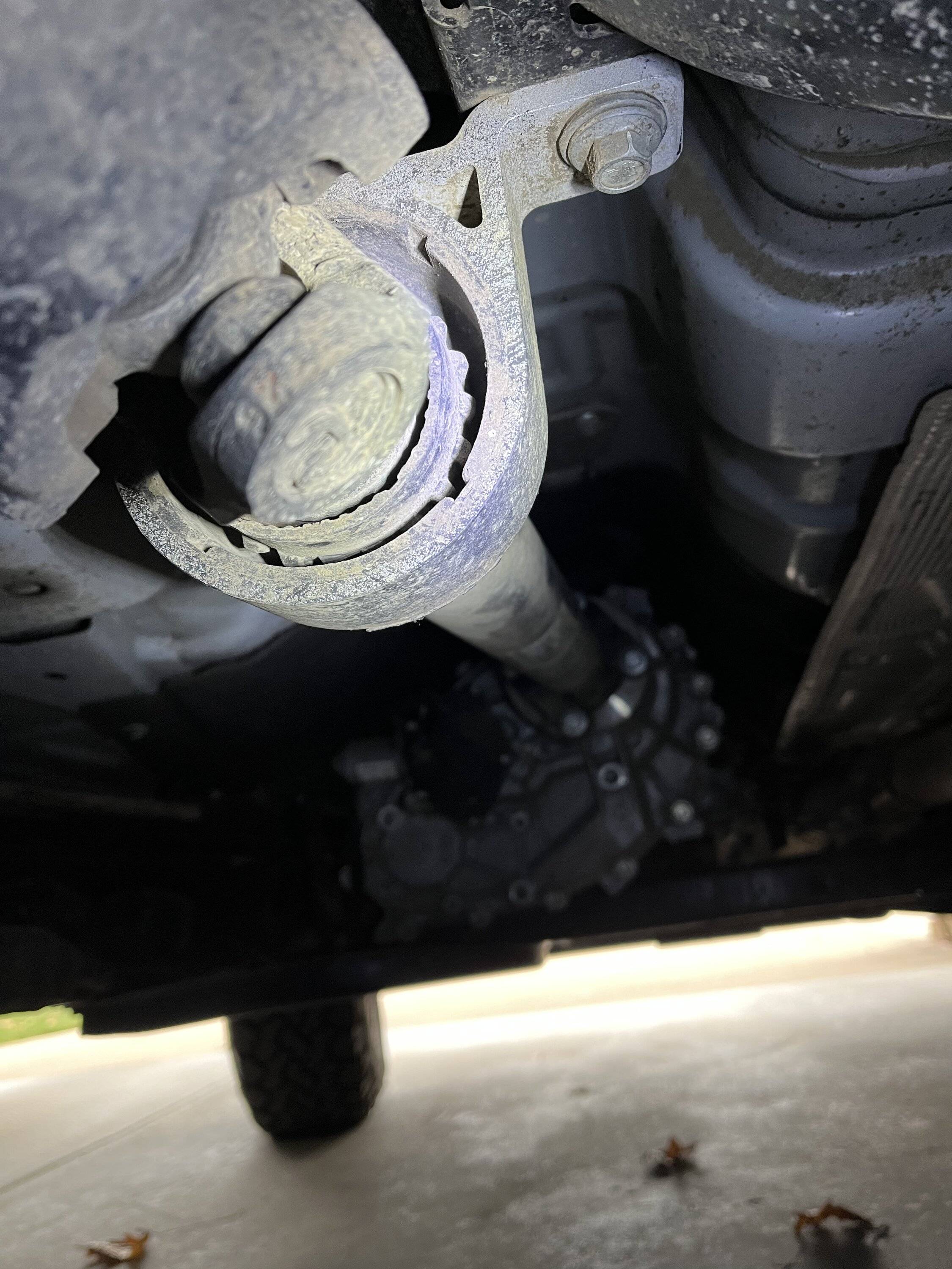

Mounting tabs for carrier bearing on cross member welded at wrong angle? I’ve been laying under my truck for 15 minutes looking at your pics and my truck and trying to spot anything.
You have an iphone? You can see what degree you DS is on either end if the carrier bearing and I can check mine
Surprisingly both ends of mine were 10 degrees. I assumed they would be at two different angles given the pivot point in the center.

I think the mystery of the off-centered stock bushings is a simple one to solve. The rubber is soft, barely firm enough to hold the shaft in place in the first place. So if it is just a teeny bit softer or more broken-in in one section, the shaft is going to naturally come to rest off-center, favoring the soft spot. That and as the shaft is under torque it is trying to straighten itself out or even move to the side. That's really I think the underlying principal behind the shudder in the first place, some of the torsional force on the shaft gets directed sideways as radial force due to the geometry of the shaft. Shaft pushes sideways against the bearing as it rotates, twice or so per revolution, in an elliptical manner, and viola you have a shudder. Anyways, when your truck is in park there is still torque on the shaft, torque which is keeping the truck from rolling away. That is enough to put some radial force on that bearing and push the shaft a little off center. An interesting experiment would be to chock your wheels, put the truck in neutral to unload the torsional load on the shaft, and then look to see if it sits more centered or not.
Wheels chocked, truck in neutral and driveshaft relaxed ( plenty of rotational movement).
No change, exactly the same. Can push drive shaft up almost 3/8 of an inch by hand.
