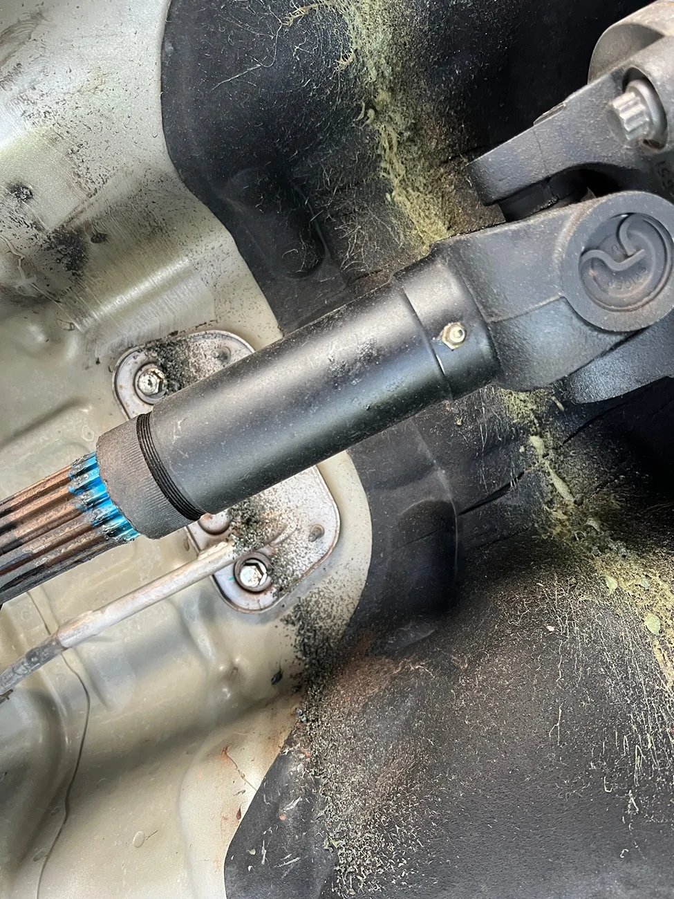

My truck has never run smoother, even at 100mph. And I never go that fast, but I did to test it. It was smooth as silk going up and coming down. My Ford driveshaft had the shakes below 25mph, and severe shakes above 70-75. Life threatening, lose control scary shakes, until speeds dropped to 60. It only happened once and I refused to let it happen again. I-95 heading north from SC.
I believe it to be a resonate frequency instance, once it started, it progressively reinforced itself.
I did not trust the truck above 60mph after that, and found Tom Woods. All better now.

You know how a truck with front end loose from wear (tie rods, etc.) behaves when you accelerate, and the front end begins to shake violently... almost out of control as the wheels start to jump in different directions until you slow down. It is down right scary as the truck jumps out of control.
This is exactly what I felt at 75mph on I-95! The entire truck was violently shaking/bucking! I came off the throttle, too afraid to apply the brakes... it subsided by 60mph, but for 30 seconds I felt like I didn't have control.... and I-95 typically has very heavy fast moving traffic. I didn't drive above 60mph until I replaced the driveshaft.
Smooth as silk since.
